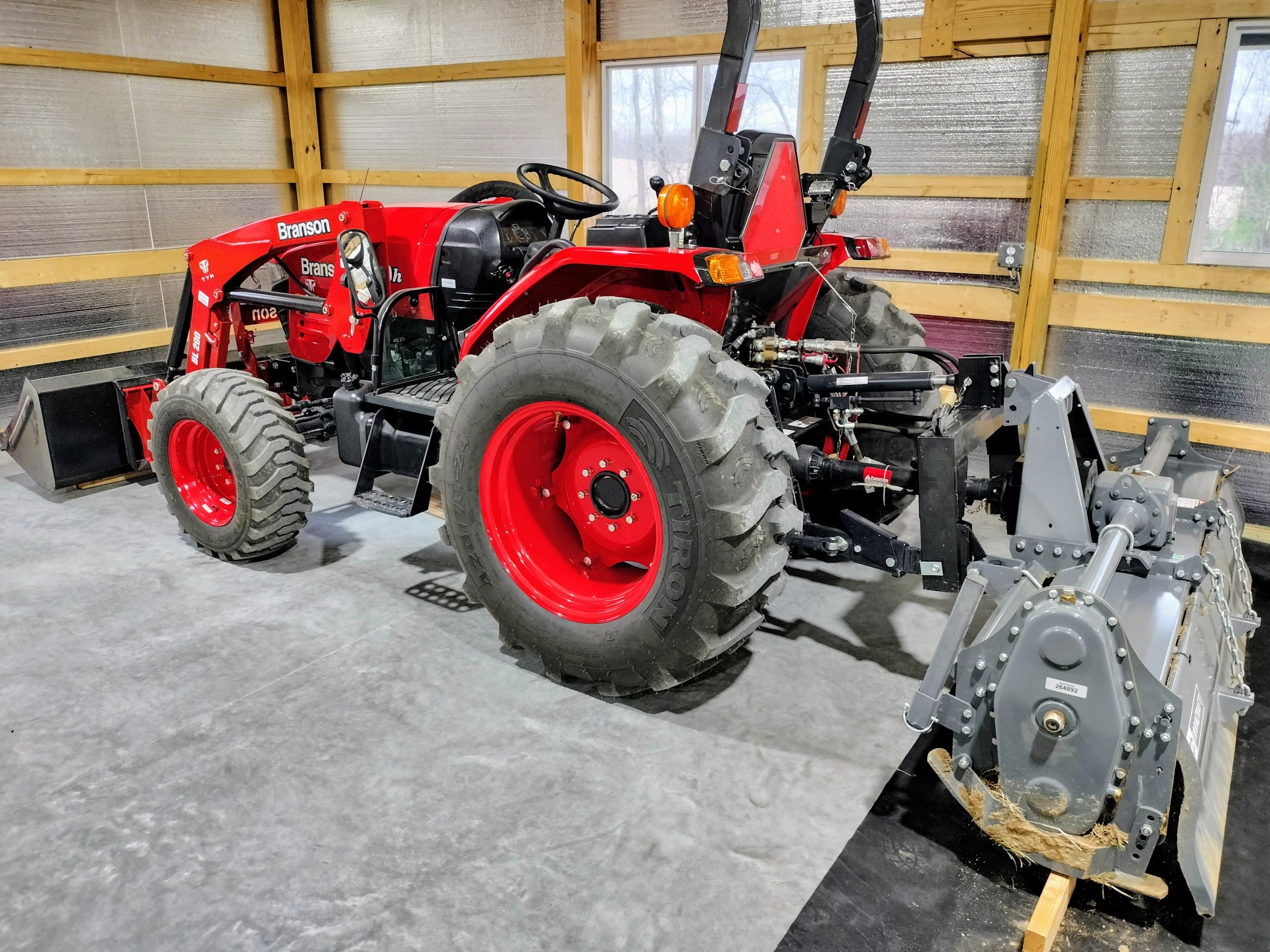

That is a ton of corrosion. I'd be upset too. My little South Korean tractor sits in my barn, and after two years, has not a speck of corrosion.
