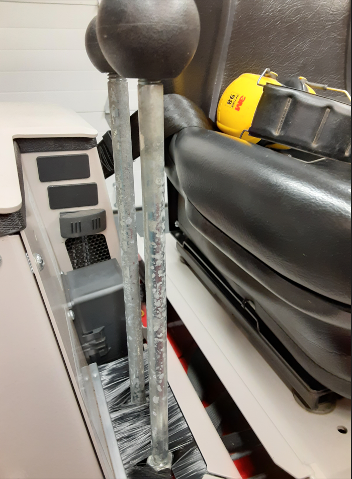

There’s an interesting map on this page that shows how far inland you might expect to see salt affected air in the US.
I live about a mile from the ocean and my six year old tractor is stored indoors, so the metal is only occasionally wet. The hydraulic connectors and almost every other shiny surface looks like new, except for the two control levers shown in the photo below. Since everything else is the same, the only difference is the quality of the coating on the metal of these two parts. I noticed the corrosion starting after only one year.
   / New Kubota Corrosion #82
Given it's just those connectors, my guess is someone had a container of connectors fall off of a container ship in a storm and it was salvaged.
Well, actually I'm not guessing that, but I'll throw that in there as a remote possibility.
