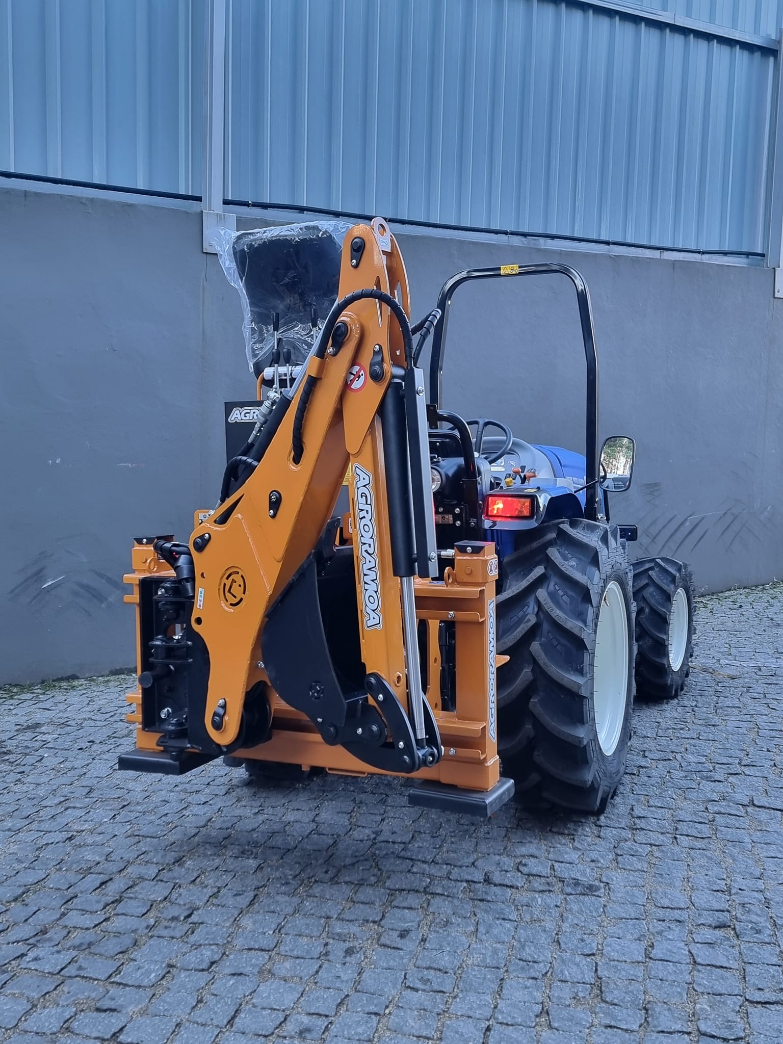

Sub frame mounted backhoes don't really exist on this side of the pond but 3 point backhoes are fairly popular.
However, they typically add 2 extra links attached to a solid point on the tractor to spread more of the forces so it's not all concentrated on the top link mount of the tractor. It also adds stability to the backhoe. Just like this:
View attachment 4506737 View attachment 4506738
The ones sold here also have side-shift which is honestly a must.
That is what's really needed for the 3pt hoes is the double brackets instead of just the top link connection.
If I had a choice I would definitely get the frame mounted one. It would just be so much easier to mount and dismount and one less thing to worry about.

I have a 3 pth Woods. Everytime that I use it I tell myself that's the last time until I get a subframe. (Not so easy as it sounds, I'll have to but one and modify it for the hoe.) It isn't just the digging which stresses them. Having all of that weight sticking out the back causes stress when transporting, especially over rough ground.
/ 3 Point Backhoe #24
I was under the impression that the the subframe was to prevent stressing the tractor because a tractor has no frame. The only 3pt backhoe that I had been around cracked the bell housing between the engine and the transmission with it's constant loading and unloading forces. While I can see that there are a lot of stresses around the 3pt area, the center of the tractor would take the brunt of it, hence the need for an added frame.
If I were to add a 3pt backhoe to a tractor, I would probably add some frame stiffeners to try to reduce the stresses carried to the center of the tractor.
I have not considered adding the additional links, making it a 5pt instead of a 3pt, but at the cost of repairs to a tractor when you break it with a 3pt backhoe, adding anything to prevent this is way cheaper!
