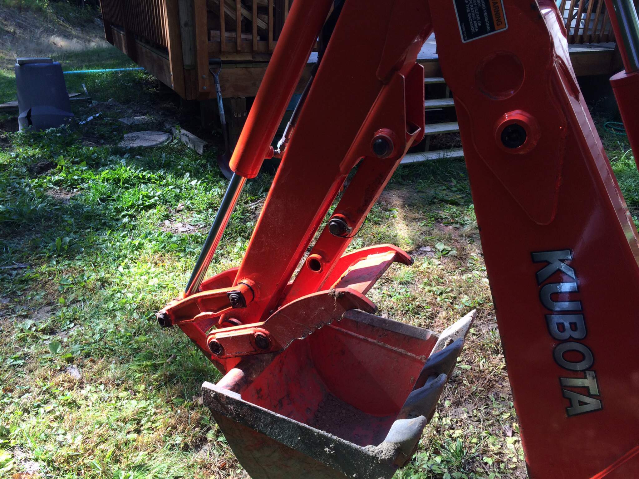

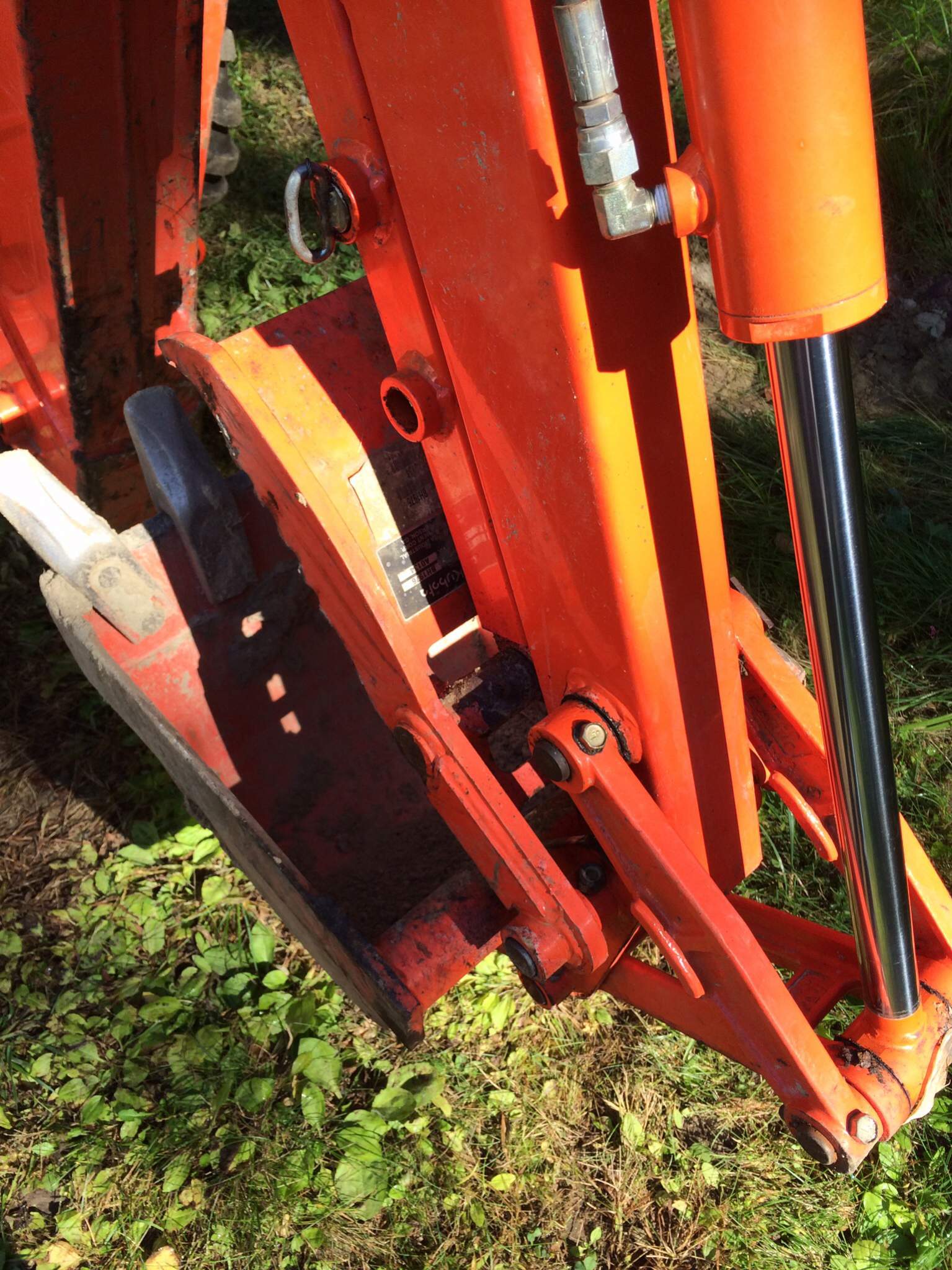

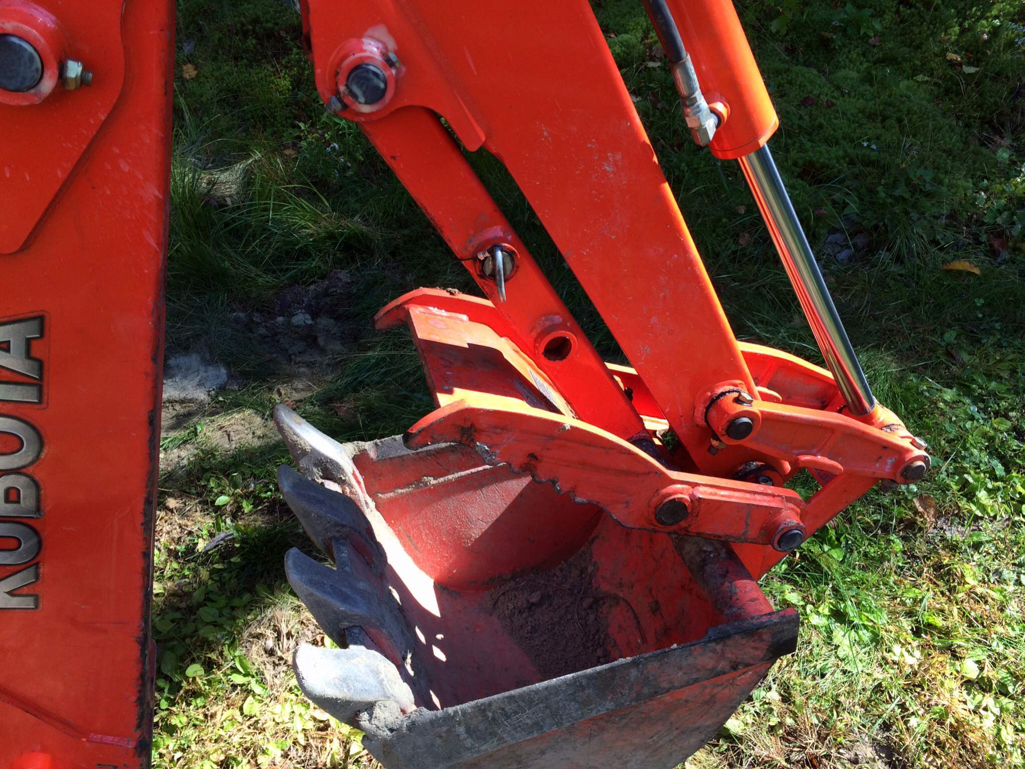

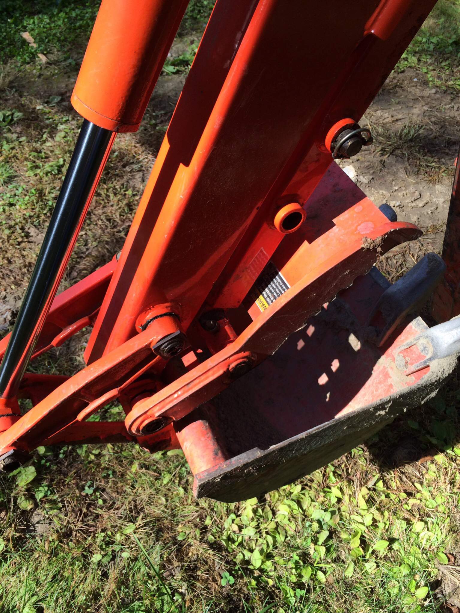

Could you post a couple of close-up photos of the thumb on the hoe? My dad and are going to build one for mine. Thanks!

I'll grab pictures of the thumb this weekend.

Now to get those pictures of the thumb uploaded.....
