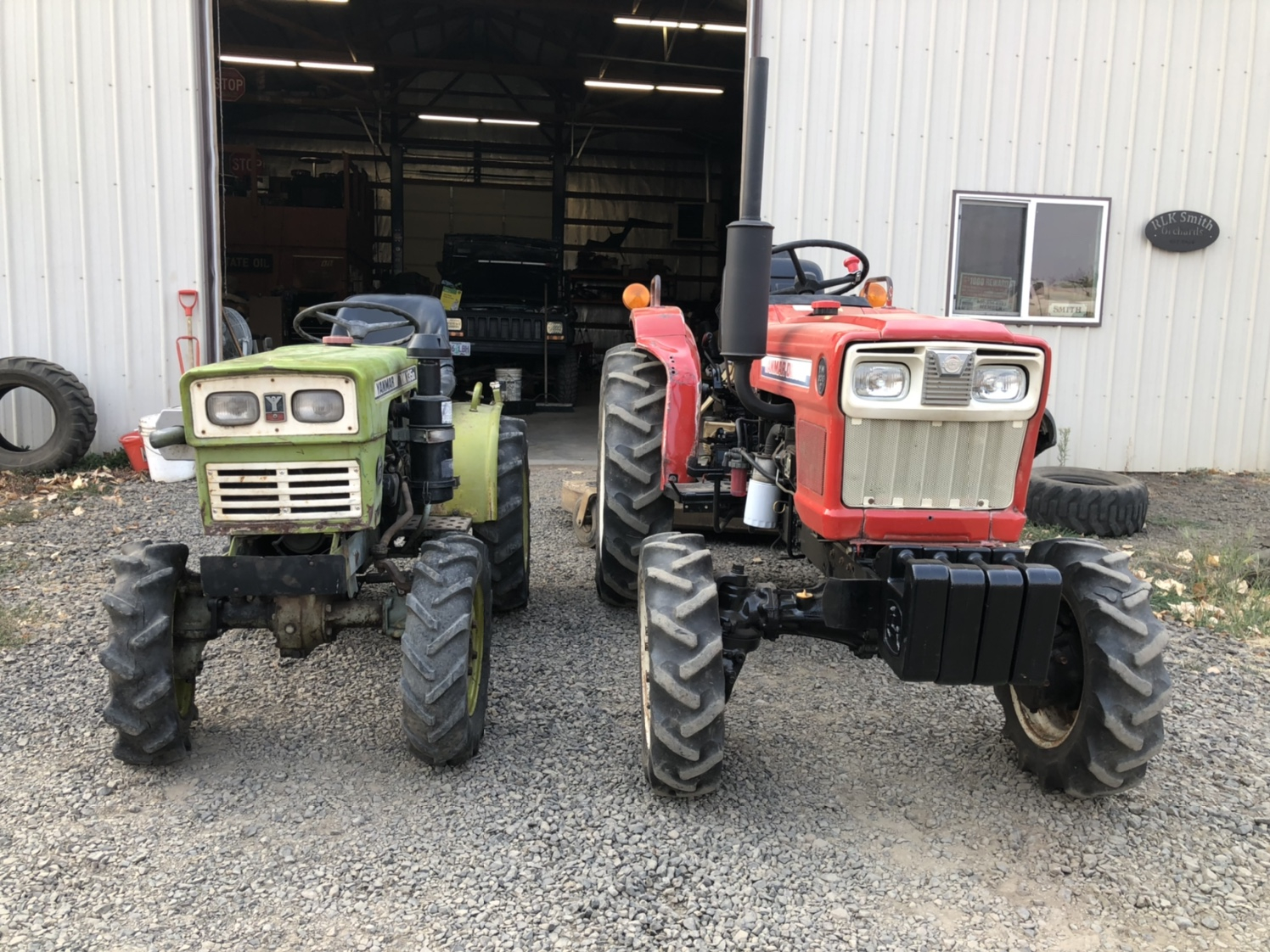

Got the orange flashing lights wired up and working like factory today!
Tonight is the Yanmars first night out of the shop with the bobcats. Mainly because I gotta get my brushcat into the shop so I can rebuild the gearbox. Still have a few things to do but I’m at least on the downhill side of things with the 226D.

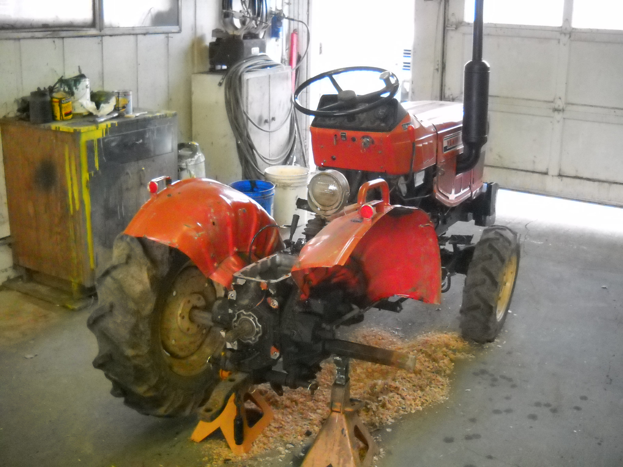

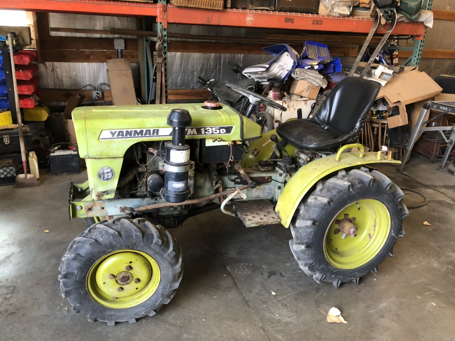

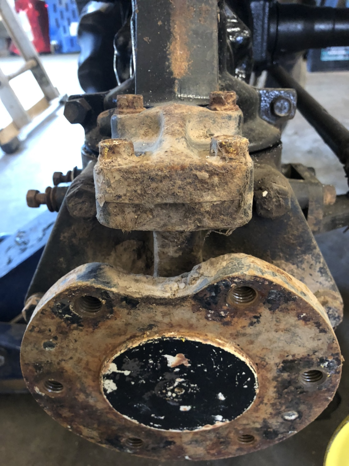

Brought home another Yanmar tonight.
The guys dad used to be the local Yanmar dealer back in the day and believes his dad sold this 135D new. This tractor needs the front end rebuilt mainly, it was pulled apart to diagnose the oil leaks and was thrown back together and parked. It runs great, clutch probably is gonna need replaced as it kinda grinds into gear, missing all of the 3 point hitch. I’ll start a new thread for it, looking forward to bringing another Yanmar back to its former glory.

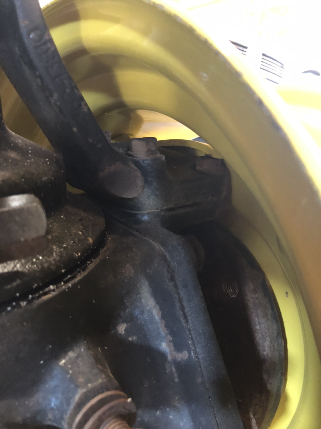

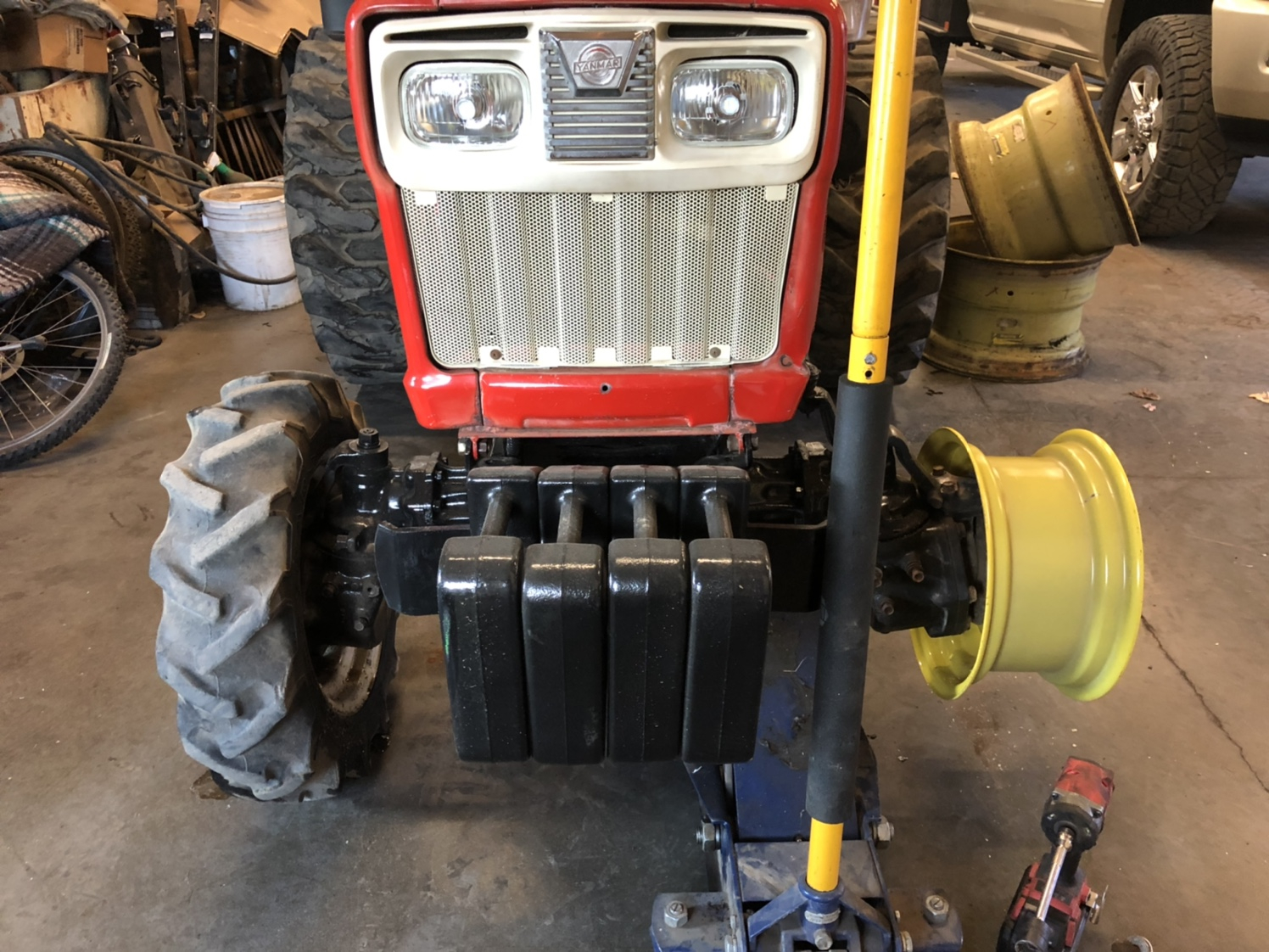

Finally found most of a set (missing 1 front) of wheels/tires from a 790 John Deere today.
The rears fit like a glove, front measures to be the same as well. My sway links are a tight fit however I ultimately plan to get a quick hitch and probably spacers in the rear which should solve that problem. I do plan to get these wheels blasted and painted to match, just wanted to mock them up and see how it’d look.
Ratio wise I should be good with the matching set of R4’s can my R1’s so everything in theory should work. Should be a great alternative to mowing grass on fairly soft ground.

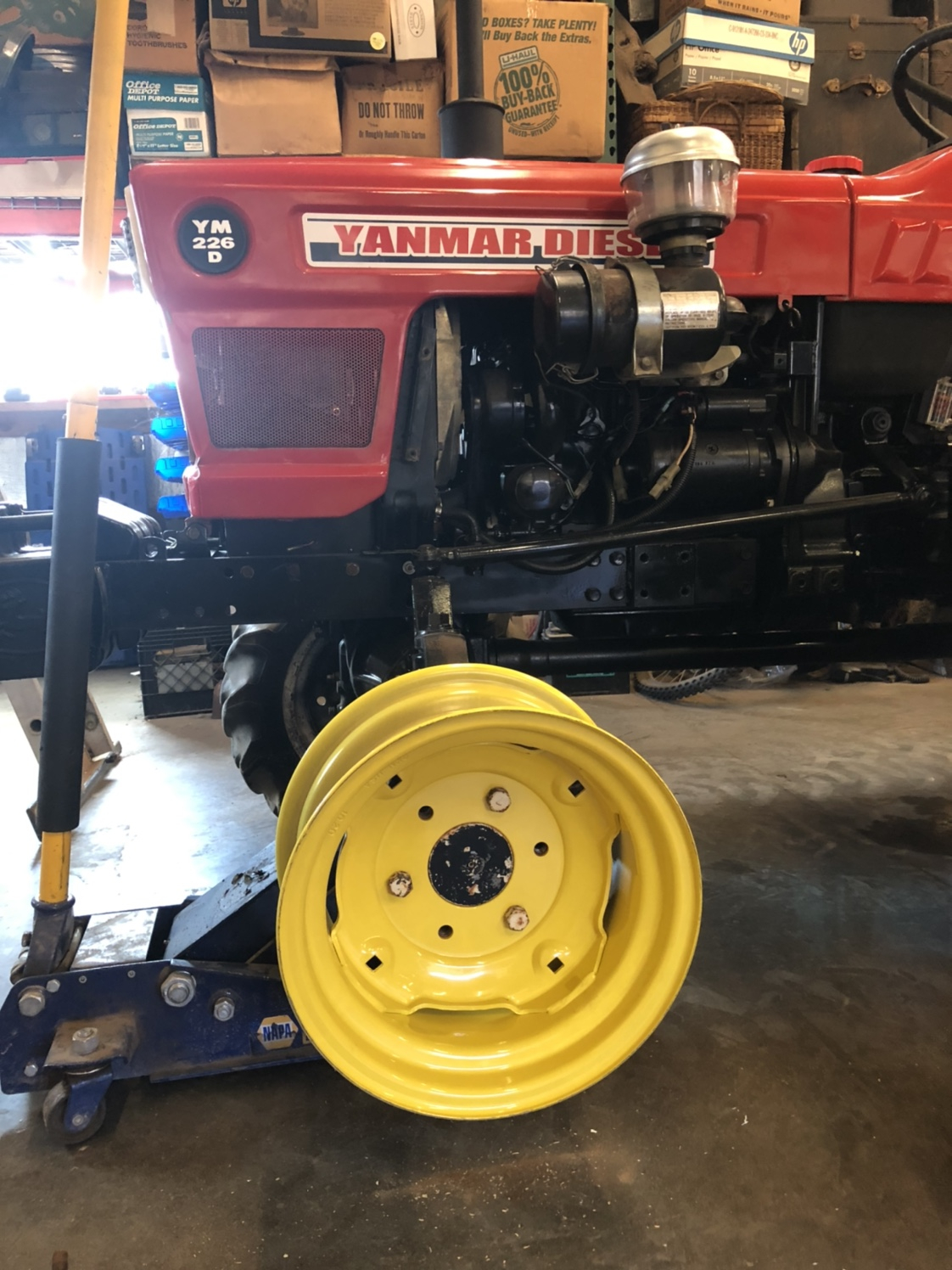

Just some cosmetic changes to clean up the 226D.
Sizing up the new front wheel
Note: Front wheels only fit in the wide position

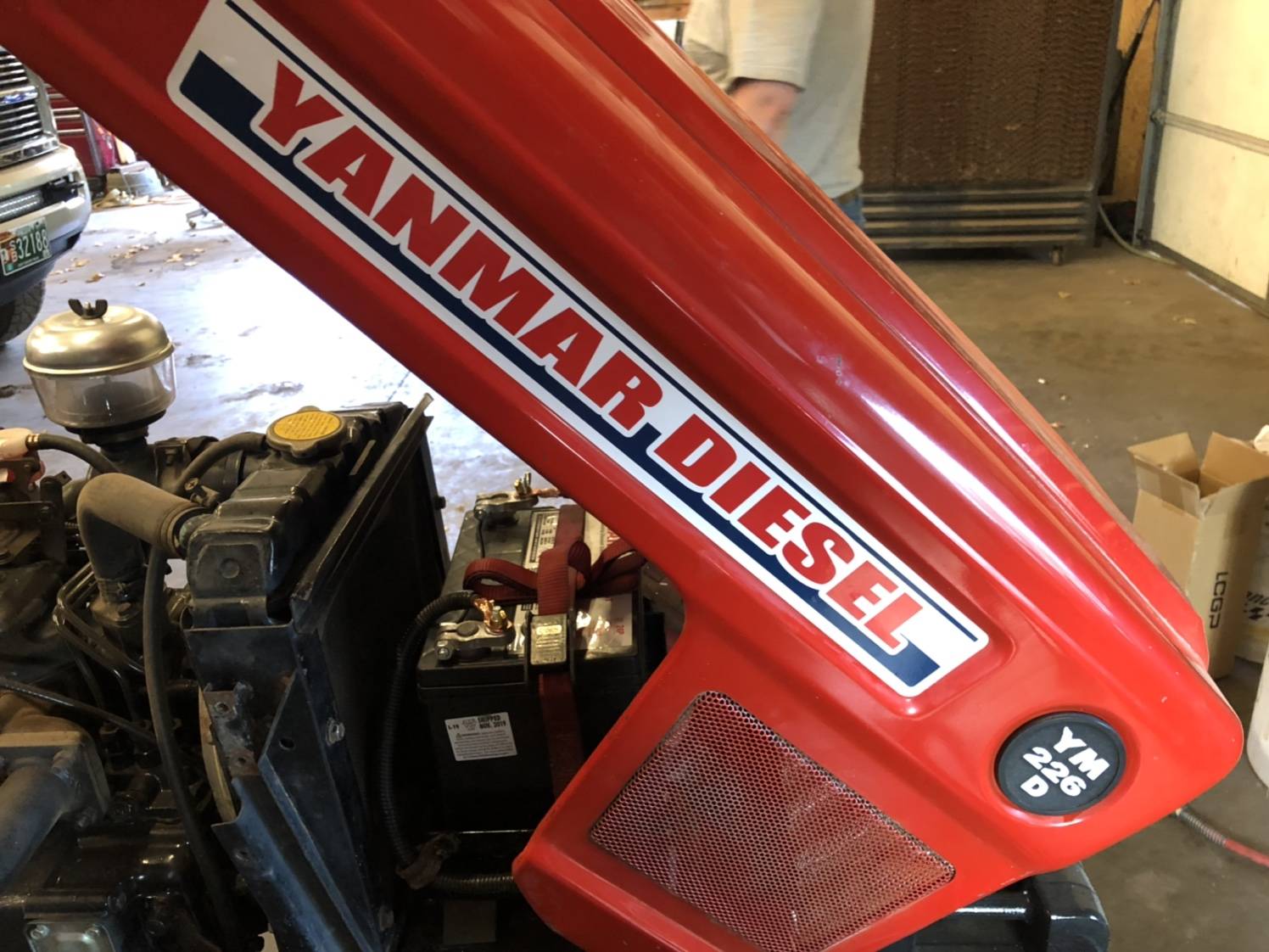

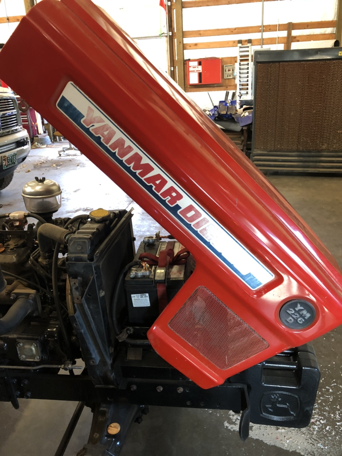

Is that a replacement Yanmar Diesel decal ?
It is yes. They’re not quite as long as the originals but they do look a little nicer without all the fading.

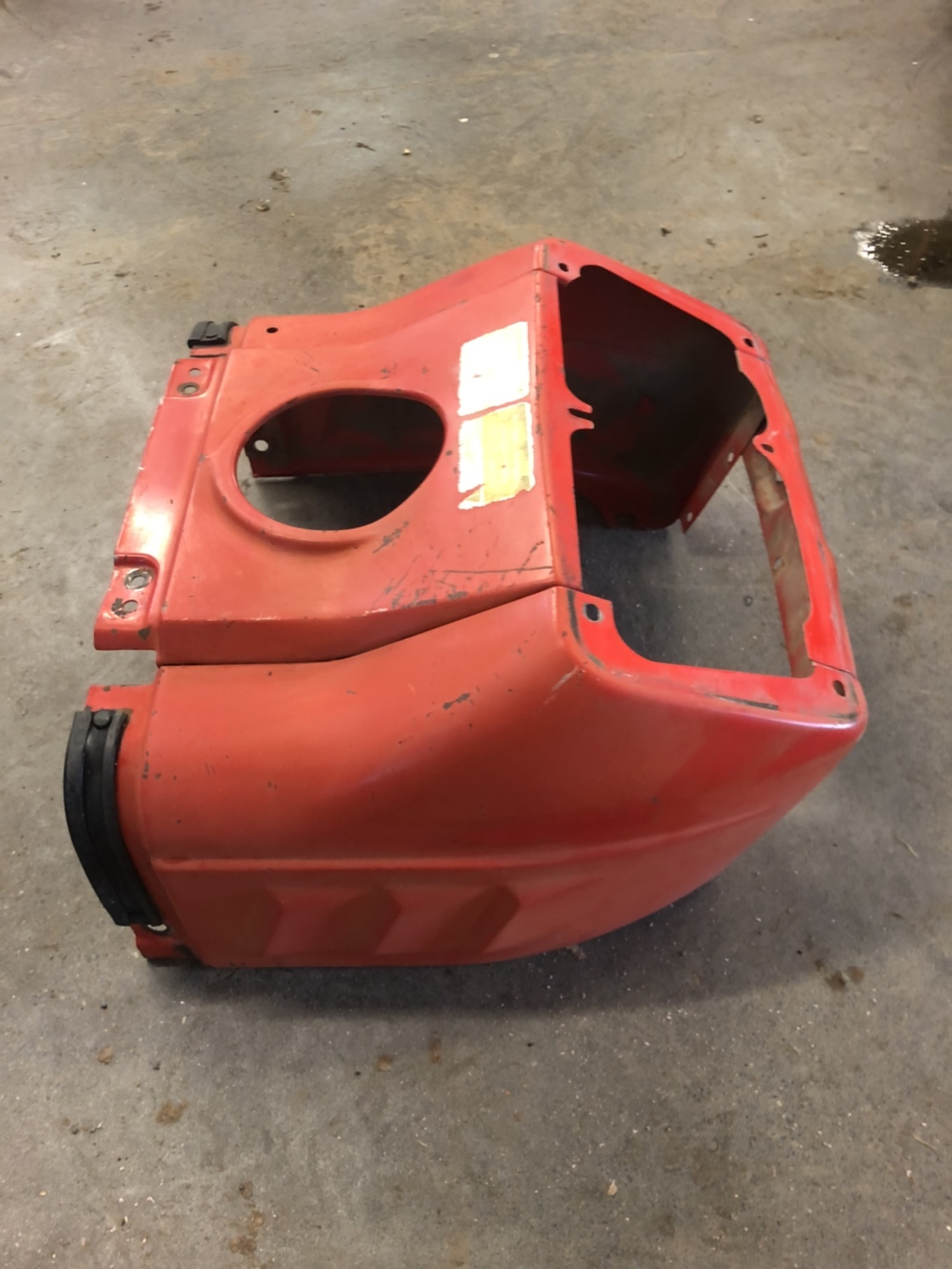

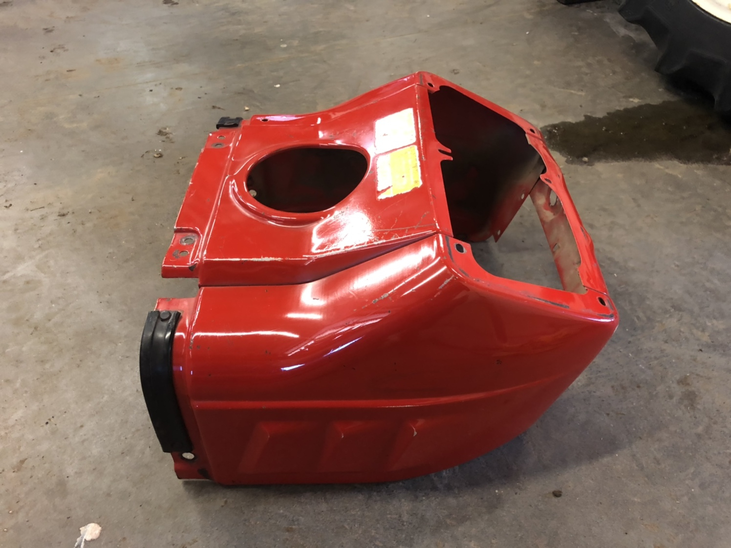

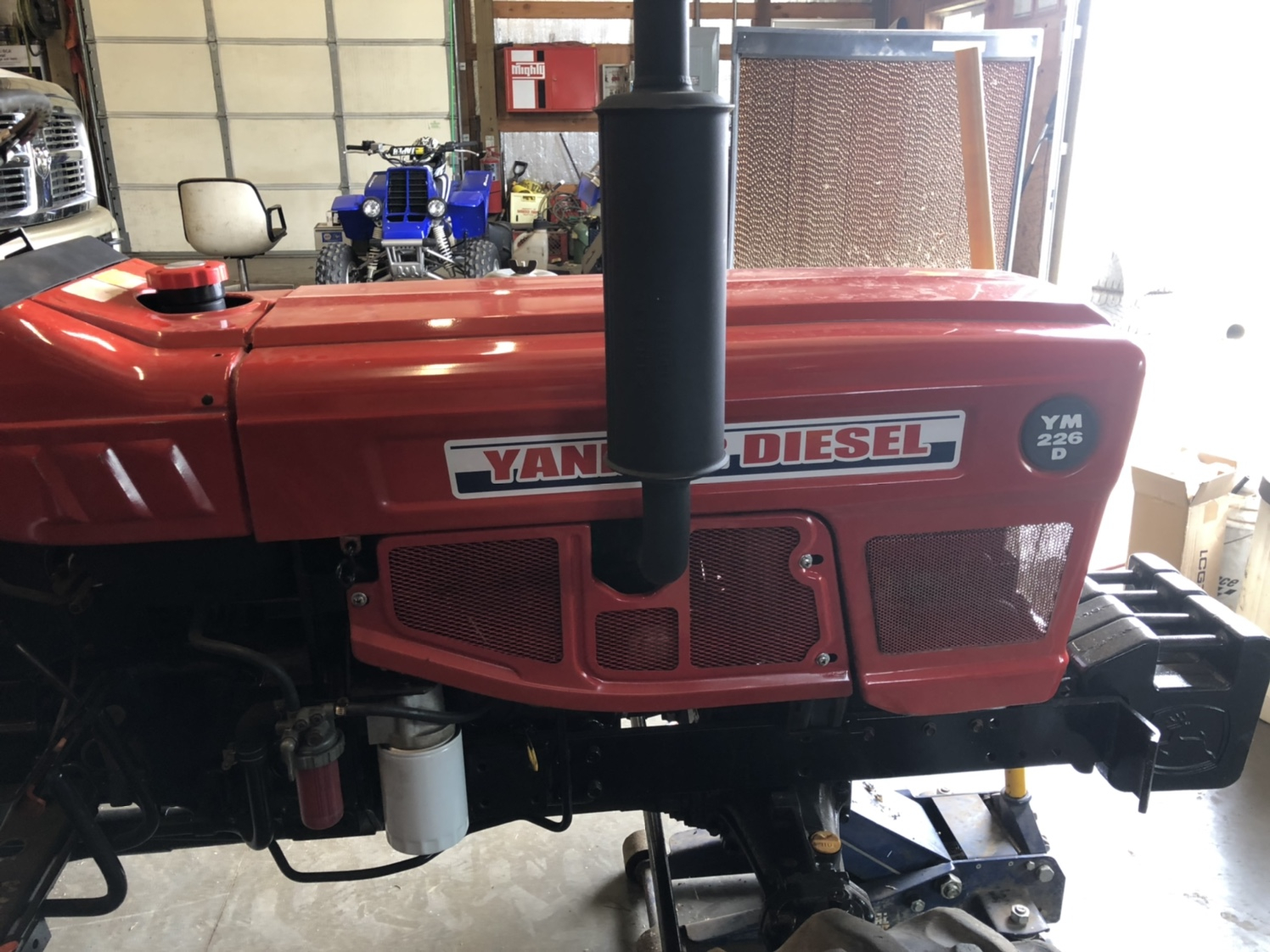

Made a trip out to a friends house and found some Yanmar side panels. unfortunately they weren’t exactly right but with slight modifications they fit right on.

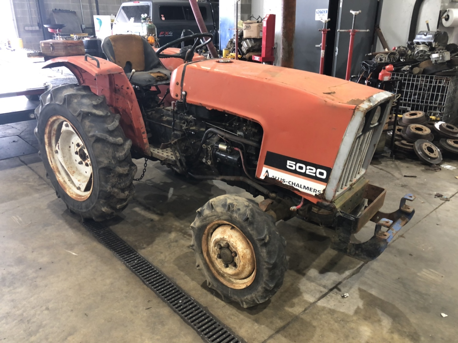

And I got another project tractor…. Allis Chalmers 5020 (Hinomoto E23 if I’m not mistaken)
/ New to me 226D #80
And I got another project tractor…. Allis Chalmers 5020 (Hinomoto E23 if I’m not mistaken).
From what I recall reading here more than a decade ago - Those are excellent, every bit as good as the Yanmars. But with one exception: A few people were crying that they broke the ring gear or front differential or something similar, with no hope of repairing it. No parts available. Hinomoto folded long ago. That unavailable part was already stripped from every salvage yard Hinomoto.
I guess the thing to be learned is don't overstress the differentials and you will be fine.
