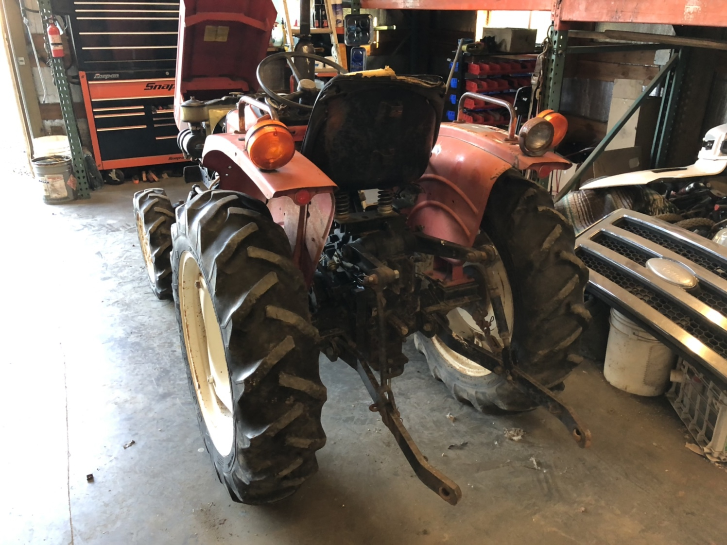

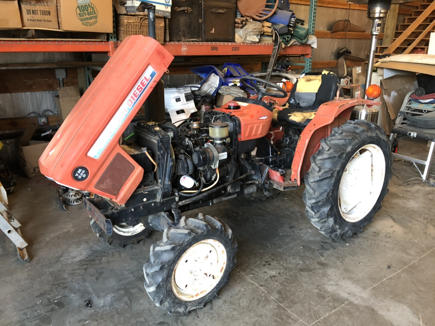

Posted this on my other thread but figured I’d start a new thread for the “new” tractor. This one is a Yanmar YM226D, let’s just say it needs some love.
- Clutch releases basically at the bottom of the pedal (can’t shift ranges or into the PTO when running)
- front axle pivot is pretty worn out
- previous owner ran it out of fuel yesterday so it takes a while to start and it struggles to stay running, no blow by though when it warms up
- radiator top is a bit crushed
- dummy lights are broke out and the lights don’t work (not a huge surprise)
- 3 point is missing a few parts but still fairly complete
- 4wd lever does nothing, it flops around like it’s not connected to anything and the tractor is stuck in 4wd
- Tach cable is broken so hours are unknown
All this being said I see potential in this tractor, working on creating a list to start ordering parts from Hoye Tractor. Focusing more so on the clutch and 4wd lever at the moment. If all goes well this will probably replace the 186D, mainly liked this tractor for its added weight and length which could help it handle the mower better.

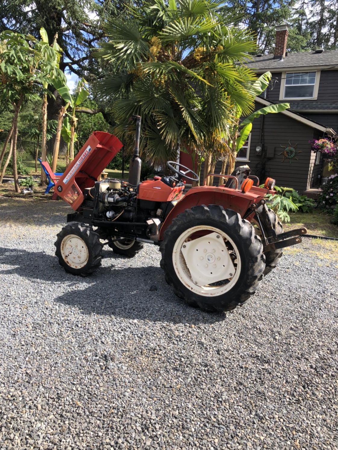

Wow, it looks like Yanmar fever bit you real good.
I know, it takes one to know one, I walked down that road many years ago, as you saw the collection I once had when you came over to my place....

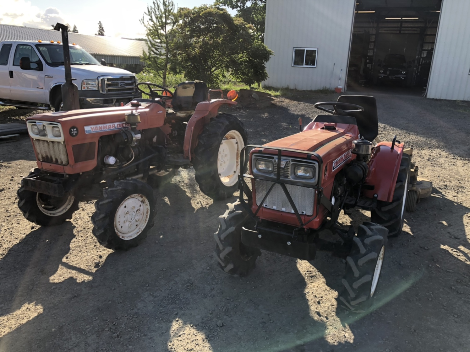

They make a good looking pair. Enjoy your YM226D.

Oh it definitely is! I think I’ll probably stick with this 226D if I can get it dialed in, I like that it’s a little heavier since the finish mower kinda pushes the 186D around on inclines. If you’re ever back in the area you should stop by my yard and see my collection, it seems to cover 3 things now; Yanmar tractors, Bobcat construction equipment, and Ford trucks.

I was impressed by the bananas and other tropical plants in the yard. The Yanmars must feel like they are back home. :)
Good luck on the rebuild/restoration!

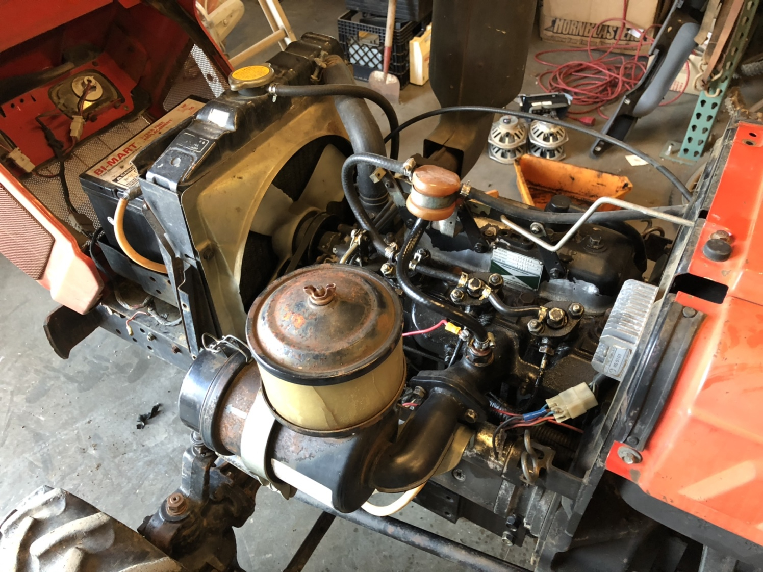

Decided to drain the tank tonight on the 226 and clean some of the junk out of the bottom of it. Modified the fuel line a bit and rebled the fuel system with fresh fuel. It finally starts good but still has some major lag when you throttle up from a low idle. When running I think it sounds like it’s running on 2 of the 3 cylinders, I may further investigate to see if it’s an injection pump or injector issue. Has a light haze of white/grey smoke at WOT.
/ New to me 226D #12
I can't see the inj pump in ur pic....
If it's anything like my yammy (and I don't know if it is or not) there would be an access plate above and beside it that allows access to the linkage from the governor to the fuel rack....
If there is, pull it and set the thottle about 1/2, then see if you can move the rack back and forth.... should be next to no effort required....
If it's tough to move at all, disconnect the governor and try again...
If still tough, the inj pump needs torn down and cleaned...
