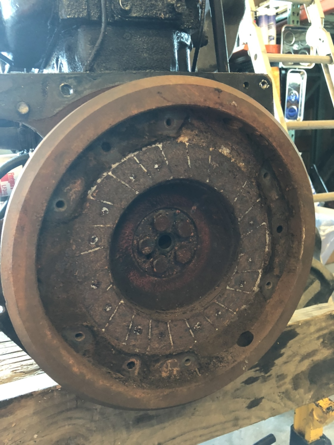

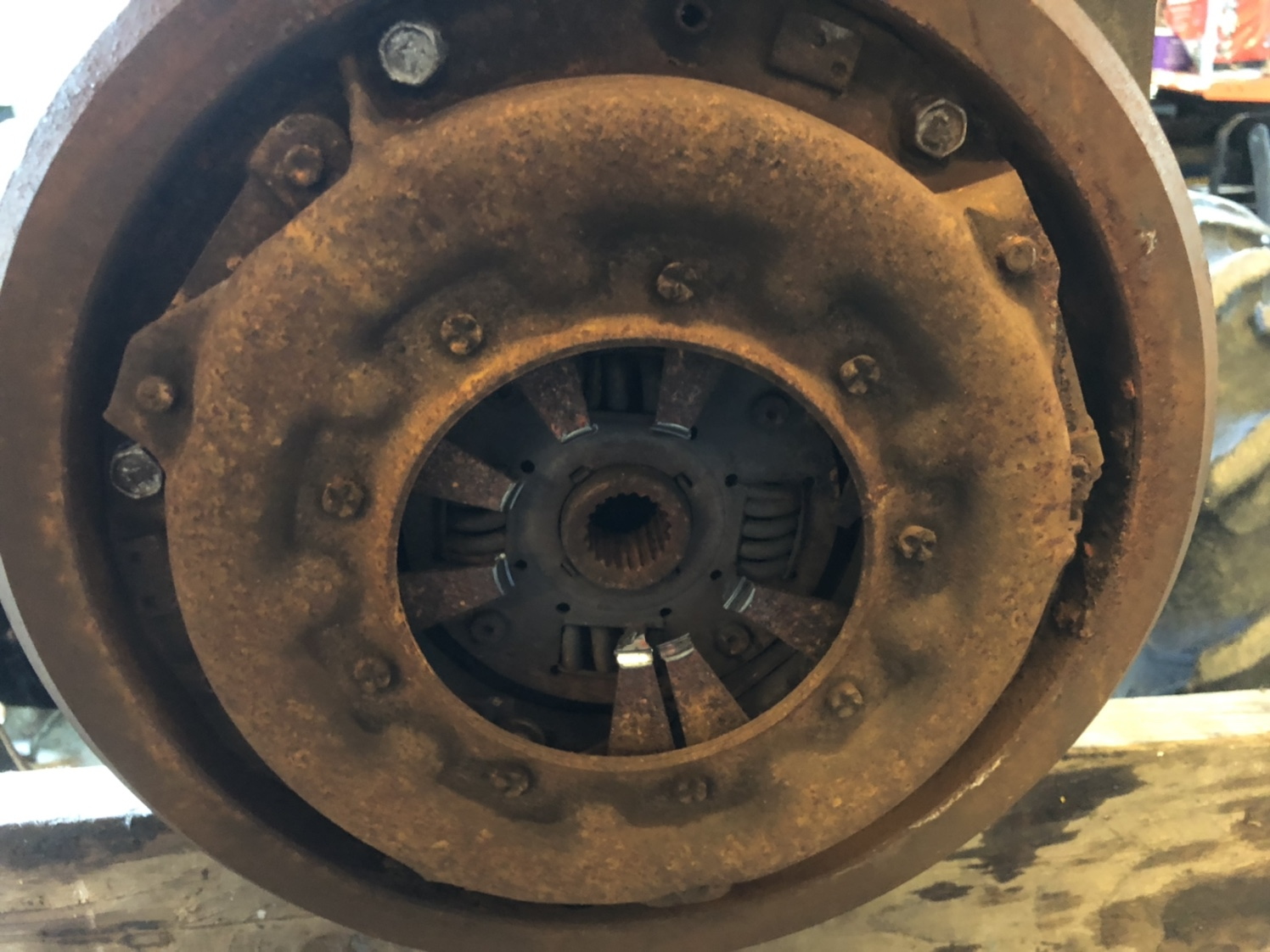

Wow, that's quite a bit of rust. Like @California I wonder if you think it got flooded?
All the best,
Peter
I’m thinking so, I checked the front diff today and am not getting any reading on the dipstick, I’m sure it’ll need resealed like my 186D did.

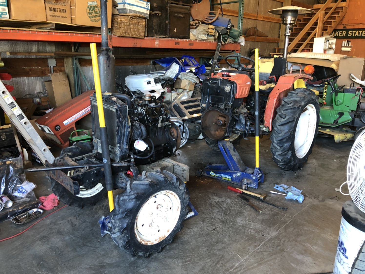

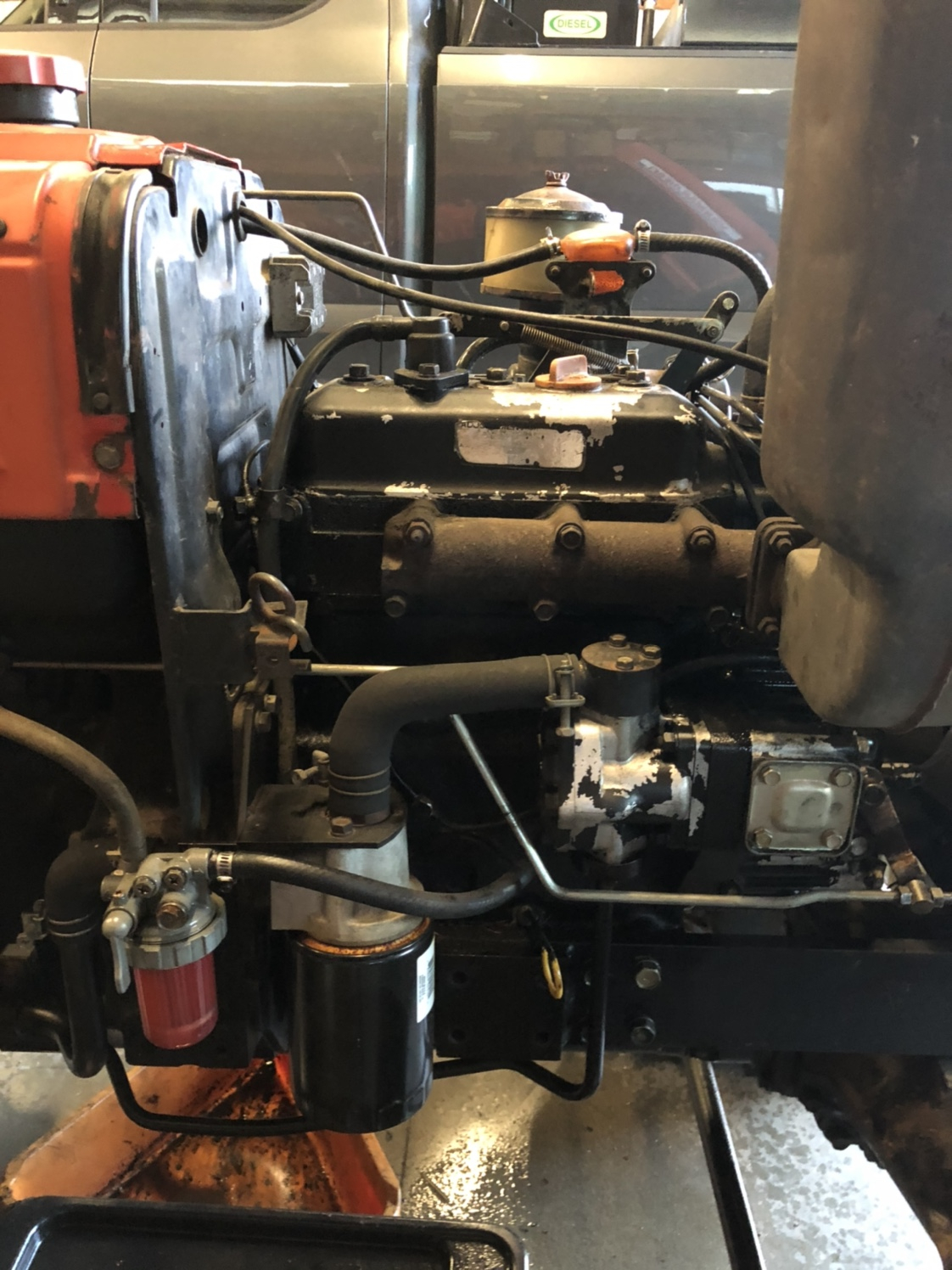

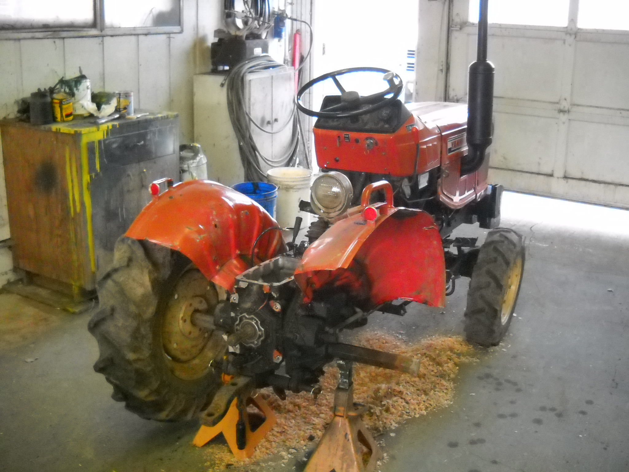

Made a little more progress today on the 226D despite the 110* heat. I pulled the injectors and injection pump to have them tested abs cleaned while the tractor is apart. It was running on 2 of the 3 cylinders and struggled to gain rpm as you gave it throttle. Upon disassembly I found the 3rd port dry and that the pump had no timing shims under it. I also found that most of the exhaust nuts/bolts were finger tight. Fortunately though this tractor is more of an extra machine so I can take my time and be sure to go over it thoroughly before I start to put it to work.
/ New to me 226D #24
I'm impressed at all of your work in the heat.
On the dry pump, why do you think it was dry?

Previous owner ran it out of fuel and attempted to bleed it. That 3rd port was loose so I think he messed up the injection pump.

Got another chance this evening to work on the 226D. Brought the back half of it outside for a rinse then tipped it back to further investigate why the 4wd lever just flops around. It more or less appears to have fallen apart probably from someone forcing it into 4wd. Im hoping to track down a complete 4wd unit instead of fixing this one, any insight as to what other Yanmar models may have this same shifter assembly?
/ New to me 226D #30
Over at the Yanmar Tractors Owners Group, we have several of the YM 3-digit and YM 4-digit Parts Manuals. All you need to do is download and find matching numbers.
Recently, we learned that several of the 4WD parts from John Deere 50 Series were matches too. For example a YM226D matched up to a JD750 for the left side steering arm.

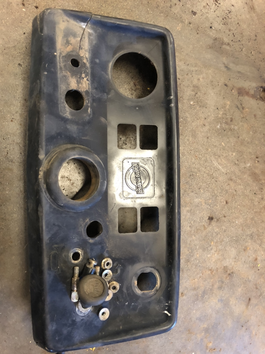

I’d love to find a new dash panel but hoye no longer sells this one. Would love to find one that doesn’t have all the tabs on the back broken off.
Got the dash cleaned up a bit
On another note I did some digging and the ROPS for a John Deere 750 are really similar to the ones for a 220/226 Yanmar. May entertain that option if the 220 ROPS doesn’t work out.
So, do you have CAD software on your computer? Then access to a 3D printer? One can make ANY dash to then fit your tractor.
Before my dash gets bad, I plan on taking it off, do total measurements, and create a 3D model. Next, I can add whatever I need to the dash for gauges. Then get the NEW dash 3D printed in a durable material. Plus, I can thicken the wall thickness of the dash to be really strong. Mine didn't come with the Yanmar logo like yours, but I can 3D print one on mine. :)
So, don't think there isn't a solution.
Plus, need 3D CAD software that is FREE without being crippled like AutoCAD Inventor or that crummy CREO CAD, then check this out. IT is full featured like SolidWorks.
FreeCAD V19
Sort of like a dash panel . . .
Here's a Yanmar headlamp grill that has the 3D printed look. Just needs paint.
