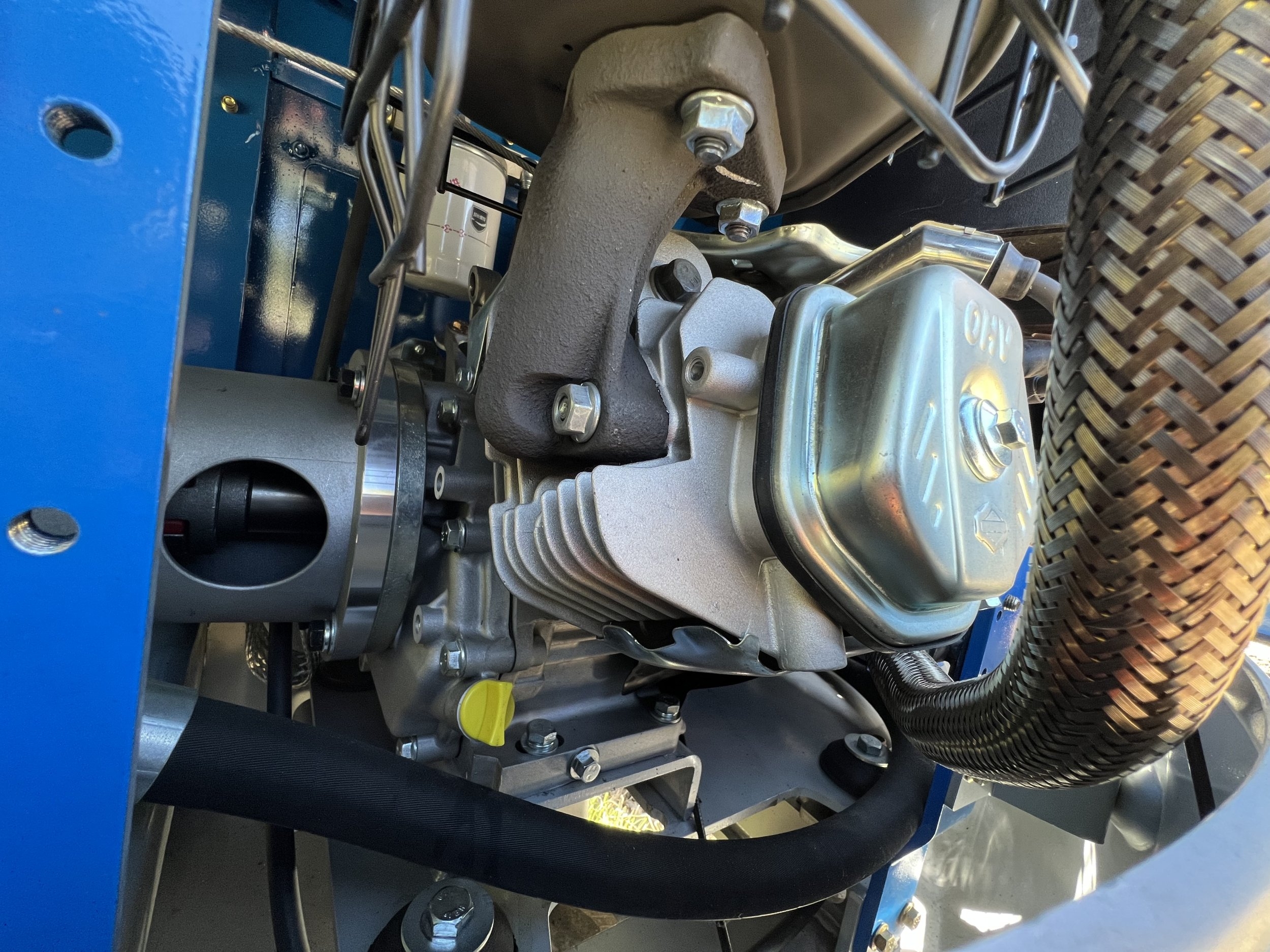

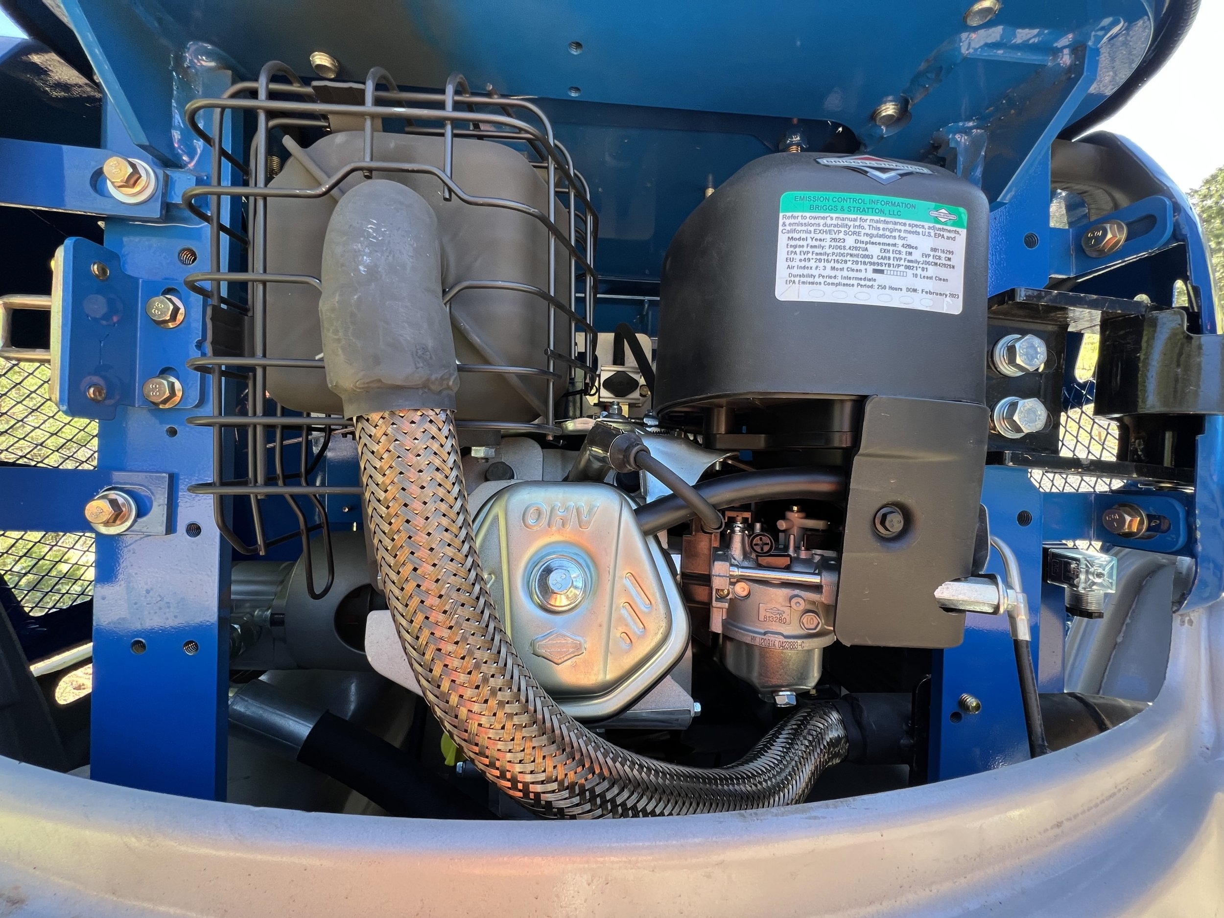

Here is a picture of the engine compartment. The photo above is from what the seller sent me. As you can see the exhaust flex pipe runs right in from of the valve cover. I disconnected the pipe and took off the rear hatch. Now the problem is that it won't start. I used starting fluid and it ruins for a second or two, so it has spark. I checked the spark plug and it looks good, not fowled. I disconnected the fuel line after the fuel pump and it is dry. I can hear the pump but no flow after the pump. The line before the pump had gas so I'm suspecting the pump has an obstruction or maybe not primed. I checked fuel level and it has about 3/4 tank. The only thing I haven't done is top off oil in case the kill switch is not letting the engine run. Oil level is slightly above the half mark. If it is that, how come it fires up for a few seconds? Unless that is how it works. I may take the side covers and inspect each fuel line section for any obstruction from the manufacturing process. I've seen it before that when they drill holes on the gas tank, the shavings are left in there. If not of that works, I'm running out of ideas.

Good news! I traced down the no fuel issue! I bypassed the fuel filter and it fired up right away. It's been running for 45 minutes so far and not a hiccup. Going to order an online glass see through filter in place of the screw on canister filter until I figure out what is the issue with the filter assembly.
/ New Rippa NDI313 problems #19
I have the same mini. I have answers for you. The fuel is being vaporized in the fuel filter because of the heat from the engine not being fully duckted away because the fuel tank and air lovers are removed. I also turned my hyd cooler around and lifted it 3 in so the cool air can be pulled into the engine and pushed away towards the pump. Then I added 10mm thick firewall insulation everywhere under there. This weekend I will be putting exhaust wrap on the muffler and flex pipe and installing a 12in fan pushing air out the pump side. The fix the fuel problem you have to remove the right side silver trim and move fuel pump down there where the fuel exits the plastic tank. Dm me if you have any questions or issues
