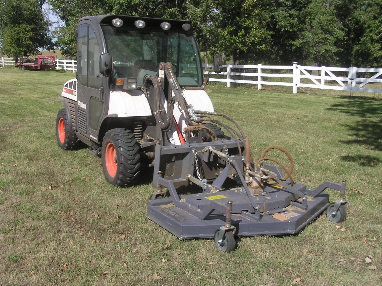

Wide turf tires are an option. No problem here with the red clay as long as it is dry:

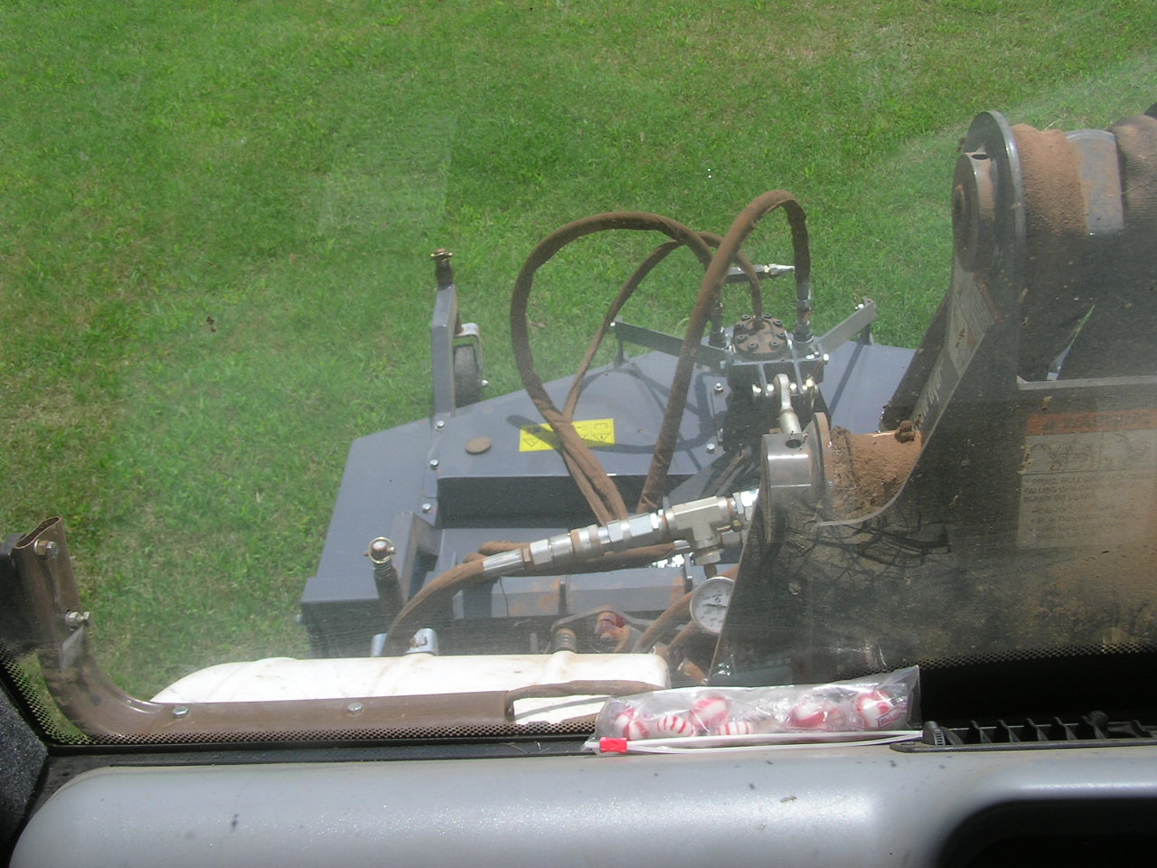

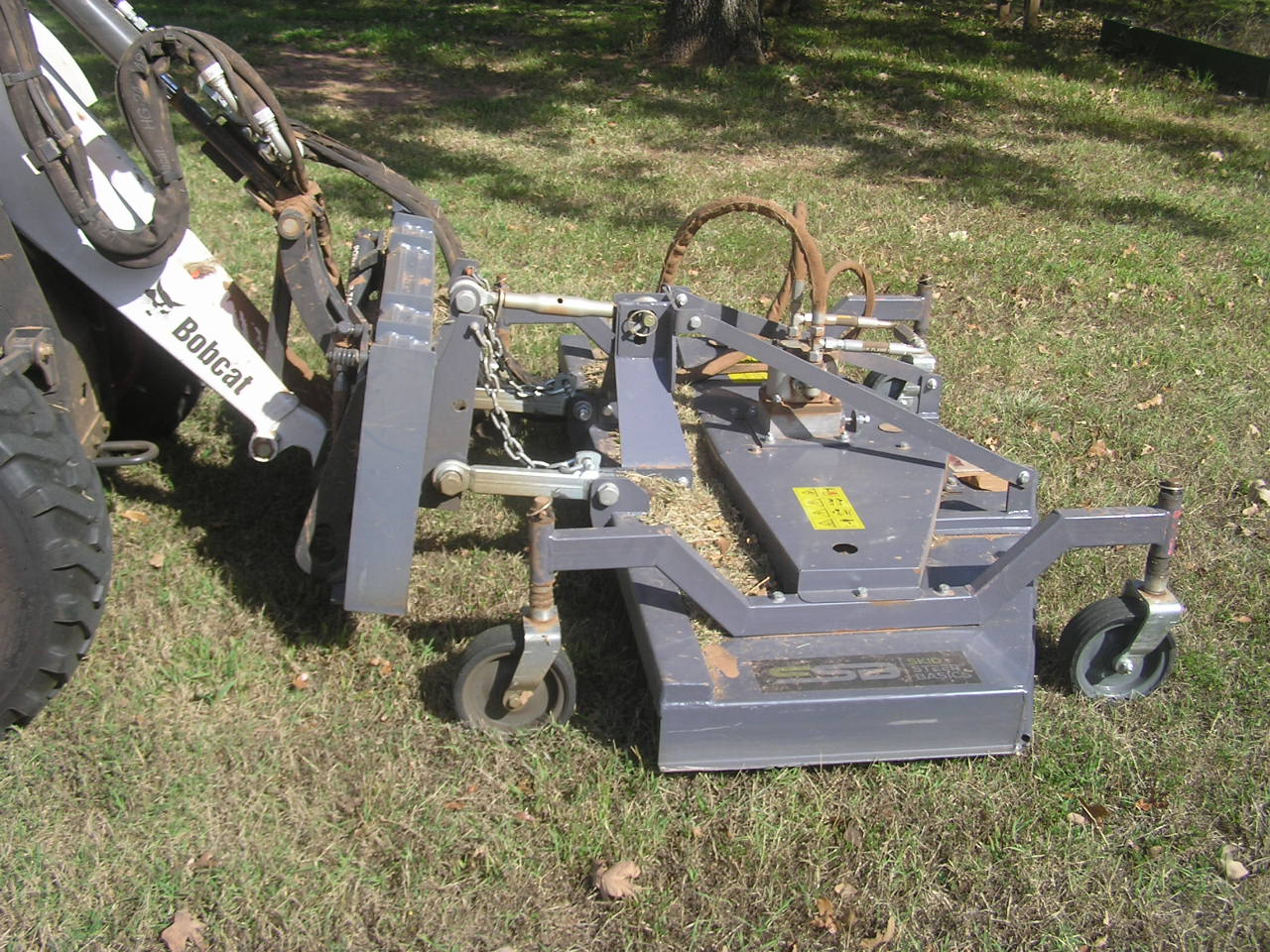

Easy to check under the deck:
