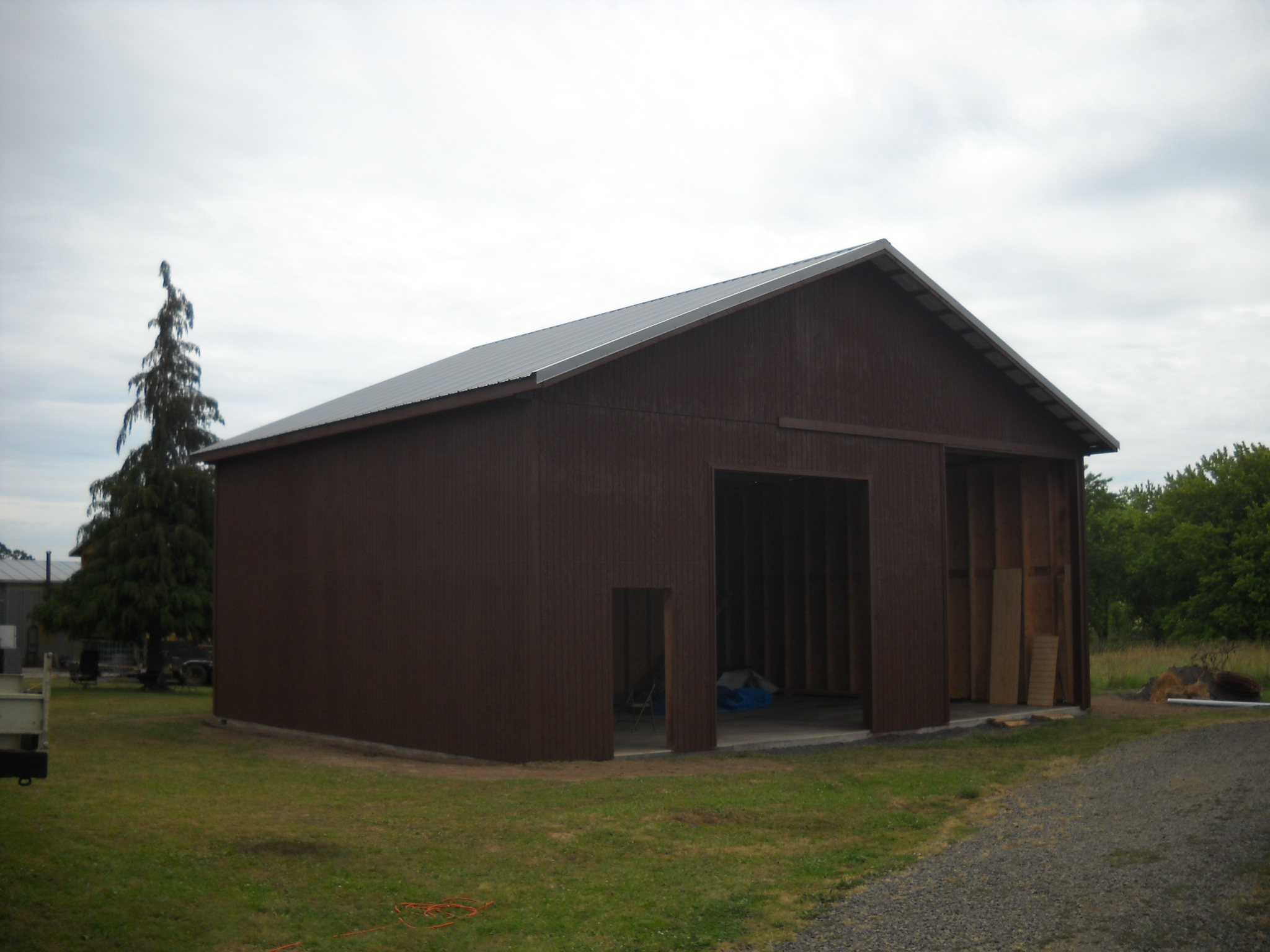

/ New Pole Barn - Some Assembly Required #22
We finished the shop today. Put on the metal which was delayed and got it all up within 4 hours. :thumbsup: Looks sweet now, we even painted it. :thumbsup:

The shop looks great JD! You guys win. :D

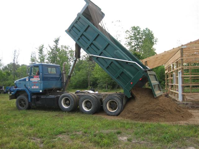

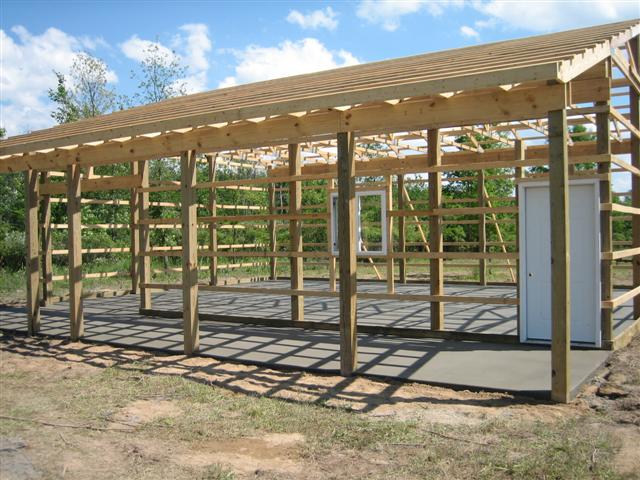

New floor today!
Crew was there bright and early. Started with excavating the sod, then brought in sand and compacted. Concrete started arriving at noon and the whole job was completed by 3 O'Clock.
Almost lost the barn though. In the one picture you can see how the concrete truck was pulling up to the large door. The one truck actually bumped the building at the top of the door, moving it a couple inches, but luckily it bounced back.:eek: No broken wood and it is still straight. Phew!!! Concrete company almost bought me a new building!
