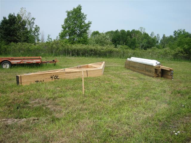

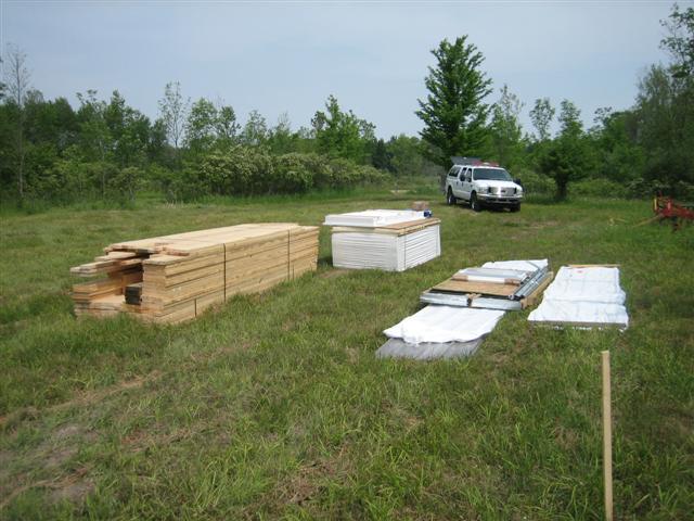

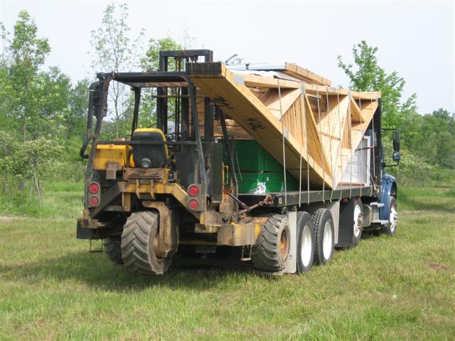

After a few years of reading about everyone's pole barns (and learning a lot on this site) we are finally getting our chance. Very excited! :D
The materials were delivered today and the construction crew should be here in the next day or two to start. It's going to be 30x40x12 with an 8 ft. lean-to along the one eave side. Concrete floor and concrete under the lean-to.
Yes, I know that 40x60 or larger would be better as would a 14 ft ceiling, but there's only so much in the budget. It will be a huge improvement from parking the tractor and implements in the middle of a field like I've been doing for two years.
I will post more pictures as the build progresses. Have a great night!

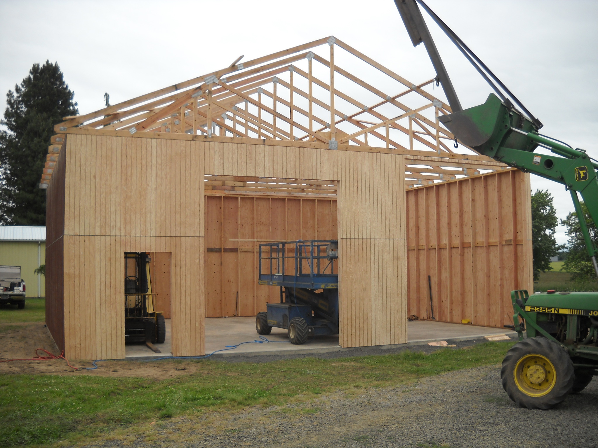

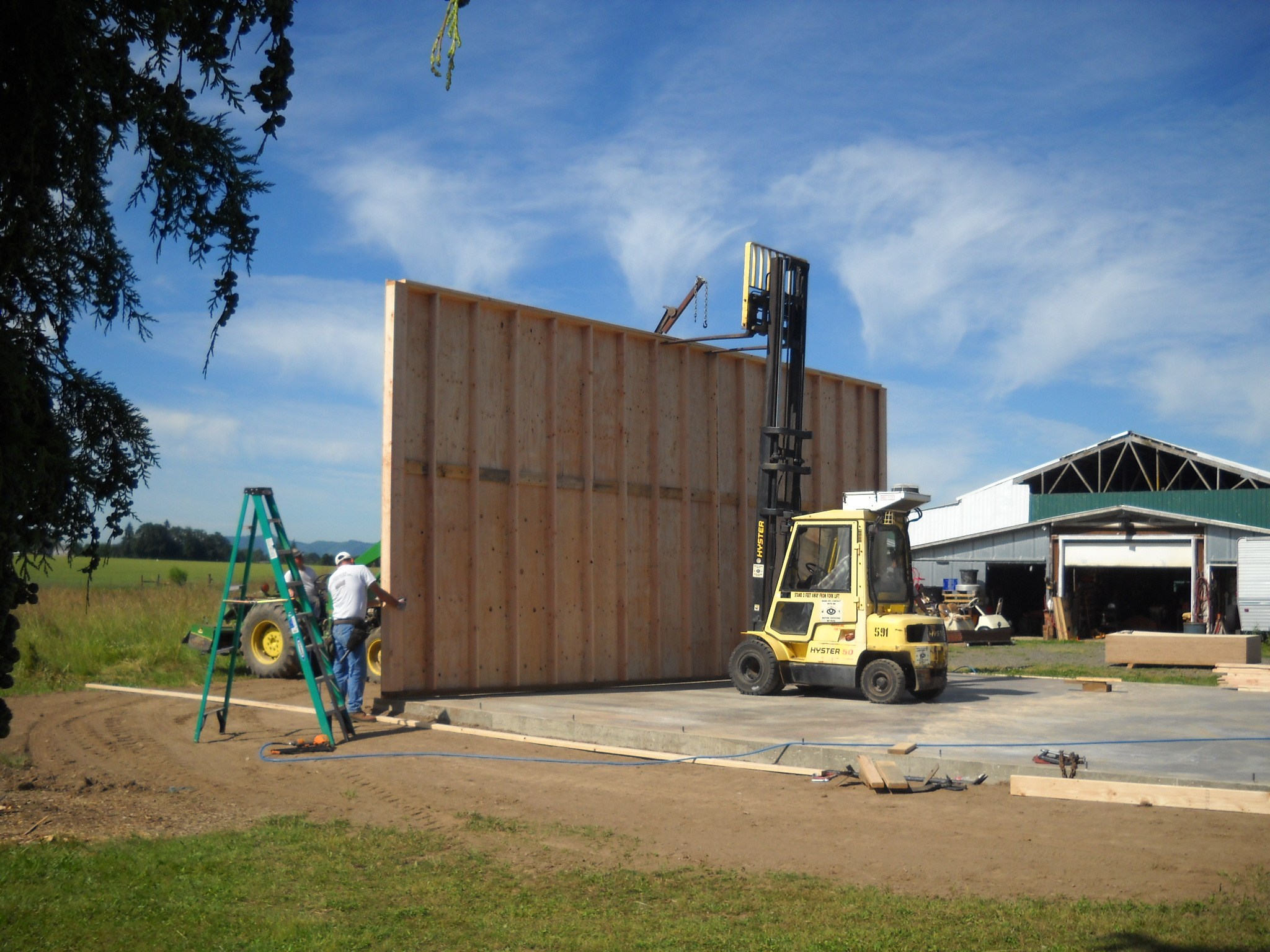

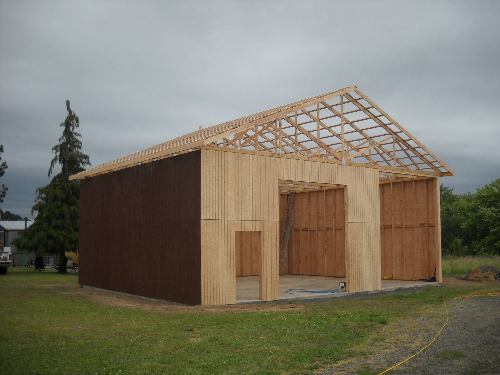

Hows progress coming along on your barn? We put up 3 walls yesterday and the 4Th today along with trusses. it is now ready for the metal roof. It should be done Friday as we aren't working tomorrow because the metal isn't on site. We also have to put on the T-111 siding for the gables but that shouldn't be to hard.

Why didn't you put steel on the walls? Isn't that more maintenance free? I like the idea of 2x4 walls so it can be insulated eventually.
The home owner was trying to get something cost effective but after he gets the T-111 and paint it will be more expensive vs/ metal. I too think metal would have looked better but that's what he wanted. It was a little easier to install though since we did it while we were building the wall flat on the ground.
