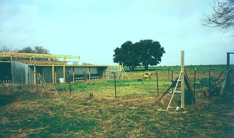

I found an old picture of mine going up. The "old" 12x36 section is to the left. I had a small garden and chicken coop I was building at the same time. You can see the hen boxes to the rear of the covered area. It was later closed in out to the end of the wind wall. I think this picture was taken around the fall of 2002. The barn is still solid and functional. And I also have a Bridgeport Mill out there.
