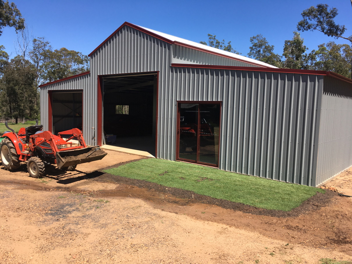

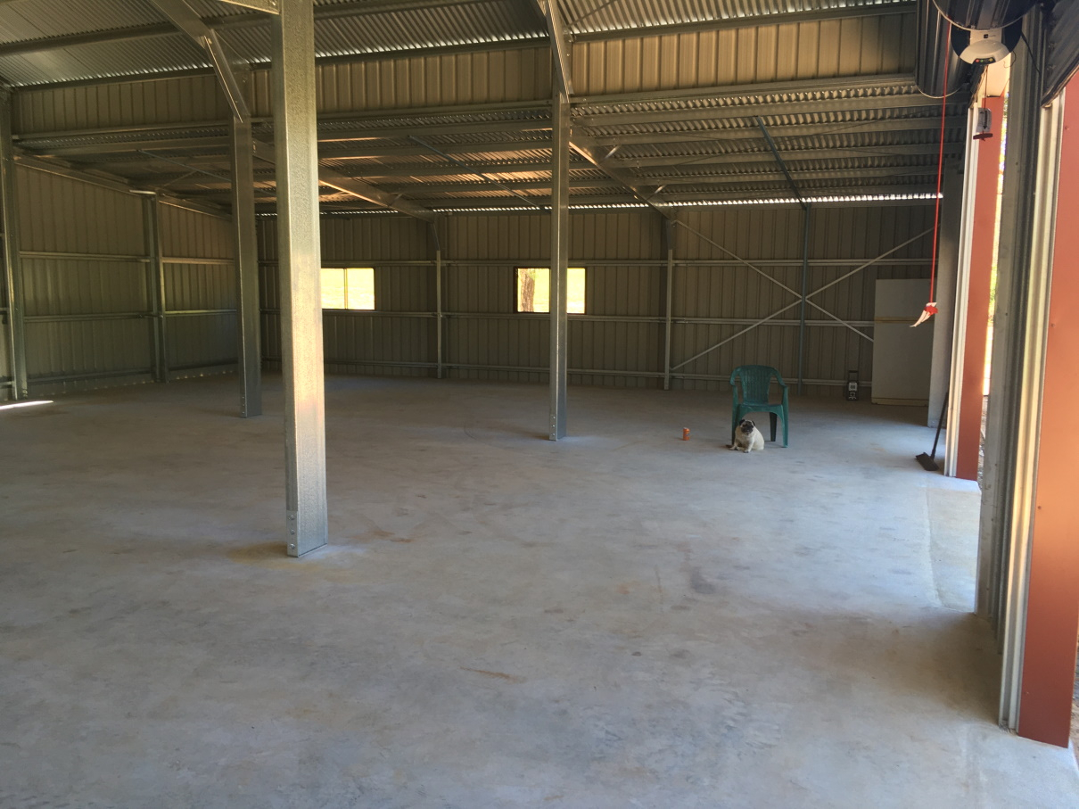

I put crushed in my old barn that was supposed to pack down hard. It did not. The tractor tyres break it up too easily. Wish I had never put it in there.
The 'new' barn I did it 'right' the first time.View attachment 730780View attachment 730781
I don't see any expansion joints cut into your floor. Did they do that later or don't they do that down there?
   / Floor Options For Pole Barn (Not Concrete) #54
Expansion joints not necessary here. This is the preparation. Lawn laid and I have gravelled the rest.

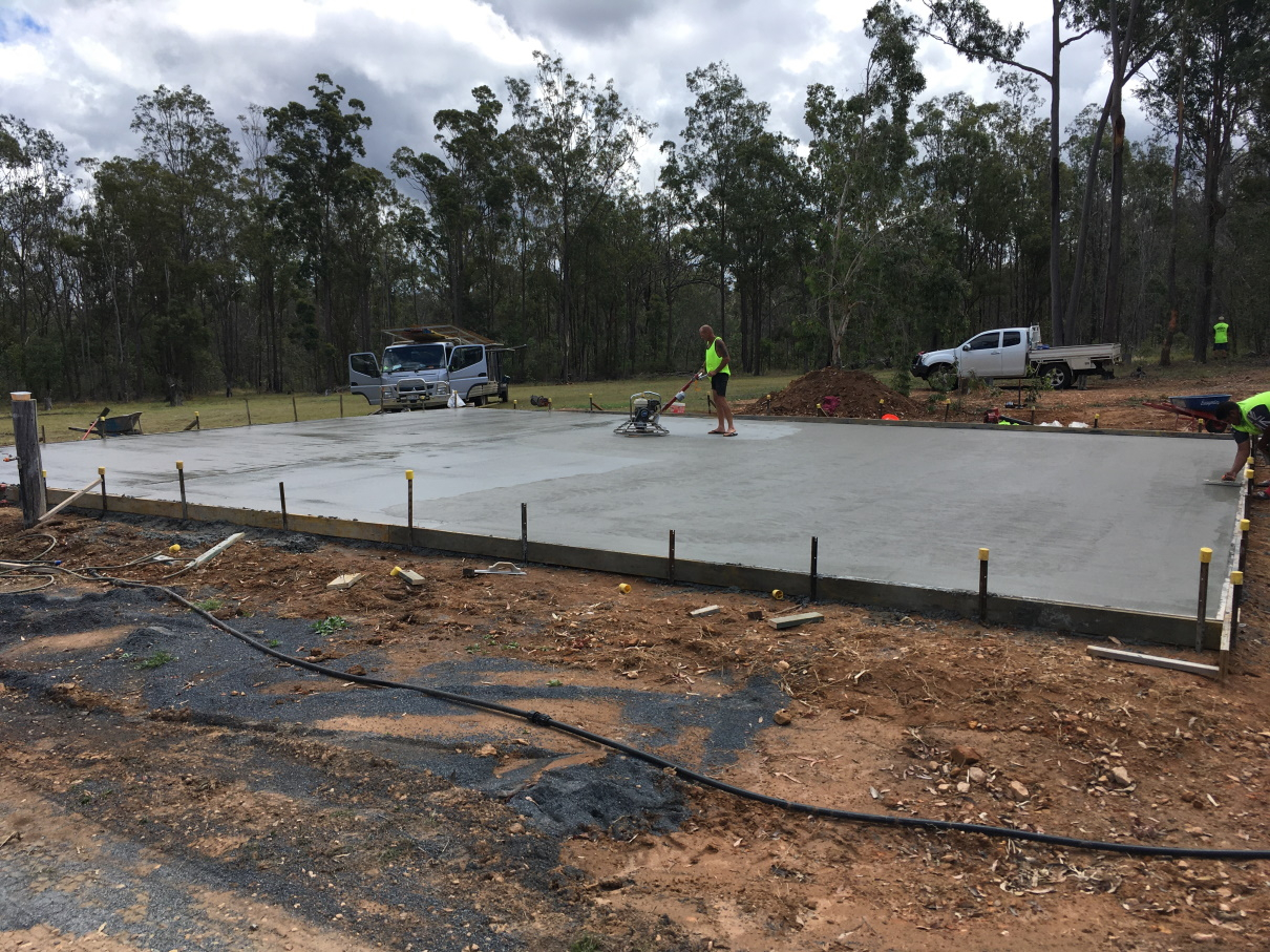

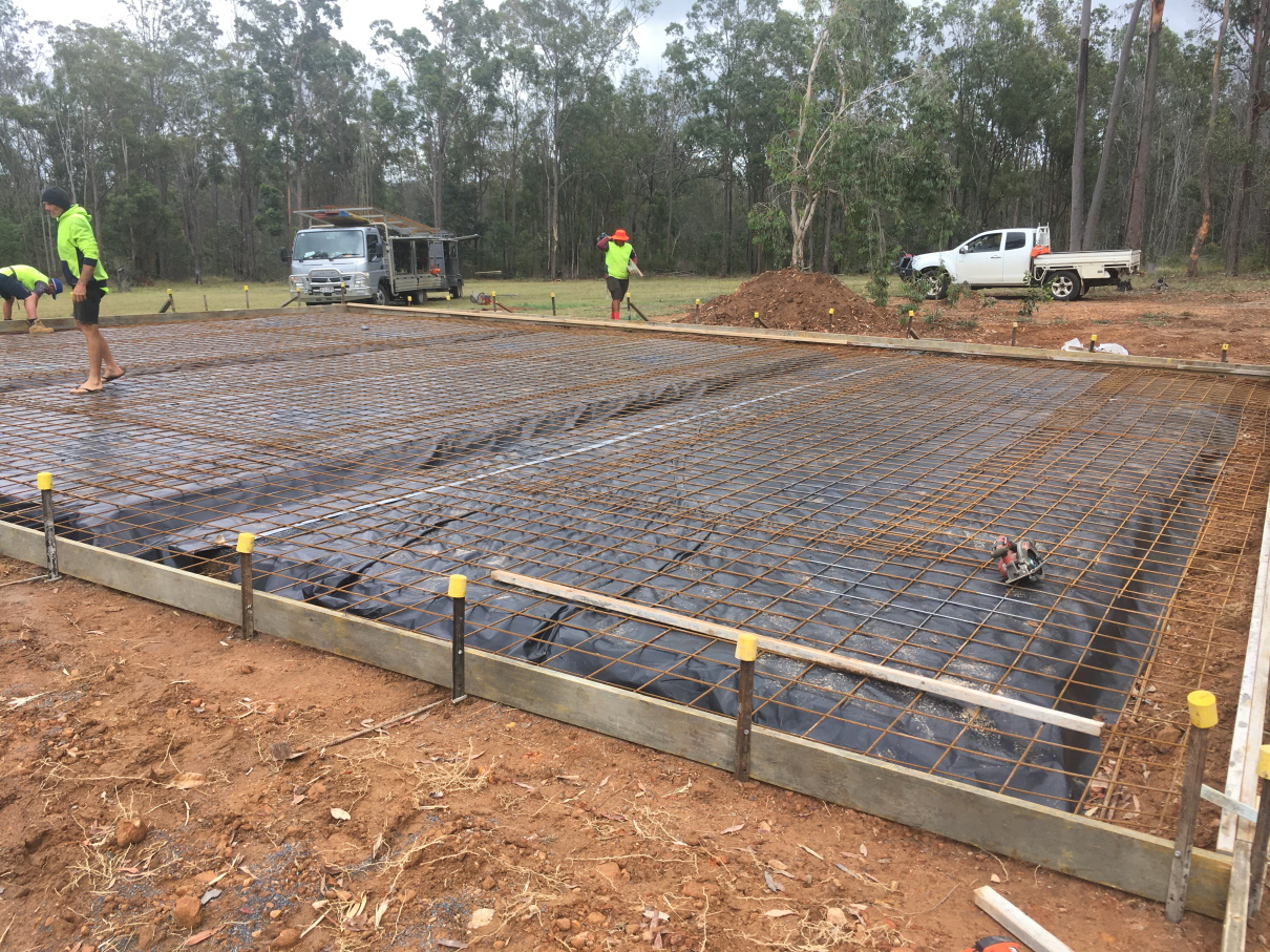

View attachment 730792View attachment 730793
Nice building!!!
I've never saw a concrete worker in sandals!!!!
I've also never saw border forms with the bracing sticking above the top of the form. That makes screeding much harder to do.
