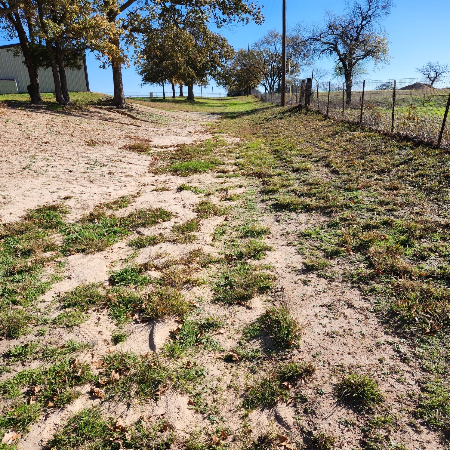

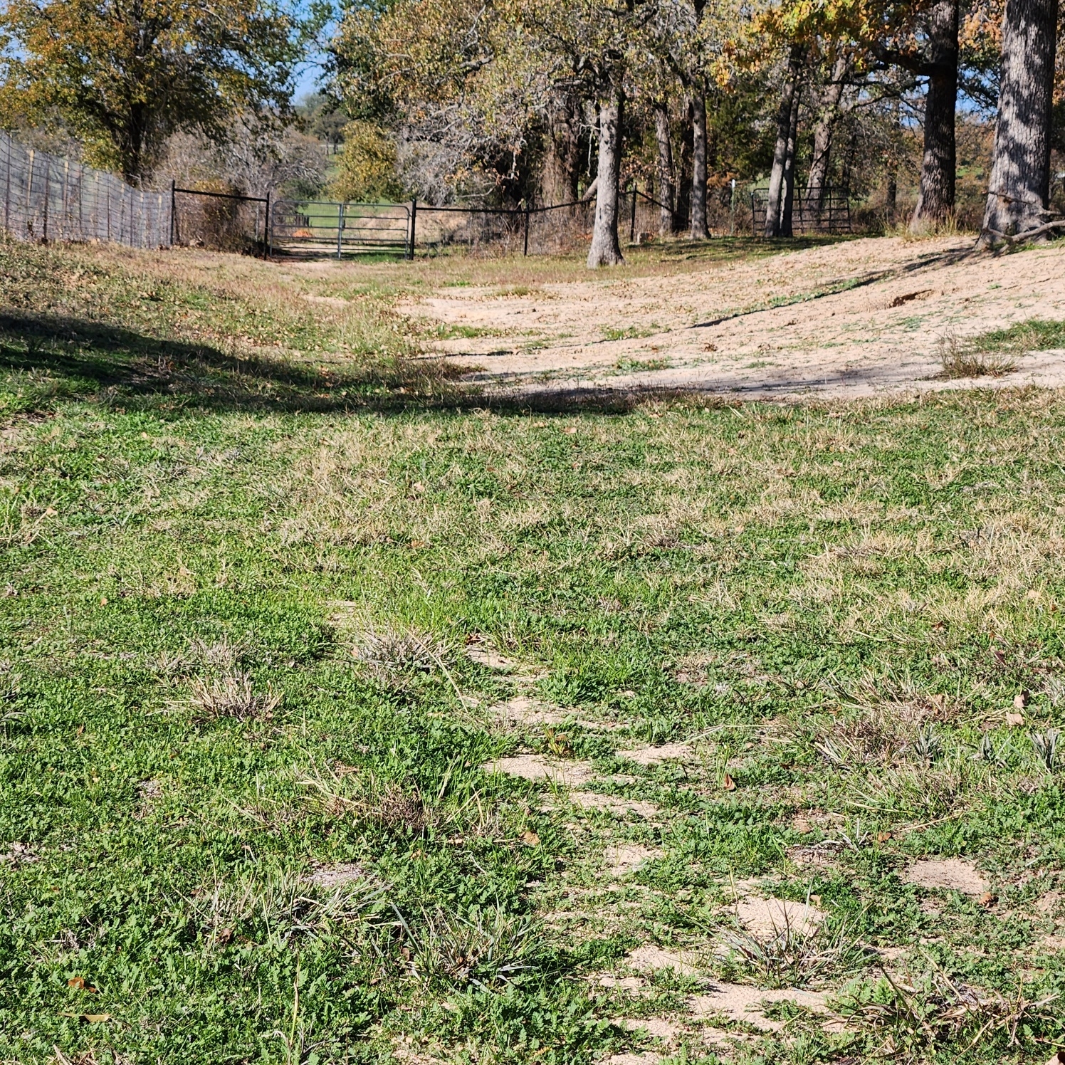

Slopes are a problem with tractors. You are wise to approach them carefully. On my land, I rarely drive across slopes. Some do. From your picture I would feel more comfortable driving straight up and down. Remember to keep it in 4wd when coming down a slope; tractors only have brakes on the rear wheels, and having it in 4wd connects the front tires to the rear. That reduces the chances of sliding or creating a runaway downhill - which is something most of us have done..... once......
For the same reason, I don't like to carry a load in the bucket when driving down a slope. I simply do not want to do anything to lighten the rears or reduce their traction. If I absolutely have to carry a load down a slope I often back down, in 4wd, and slowly.

Made it about 1/2 way through posts, but. Loaded tires can be good, but they are loaded, and can't be quickly/cheaply unfilled/refilled, so a 6 ft box blade might be a better choice and or wheel wheels.
Since you mentioned slopes and erosion, you can be 100% good on a slope, and a tire hits a fairly minor, hidden, wash out, and go from stable to not very fast. Let's say 15% cross slope, run into a 8" wash out with the down hill tire, and suddenly your at 29%. Not trying to worry you, just be careful.
