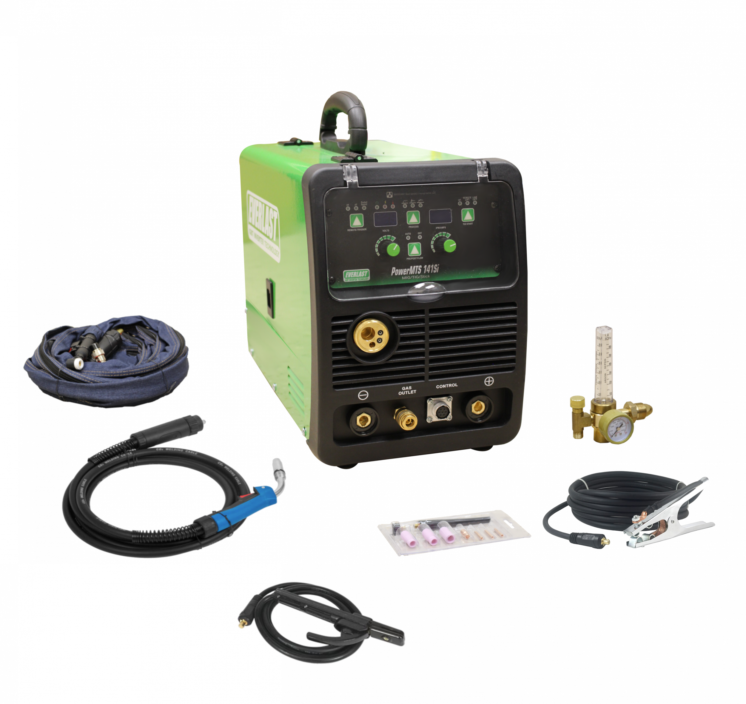

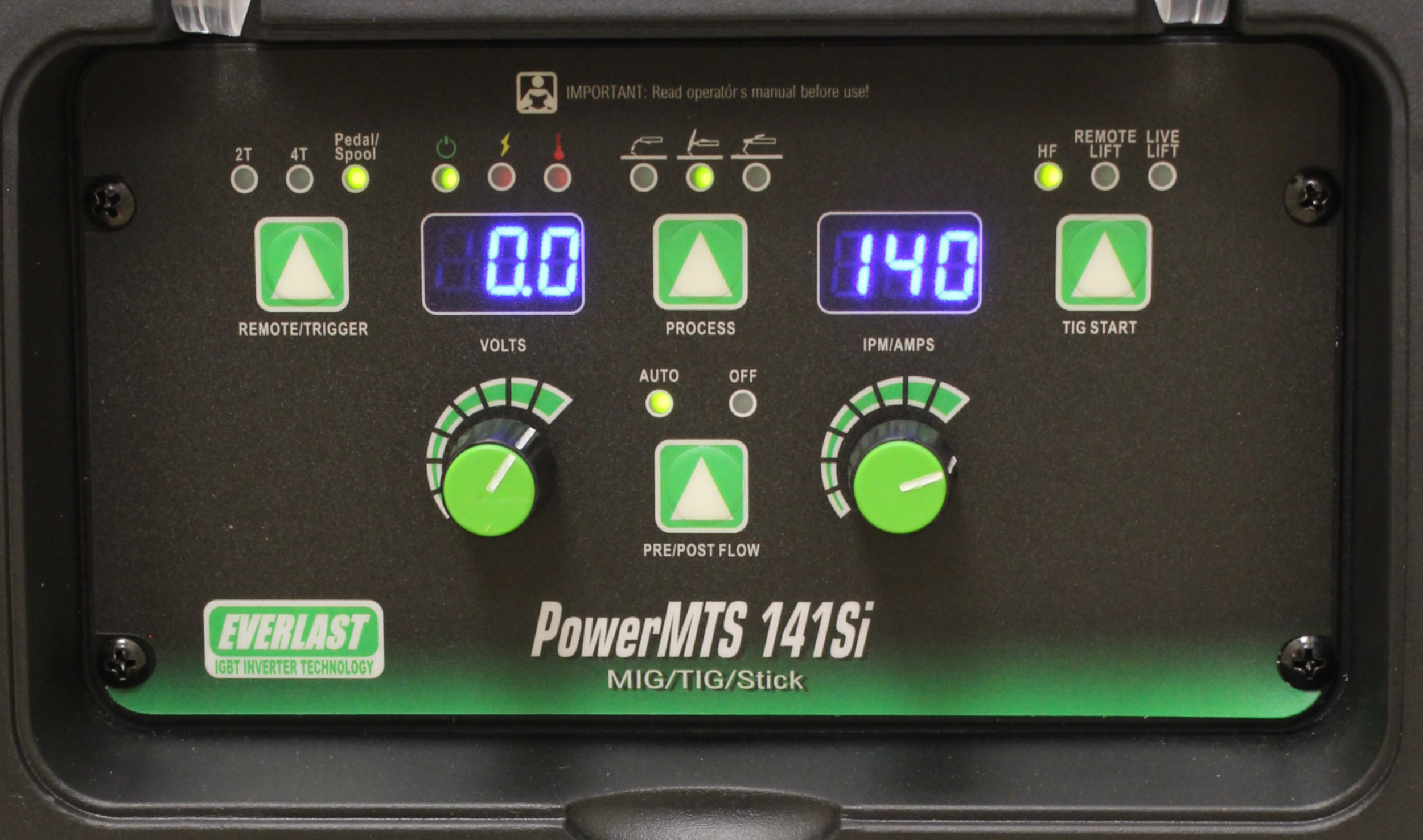

Yes there is. It's a new unit called the PowerMTS 141Si. But it has HF start capability and a foot pedal option. More advanced and better warranty. Built-in gas solenoid for TIG. Even Separate gas inlets for mig and tig. In stock. Give me a call. https://www.everlastgenerators.com/product/mig/powermts-141si

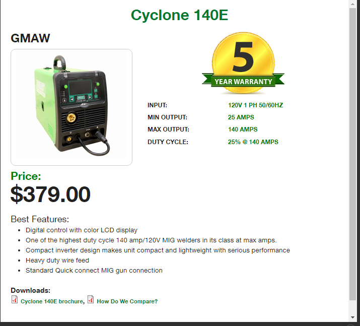

Something in the 140 range should suit what you want and price range... I have some of the Titanium offerings from harbor freight and they're treating me well even though I have the 170 and 200 but still, I've beat the everliving snot out of the 170 since I basically stole it (open box sidewalk sale on Sunday back when that meant half price, $125 out the door...)... I have no doubt the 140 offerings from Titanium or Everlast would do similar as I don't push the limits that hard, I'm usually running off of a 15A 110V circuit or a 4kw generator or something dumb with flux core, but have wicked it up on 220V burning in 1/4" plate real nice too... If you're stuck with no gas that's basically limiting to flux core which isn't near as bad as what anyone says, it's just not as pretty... it's more like a glue gun with 6011 rod... takes some getting used to but I have no complaints... in the next couple months I will be upgrading to welding with gas on my 200, I have a spool gun for it and hope to TIG some stainless tubing and gear up to do some aluminum welding on my boat...
/ New inexpensive trimode welder #40
There's a big difference in the Titanium and the Everlast. Starting with warranty. And ending with design and quality of internals.
