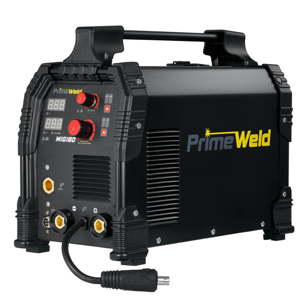

well now this looks interesting if I really can ditch stick:
says made in USA, 550 entry point. Not bad. Costs twice as much as imported because we pay our people better. I'm ok with that.
lots of 300 dollar alternatives on Amazon, keeping in mind California's good experience. I've bought lots of HF stuff too, not usually what I would ever consider "good tools".
But if I need three different phillips head screwdrivers, they all don't have to be the good stuff. My favorite tool, the most used one, now I just might spend little more on that.
I actually just bought this unit a few weeks ago. I had a Millermatic 185 that was a very nice welder. I really wanted a plasma cutter and a tig welder as well, so I decided to sell the Millermatic and put the money towards the Mig180 and CT520DP (unfortunately not in stock yet). I actually still had money left over after that, so I bought an argon tank. The only reason I got the Primeweld was that in my research for an inexpensive alternative to the blue and red machines many on the welding forums recommended Primeweld. They are based in NJ and they are very customer service focused. The units come with a hassle-free 3 year warranty.
So far I've only used it once. I like that it has actual values for voltage and wire speed unlike the Millermatic, but it will take a little bit for me to get used to that (It comes with a large sheet with what voltage/speed for what material and thickness). The Millermatic had arbitrary numbers to indicate voltage and wire speed and I got used to those settings. I also like that you can use 10lb spools in it, as that is what I have.
It does come with a stick welding stinger, so you can still do stick with it. You can do flux core (gasless), which for most applications under 1/4" (and some applications over 1/4") it replaces stick. It comes with the spool gun for doing aluminum. My Millermatic had a spool gun as well, but I never used it. I just never had a need to weld aluminum. You can also do the MIG with gas which produces a nice clean weld (no slag).
A side note about the Millermatic, I bought it 7 years ago for $850, and sold it 3 weeks ago for $1300 with many people contacting me. So for less than what I sold a 25 year old single process blue machine for I bought 2 machines that can do 4 processes together. And they will take up the same amount of space together than the old blue machine. The MIG180 is far lighter and more portable than the Millermatic 185 with similar specs. That's where inverter technology beats out the old transformer technology.
