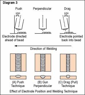

Am I supposed to push the gun into the weld or pull it like I would a stick electrode? I had a hard time trying to see the puddle.
A lot of people will say it makes no difference, I'm like Mark, with Mig I push, with anything that produces slag I drag.
Here is a good chart by Miller.
