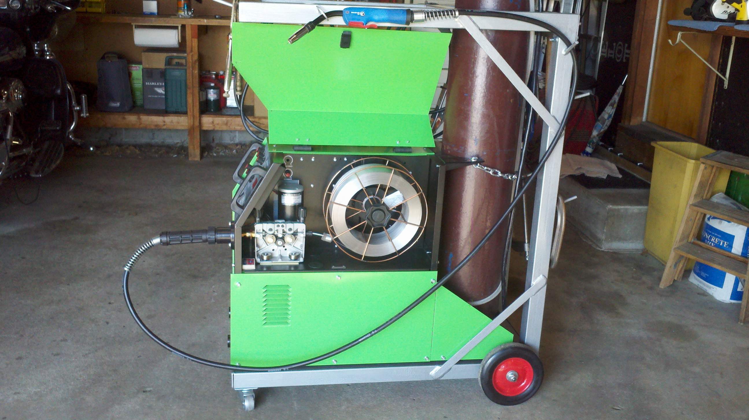

Delivery was delayed due to the extreme weather throughout the mid-west, but I was informed by UPS tracking. I received it yesterday afternoon and unpacked it today.
I ended up buying a small cylinder of C25 from the local supplier for $180 filled. Later fills will run $35. Picked up a roll of 0.030 (I think it was about 11 pounds).
I'll upload some pics shortly but I was pleased that it came with the plug end already installed and included a 110 to pig tail adapter. I was expecting to have to put that together. No sample wire though. I thought that would have been included but that's ok. I'm just glad I bought wire.
Any way I hooked everything up, pressure tested the gas and found a couple of leaks and corrected those. Then I tried to weld and no spark!
I came in the house and looked at some vids on Youtube. I had plugged the work clamp into the negative and plugged the mig gun into the right port but I did not connect the other plug to the positive ! Oh well I'm heading back out to the shop to plug that in and try again.
I think the instructions could use some work. The usual Chinese English translation. Also, it should describe how to set it up for MIG and Stick and show exactly where to plug each thing in with actual color photos, not diagrams. But these things are easily overcome.
Pics will come later tonight or tomorrow as I have only a few minutes to try it again and then I have to go out of town for a few hours. I'm really happy with it so far!
Edit to add: That was it. I didn't have what they call the "Output Cable" plugged into the positive. Mark called me just as I was trying it and confirmed that was my problem. I put down and ugly weld and then realized I forgot to turn the gas on. Then I put down a less ugly weld. That was kinda stupid, but you gotta laugh at yourself sometimes. :)
