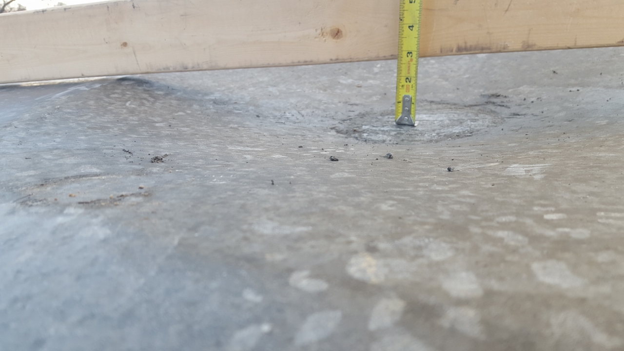

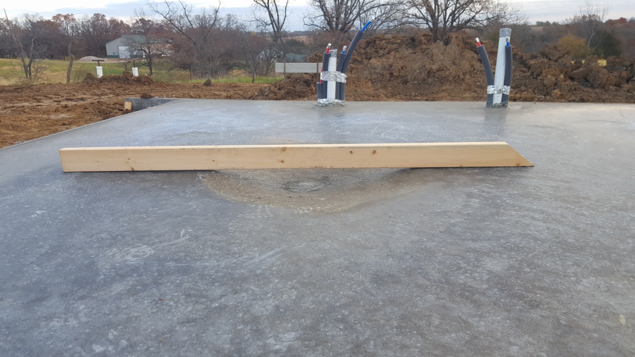

I agree with Heath, put in an adapter to get it up to where you want it then possibly use some shower pan concrete mix to taper it down.
What are you putting over it for flooring?
That's the issue. We are gonna try sealing the concrete and living on it.

I think I'd follow the above advice to raise the drain and use concrete or 'leveler' to bring the floor to the desired height/slope and then tile that room with ceramic tile. A good tile guy can cut in tile on angled surfaces to make it look great. And that eliminates the aesthetics aspect of the patch. Yes, it will cost more, but with that solution you will avoid the problem of walking in there daily and wincing at the visible f-up for the rest of your time there. Sometimes taking the pain up front is well worth the price compared to a daily reminder of something you hate. It's one of the reasons I only buy decent cars because I spent plenty of time with old stuff that I hated walking up to in the parking lot every day. Life's too short to be unhappy.

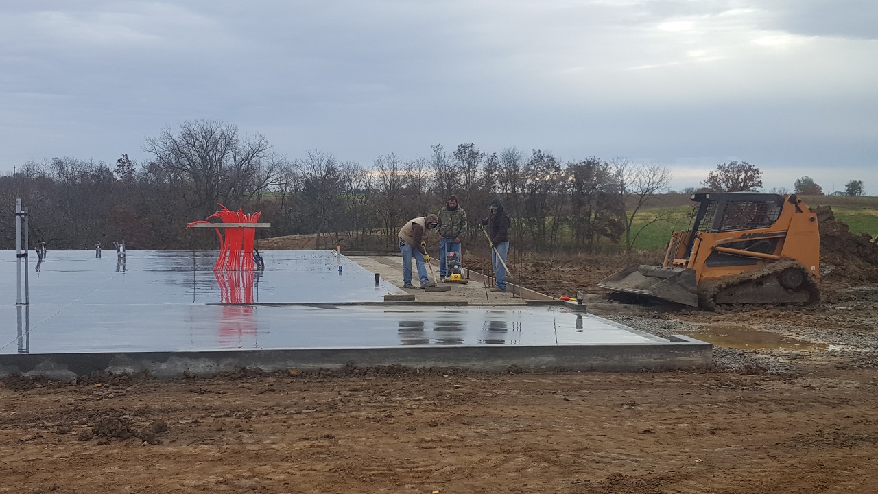

They poured our front porch today. Stamped and dyed it. Here's a pic in progress. I'll post the finished project in a couple days.

Congrats on the build. that stamped porch floor is very cool. You'll love the heated floors, we have radiant in our 2 story house and the basement floor is always toasty in the winter.
As for the laundry room, is it possibly to bring the drain up a bit more than you originally wanted then add concrete to the whole room so it's uniform or would that screw something else up? Just a thought.
Looking forward to seeing more. Oh, one more thing, your master bedroom is kinda far from the fridge. :D

Terry an I were just looking at it. I'm in favor of leaving it alone until the build is done. Then seeing the room complete, make a decision as to a remedy.
While you may leave it alone for now, it will be tripping hazard. Here is how I would deal with this issue. Dig out around the drain and find/make fittings to raise it up to the appropriate height, as discussed above. Use a diamond blade saw and very carefully cut a square or diamond around the bowl that was left by the concrete guys. Only cut to a depth of 3/4" or 1". Remove the top surface of the concrete within the square from the bottom of the saw cut and taper it down to the current drain. Leave a rough surface. Clean with a pressure washer. Apply a bonding agent and use a mortar for old style shower pans to fill in. A hand trowel will be able to provide a polished surface similar to the rest of your slab.
