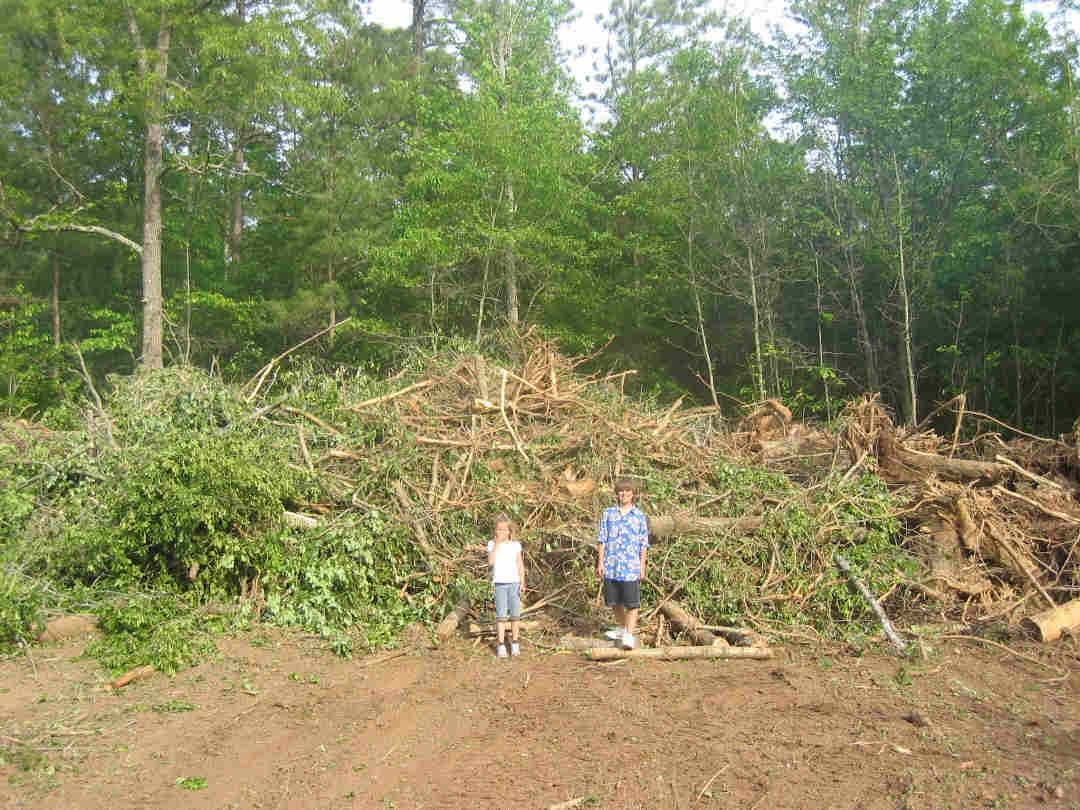

Before I call it an evening, I thought I would refresh your memory about the size of the brush pile we had after clearing the building site.

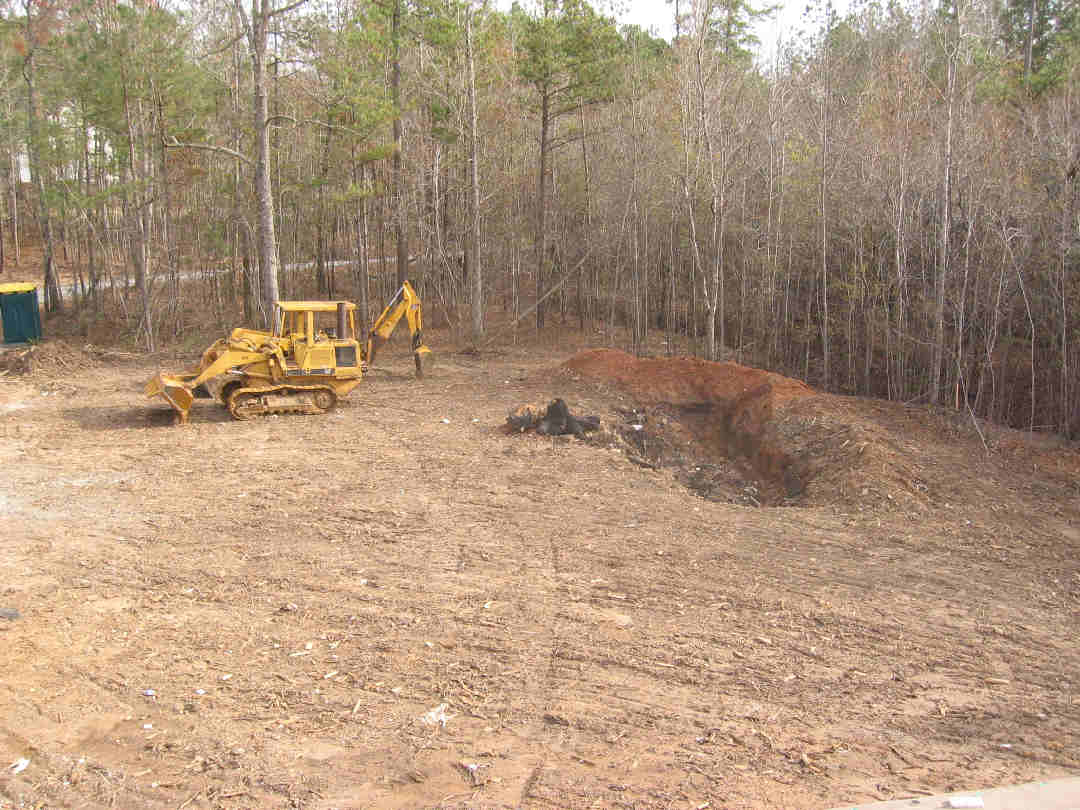

And here's whats left after the burn. As you can see, with the exception of the one charred stump that has been removed from the pit (to the left of the pit), we had a near complete burn of everything else. The trick, according to the excavator who did the burn, was to dig a hole first and do the burn in the hole. He said that had we done a surface burn, it would have (a) taken alot longer and (b) not burned as completely. Also, it didn't hurt that the brush pile had about 7 months to dry out.
