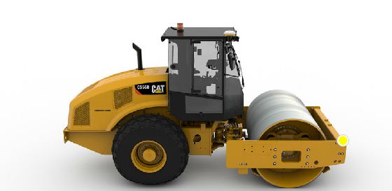

Yes, the excavator brought in nice, clean, compactable fill, brought in a vibratory roller similar to this:
and rolled it a lot in 8" lifts. He only brought in enough for now to get about 1/2 way there. The goal was to get the footings in. He then dug out the trench for the gravel for the superior walls (poured concrete for the main house portion, stone for the garage). The bottom of stone elevation for the foundation is only 9" above current grade the garage floor is then about 3 foot above that.

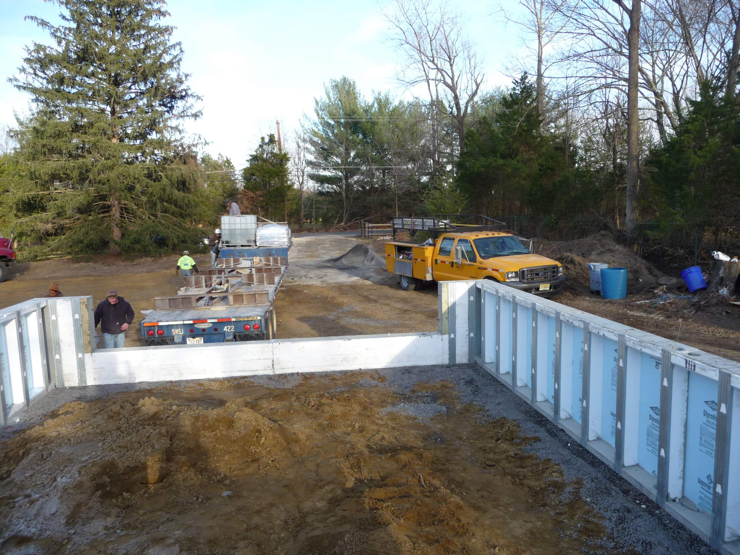

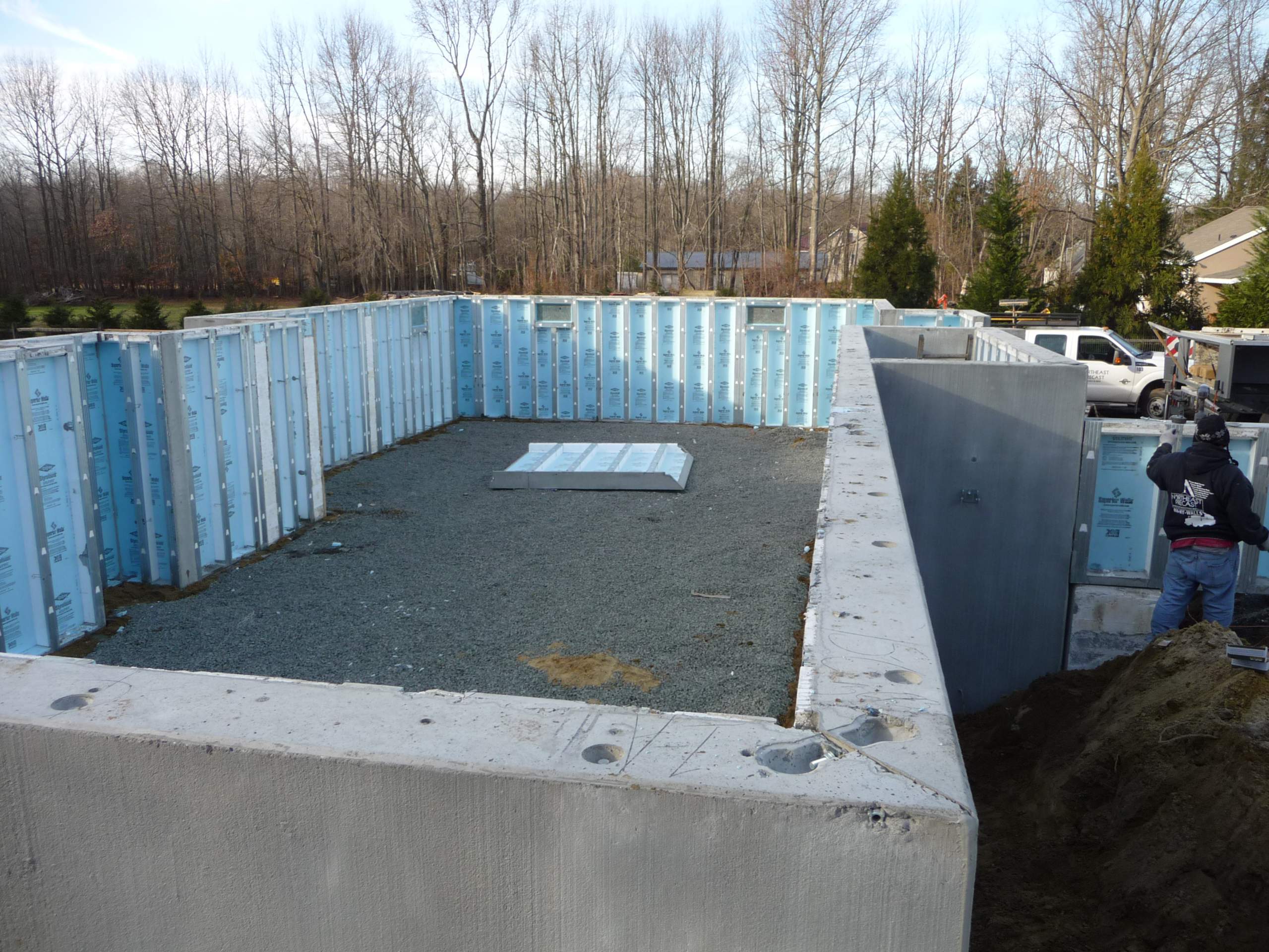

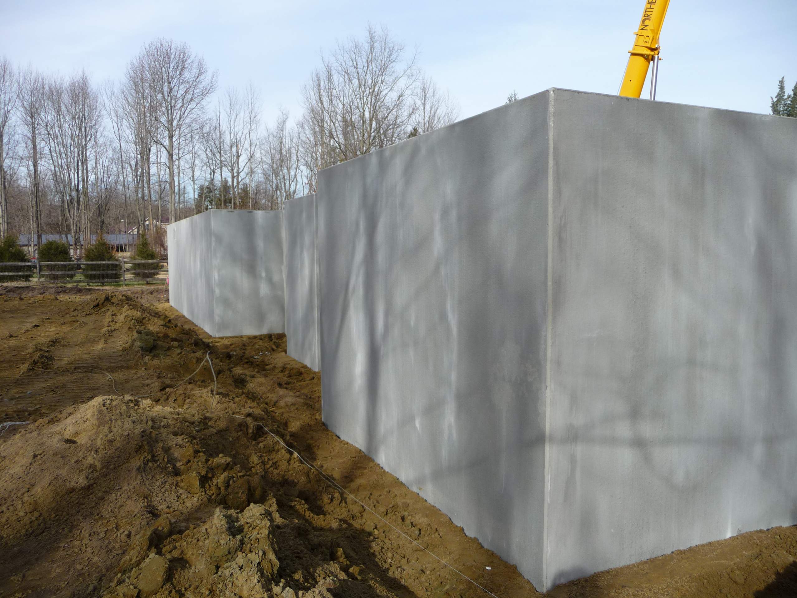

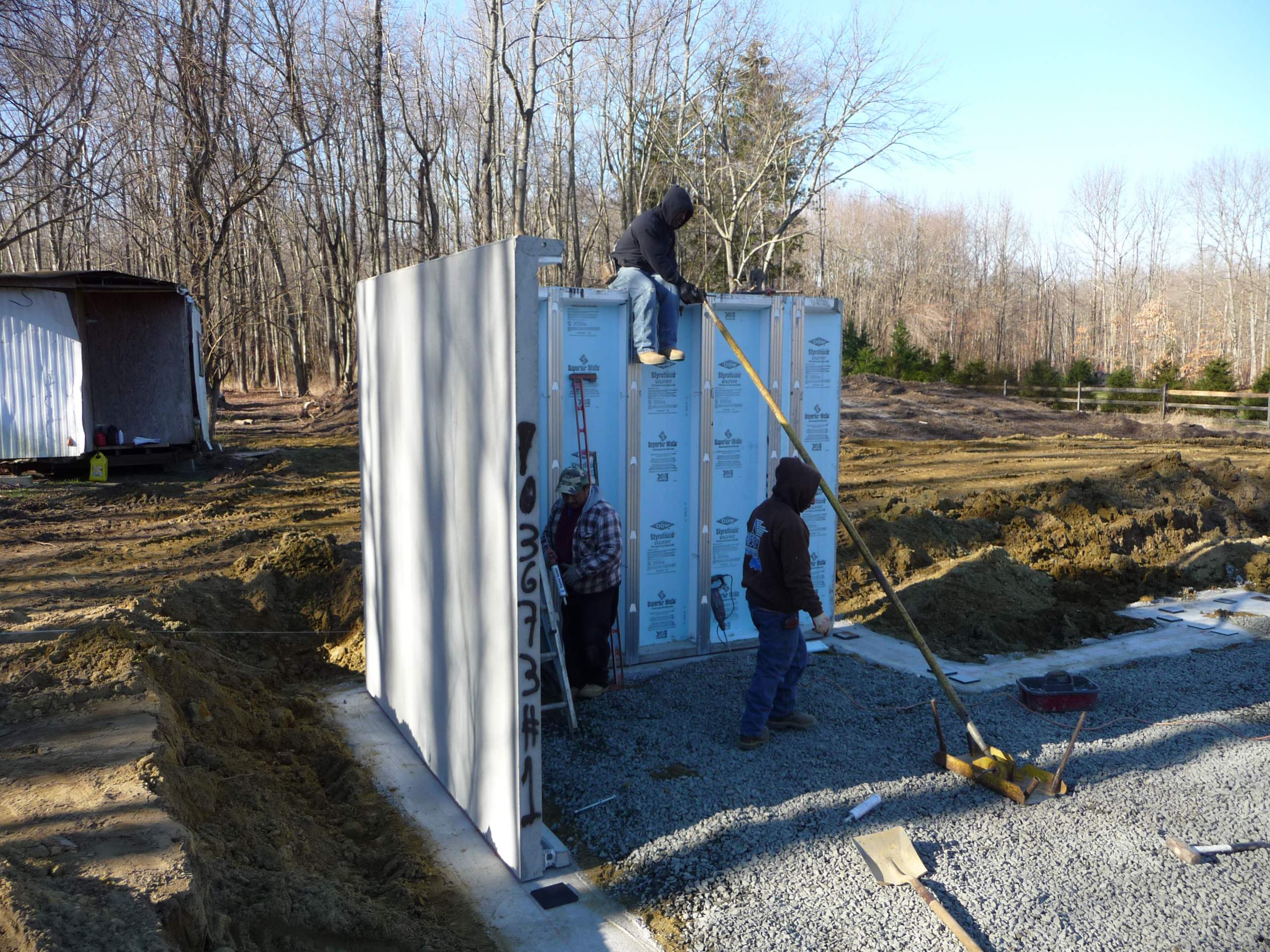

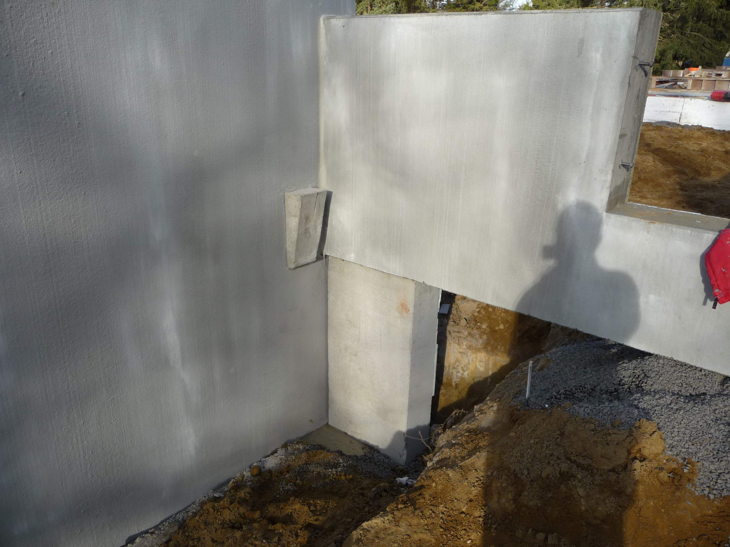

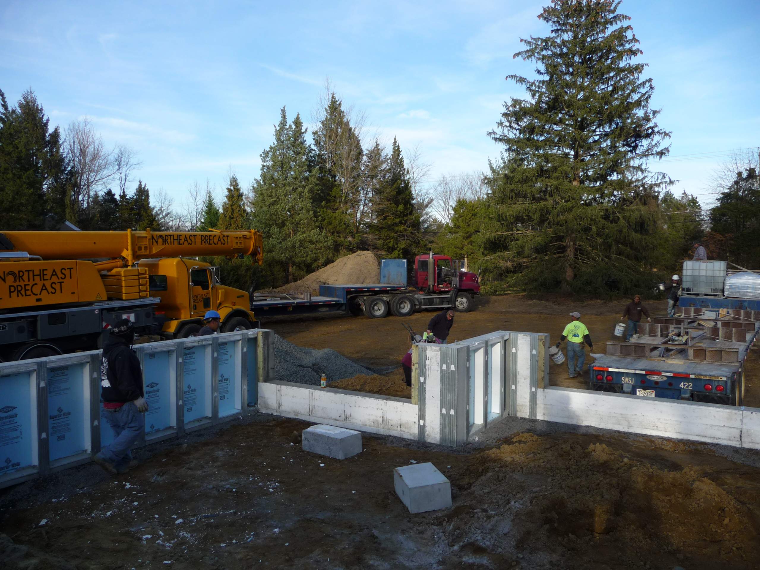

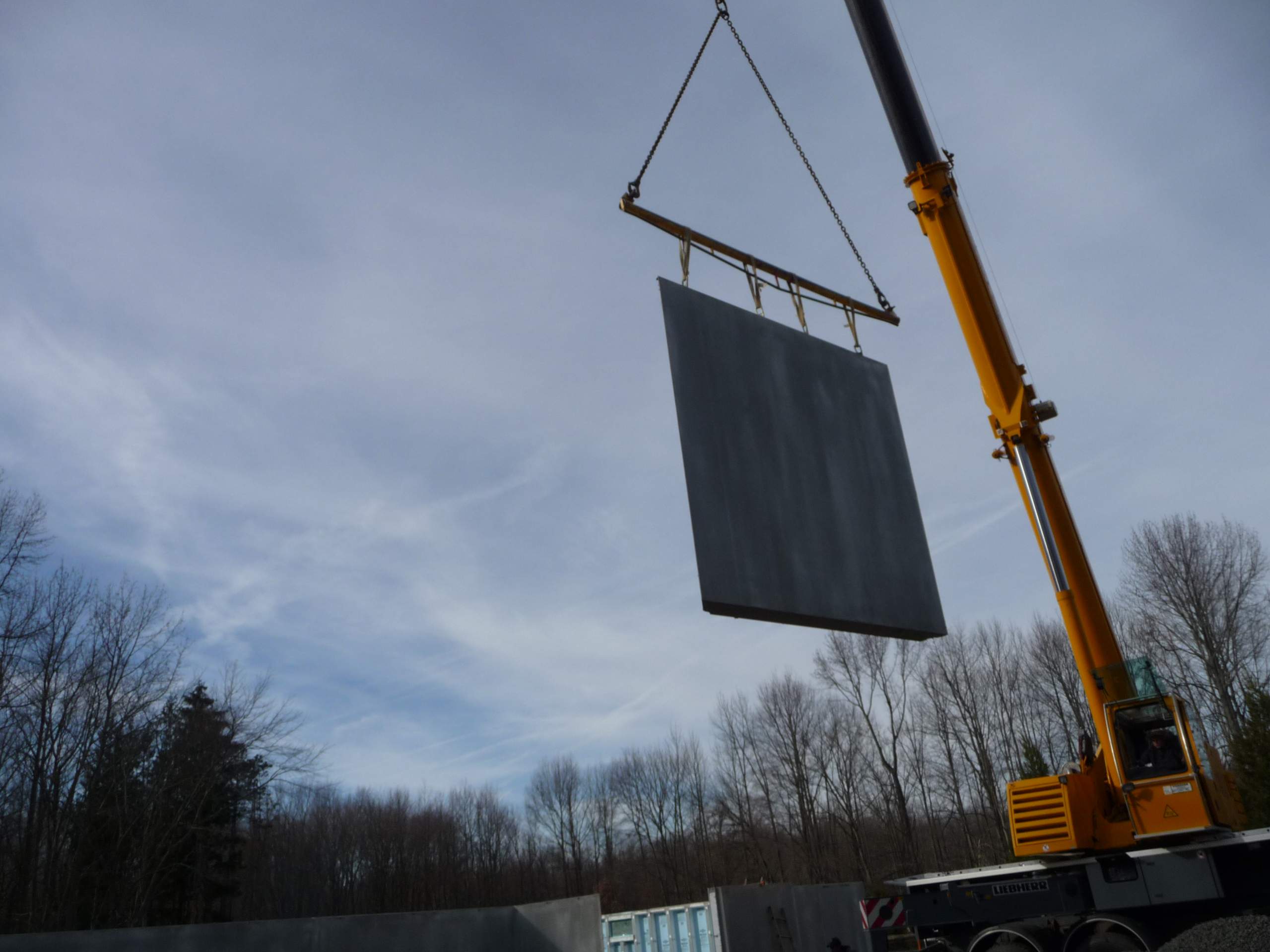

Today was the day we were looking forward to. The basement walls were set!! We were one of two jobs being done today, however; the crane's pump broke at the other job site, so that crew came here to help out. They were like a well oiled and orchestrated machine.
Three tractor trailer's worth of 9500 psi panels. There are a lot more pictures but here is a sampling!

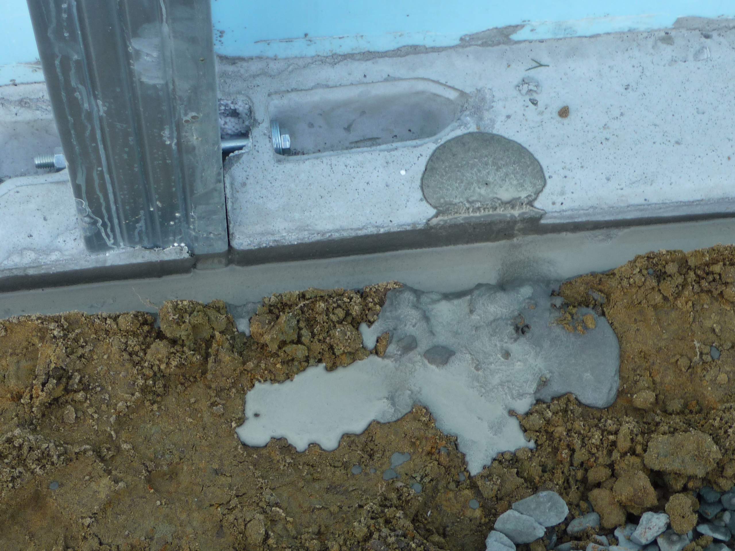

What was the purpose of the little square pads they set the walls on? Are they still under there and how do they seal the bottom joint?
/ New Home Begins
#179
The pads are dense ABS and are shims as no footing is ever exactly level. They do not use steel as it will eventually rust In fact, they take the high point and still add shims under there. They want a small gap. When it is done, they build a little dam both inside and out and pour a 5000 psi non shrinking grout into all around and let it come out the other side, insuring that the gap is completely filled.
Here is a picture showing the gap and they have poured the grout in. The depth of the grout is about 2". After they completed the inside, they inspected the outside to make sure it was completely filled and added more where necessary.
Keep in mind that if this was a gravel footing, water would flow through to the drain anyway. This gap is 8" under finished floor ... 4" slab and 4" stone.
