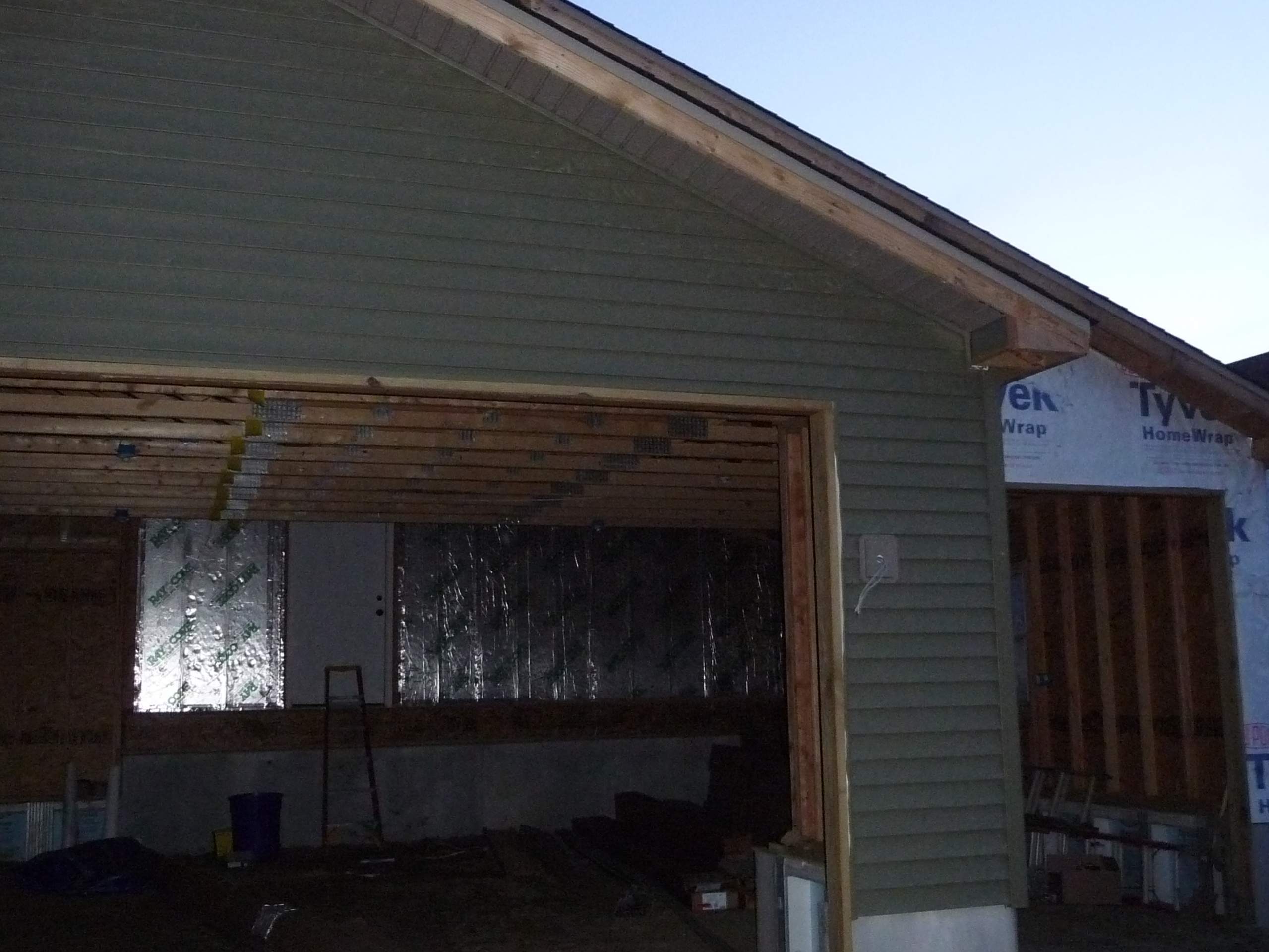

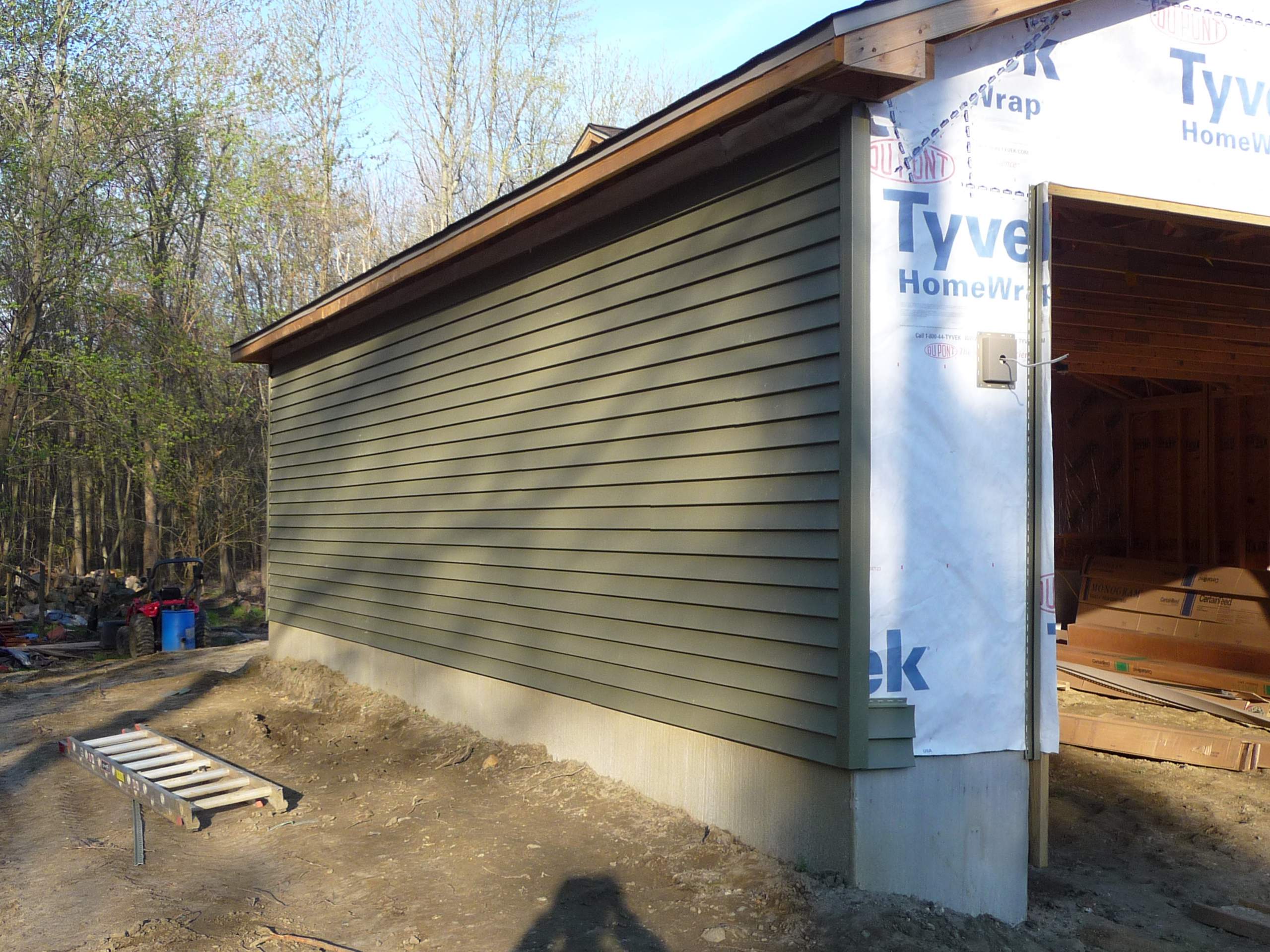

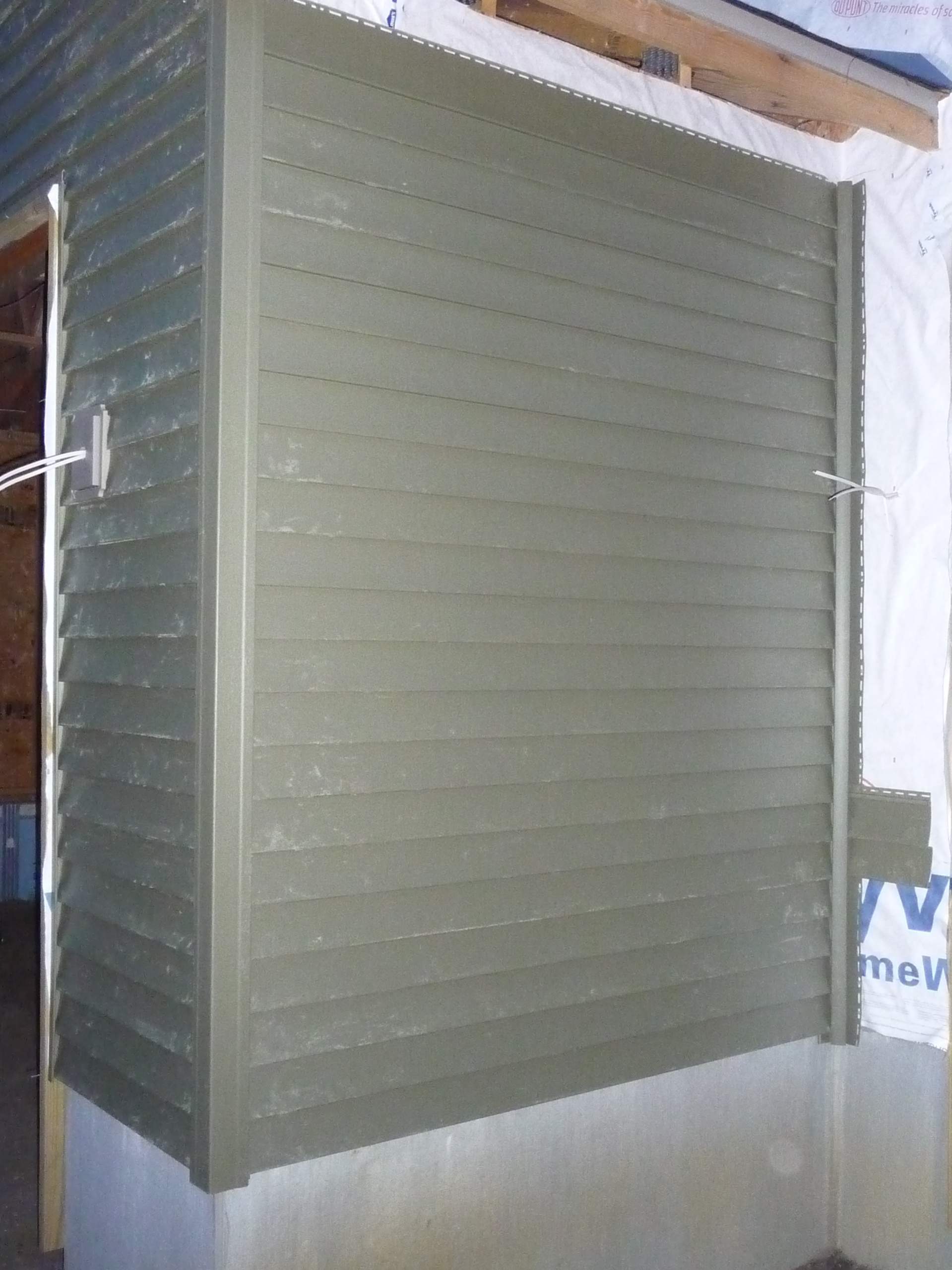

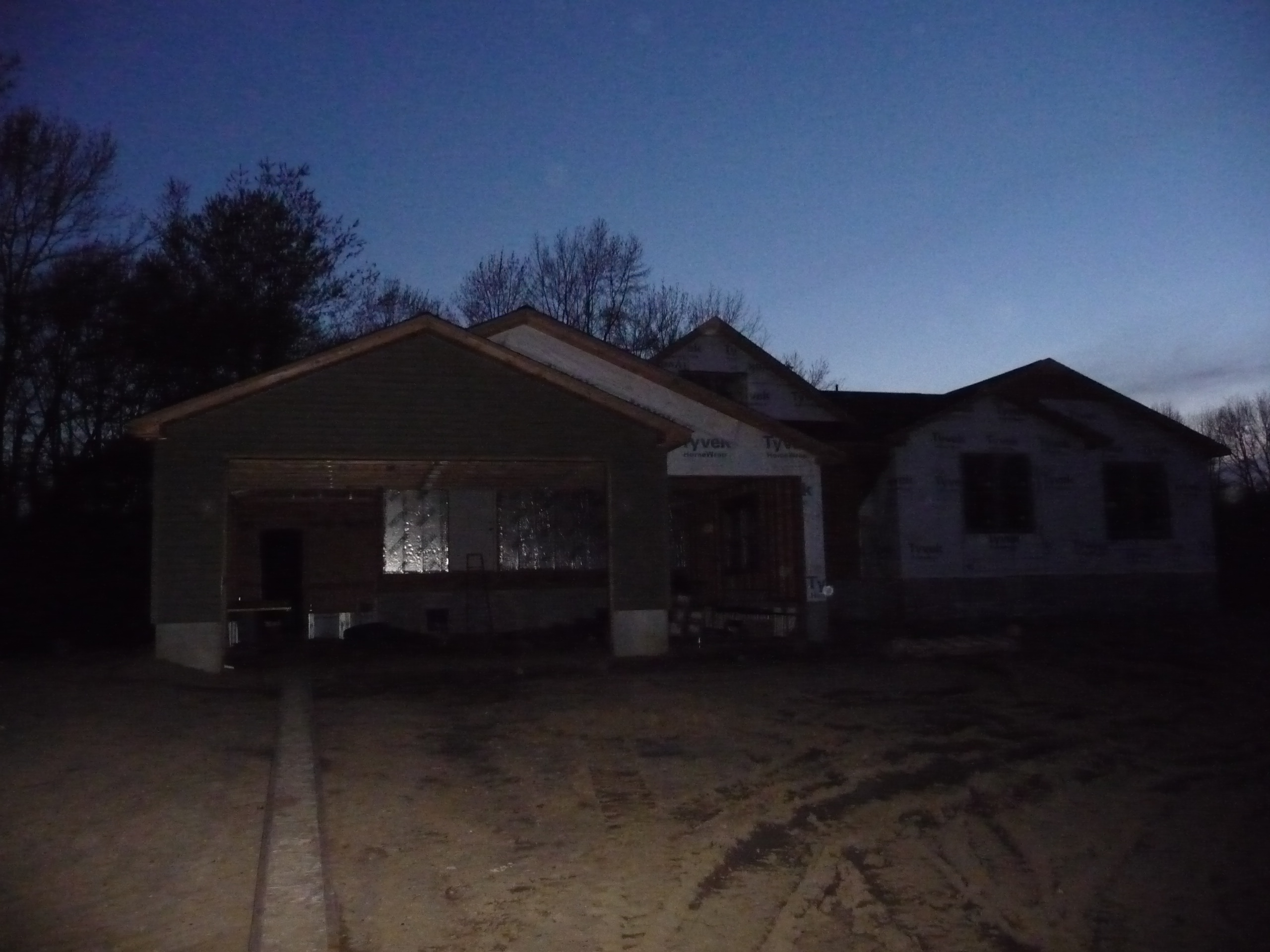

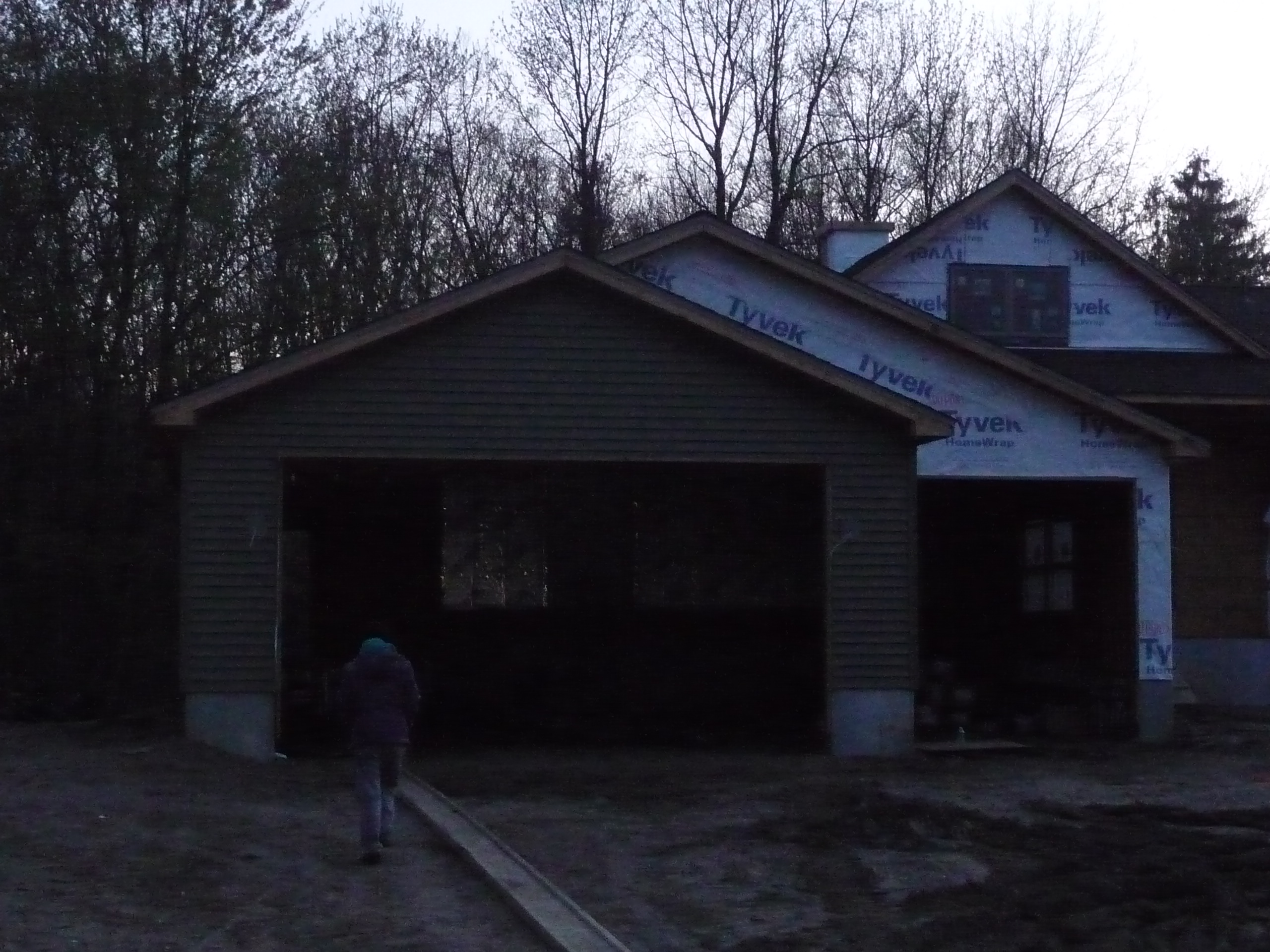

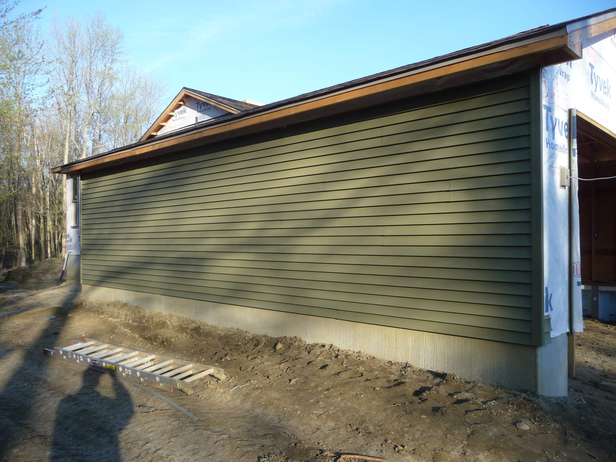

I know it's been a while and we have been busy. Drains are done. PEX lines are in place with only the connections to make. I need to locate an expansion tool. I hate to buy it for $400 to use for 1-2 hours then sell it again. I am hoping that a neighbor I recently met, who happens to work for Uponor, the maker of the pex tubing and fittings, has one he can lend for 1 night.
As soon as the water connections are made, we can go for the rough plumbing. HVAC goes in on May 1.
In the meantime, the siding was delivered yesterday and my wife and I spent a few hours to get some color up!
P1020831.jpg P1020832.jpg P1020833.JPG P1020834.jpg P1020835.jpg P1020836.jpg P1020837.JPG
edit: what looks like dust on the siding is in fact vinyl dust created from cutting the siding with a blade made specifically for vinyl siding. I used to use a fine tooth blade on backwards so it would not damage the siding. I am not sure which I like more.
