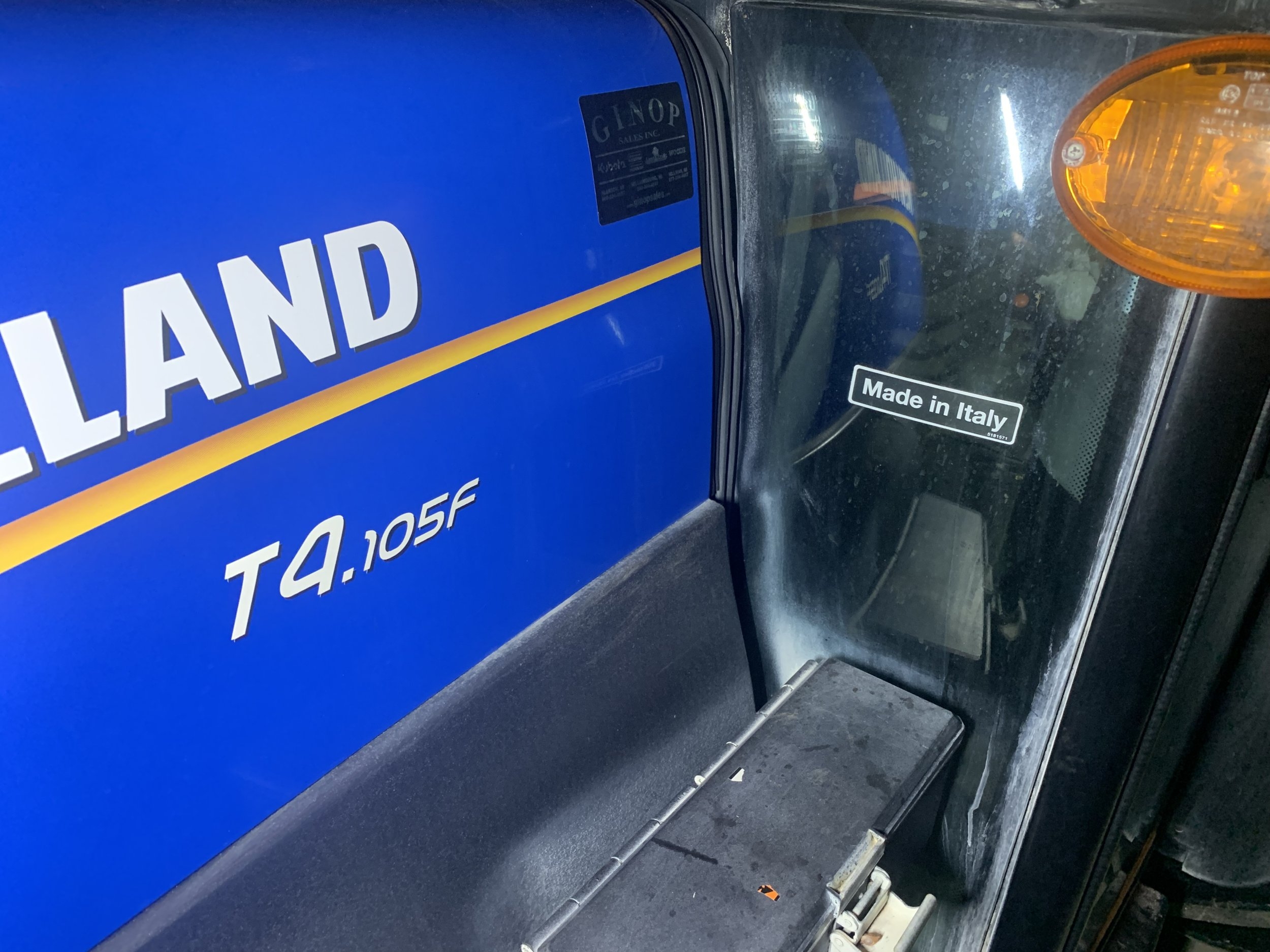

I’m not sure when the t4’s switched to Turkey mfg but know for a fact that at least some of the T.4’s were Italian manufactured. My 2013 T4.105F was;

The specialized models are most likely the ones built in Italy. You simply can't beat Italians when it comes to specialized tractors for orchards and vineyards.
