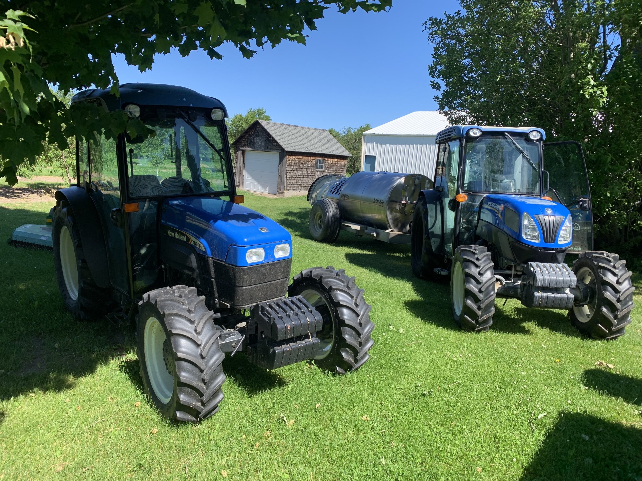

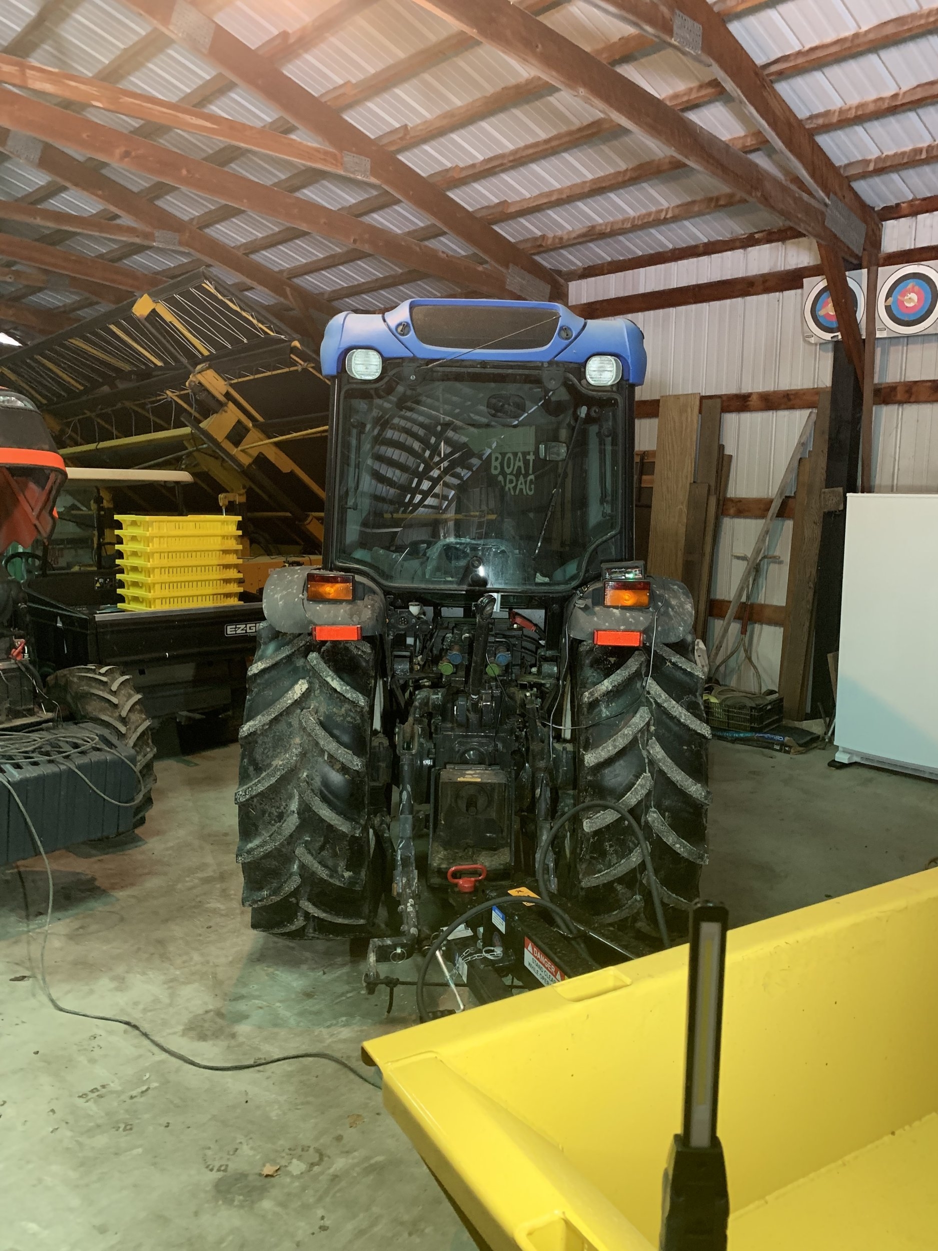

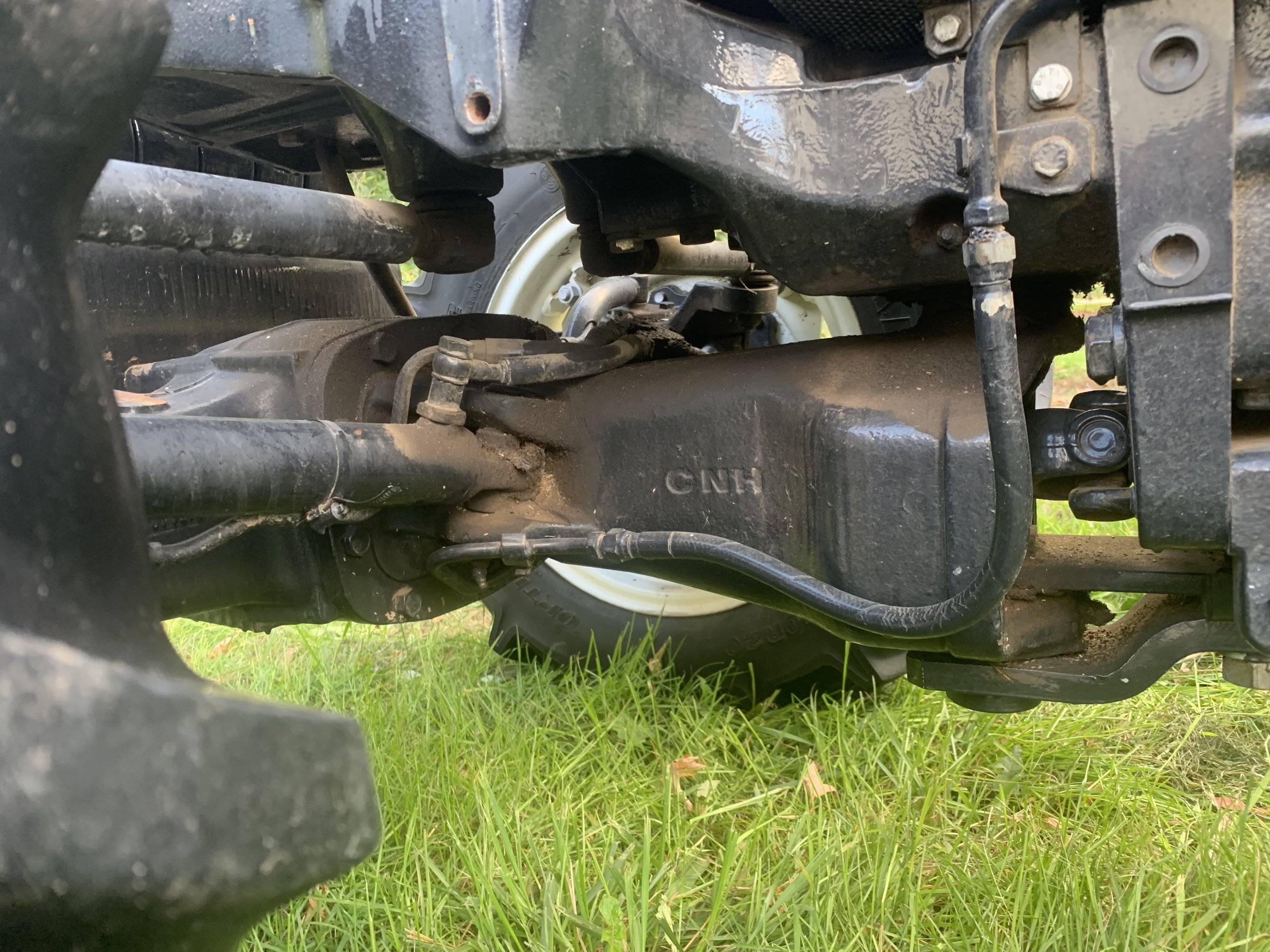

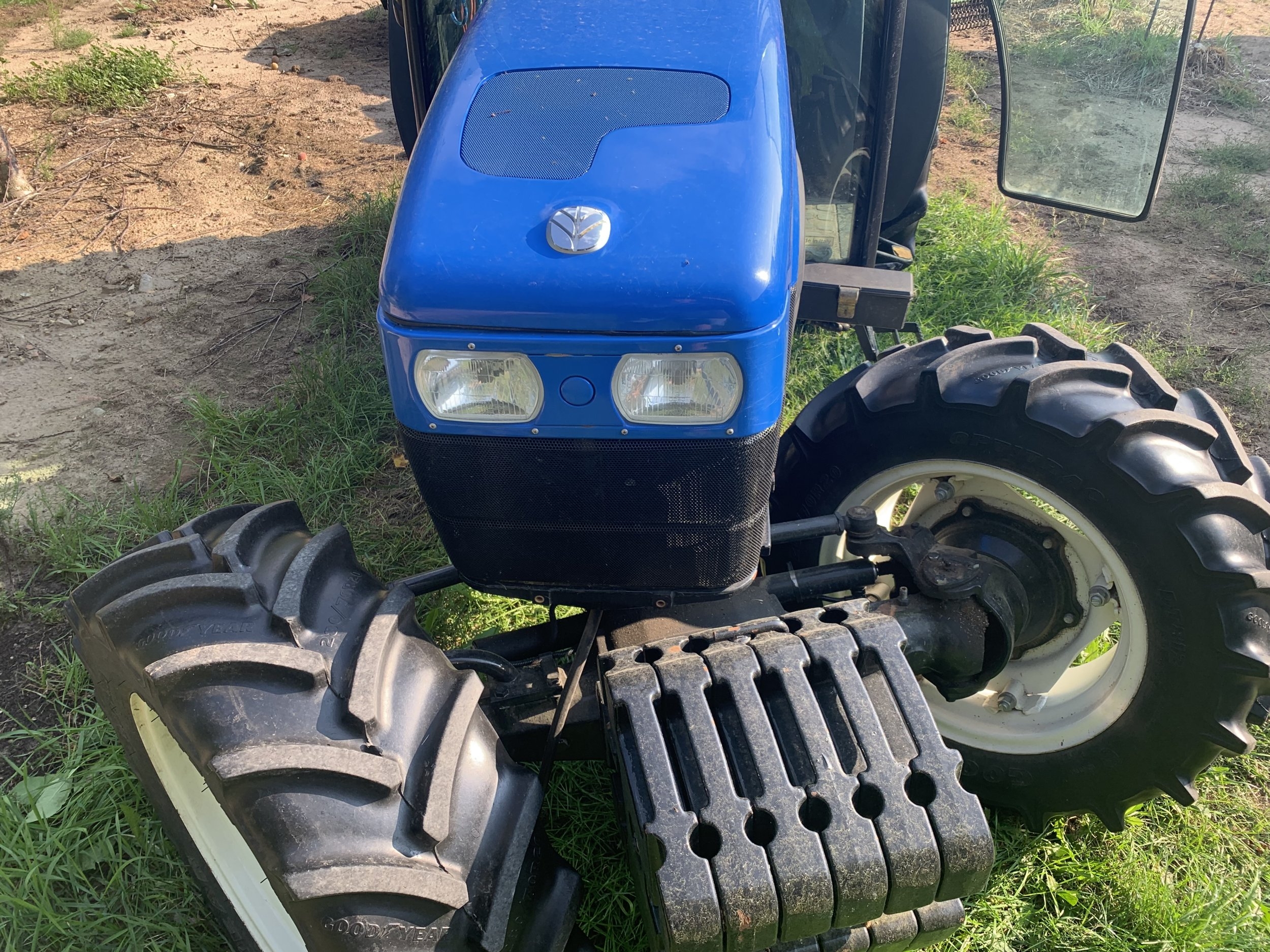

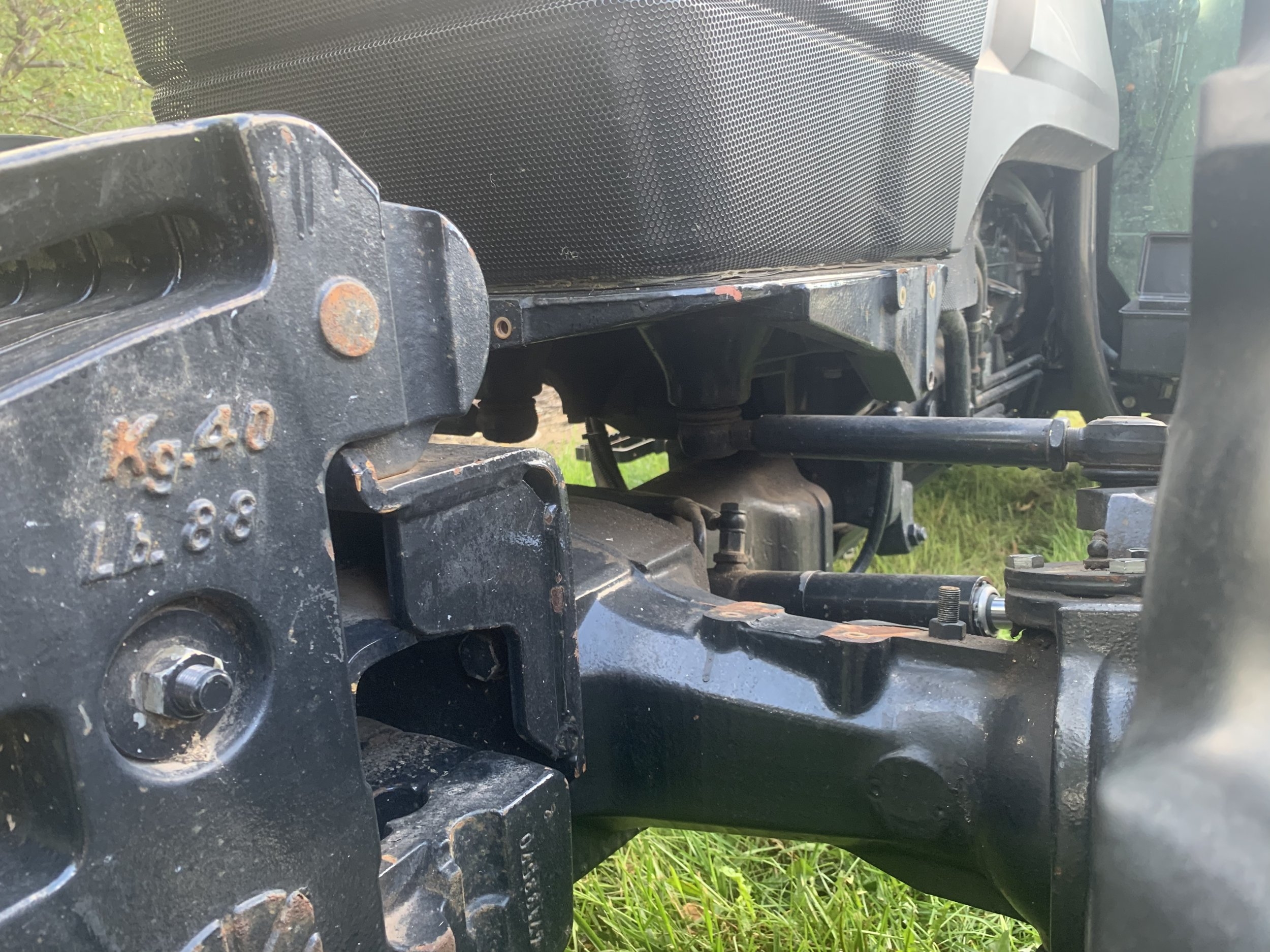

I’ve got two NH tractors with SS. A 2006 tn95FA powered with 3.8L and a 2013 t4,105F powered with 4.5L . The F is their fruit/ orchard model which are both narrow and low. I’ve had no issues with the super steer system and it offers some great advantages for my use. It has a class leading turn radius, it greatly improves the ride quality because the axle is placed further forward increasing the wheelbase by 9-10”. The front suitcase weights are hung directly to the axle , this in combination with the limited slip front axle gives it amazing traction and pulling ability. Unbelievable the snow I can pull a 10k+ fertilizer spreader through. I’m not sure if you’re planning on a front loader but in my opinion I wouldn’t want one on a SS tractor. Because the whole axle pivots there is no horizontal trunion, axle is connected with a vertical upper and lower greaseable bearings placed about under front of engine. In my opinion not the best for heavy loader work.
In my opinion that 75 would have no issues pulling a 8’ blade. I’ve had no issues with vibration, never even heard of any.

The Supersteer system is a very good, heavy duty system. It allows very short turnarounds, but it takes getting use to when used with a loader as the pivot point gives some different feedback.
The system is overbuilt, but needs to be greased as per the manual.
