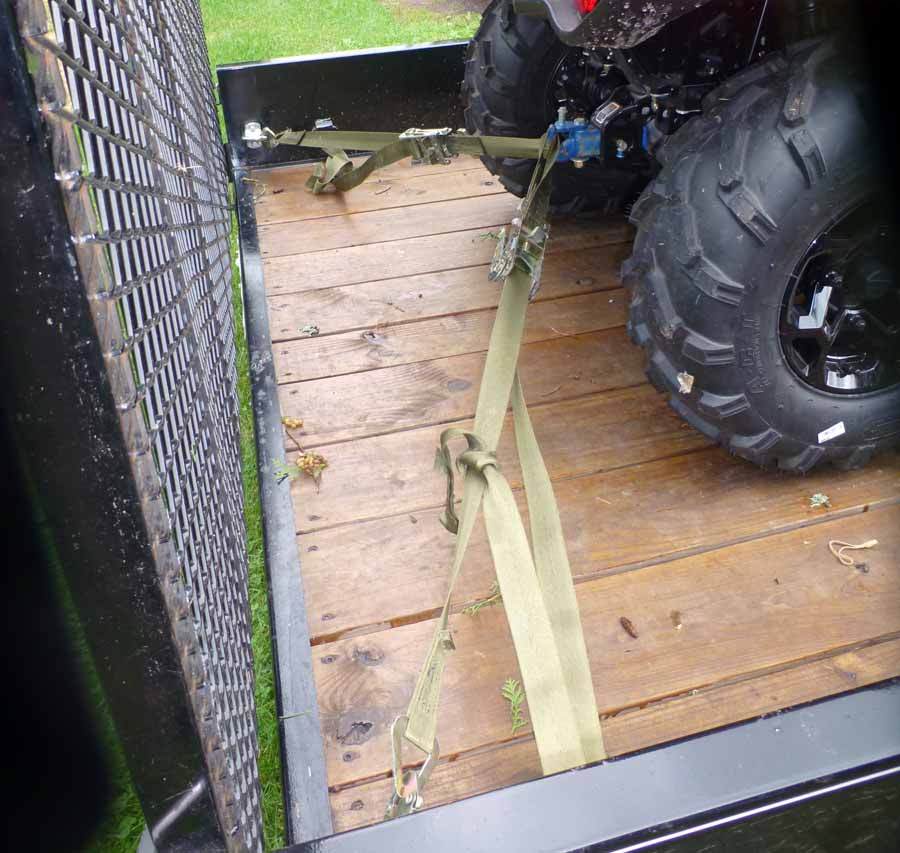

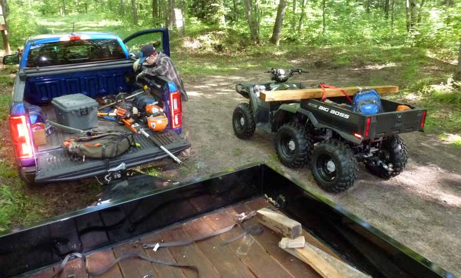

I'm adding 10,000lbs tie-down D rings because the ones DoodLittle added are in poor positions for 6x6 atv moving. Will post pics in time. Although we do like this trailer. (y)

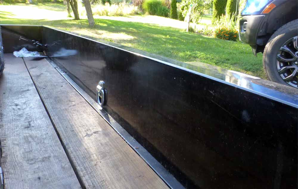

#26

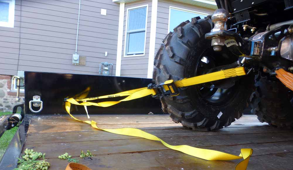

I added 6 extra D-rings to this trailer today. The ones that Doolittle added were in from the corners and not good for tying down our 6x6 and they only added 4 of them. Not sure why they'd put them so far in from the corners as seen in the pic.
Now the angle is a bit better.
More added to the front.
Extra ones in the middle.

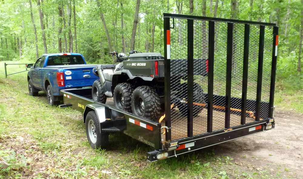

Nice trailer! Never saw one like that before with the low steel sides. I have a 12ft landscape single axle with brakes and a large gear basket in front. It's my go to quad trailer.
/ new Doo Little
#28
Ya, it's not been perfect but still handy as heck. Far better in general than the B Tex one it replaced.

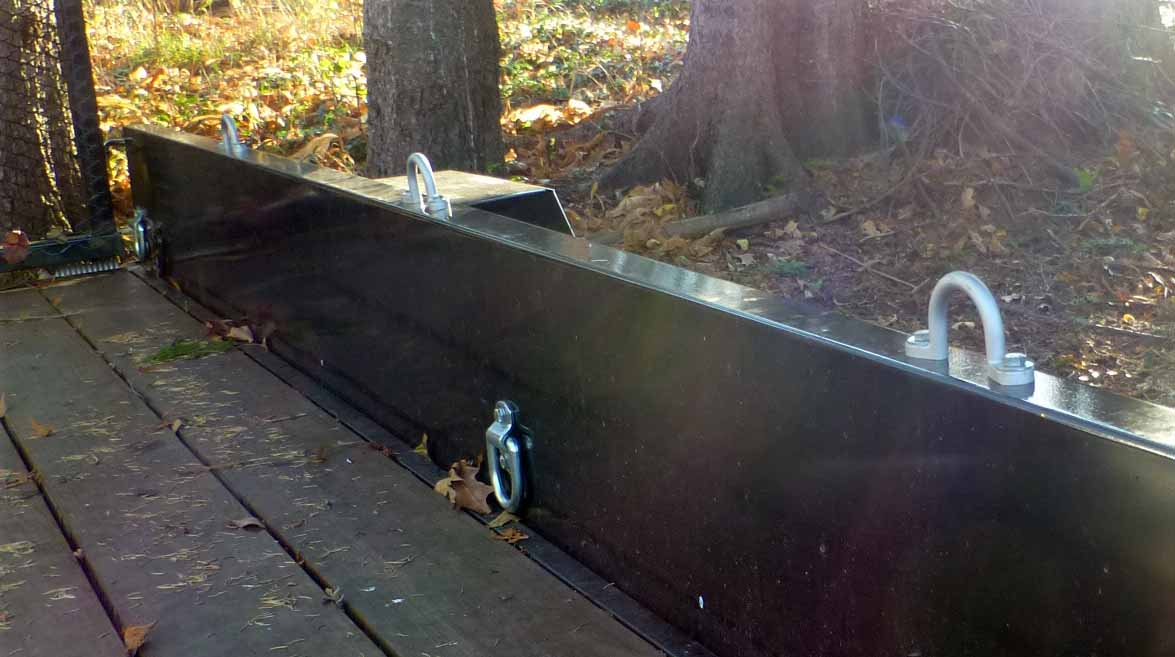

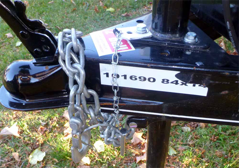

I added more d-rings to the box sides today and a attachment location for the hitch pin. The nice one seen here came with trailer but no place to add it so today I added the white aluminum plate to zip tie it on.

Not to criticize your work, but since the top rail is only bent material, not a tube, aren't you concerned about bending the top rail if you pull a strap or chain up tight?
Maybe a couple of triangle plates welded in on the outside below the D-rings to add some support.
Just my $.02.
/ new Doo Little #31
Just my $.02.
Tend to agree, but for such a little machine, it would probably handle it without bending.

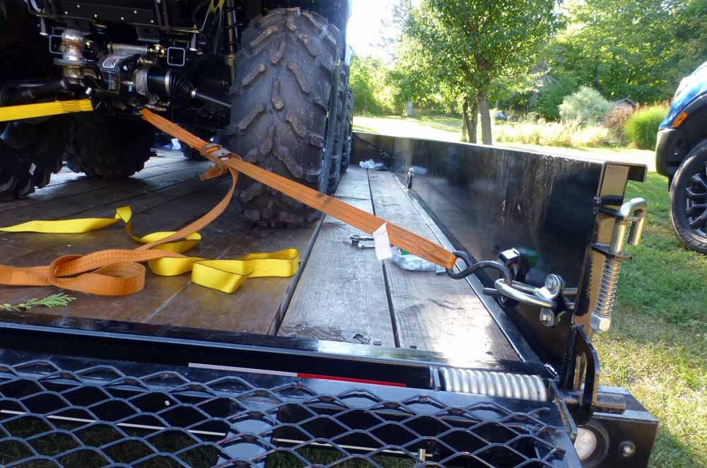

These just added aluminum D-rings located on the sidewalls are to hold slash loads down. Any heavy loads, like our 6x6 need to be held by the main d-rings near the floor and seen in this pic.

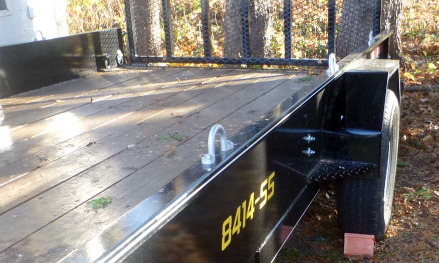

Drings are awesome add ons to any trailer, especially if you buy them in quantity they are pretty cheap. I had some lying around awhile back and welded 12 to my single axle trailer, I had the unfortunate benefit of using it for a year before the rings however in doing so I was able to figure out to put them where I needed them most. I don't mind welding stuff that can be drilled and bolted, weldings stronger imo and over the years if something welded breaks I've became a proficient wafer wheel and flap disk operater lol.
