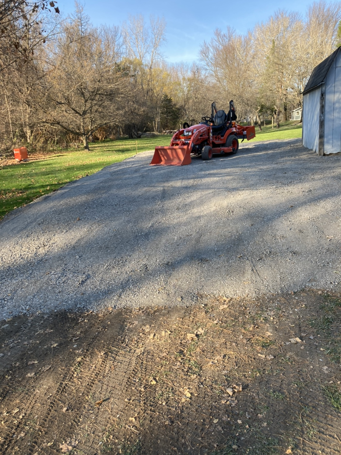

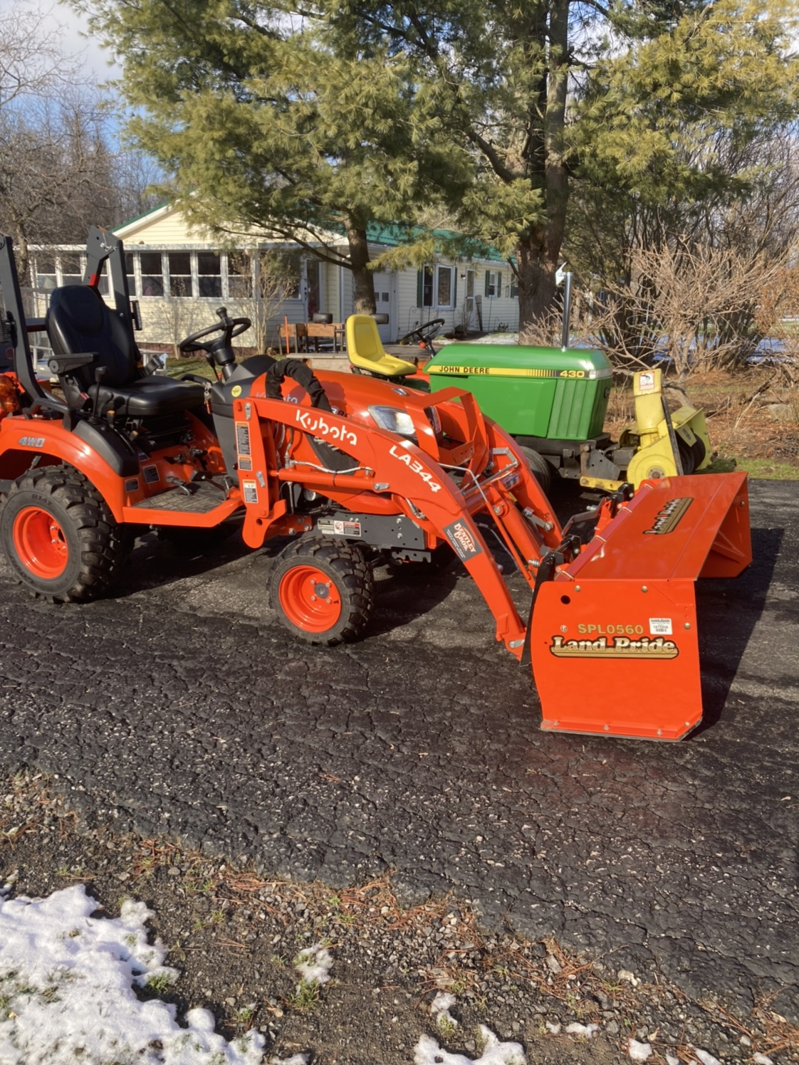

Man, time flies. A year ago today I picked up the BX2380. It now has 128 hours. It’s ok, still dealing with uneven bucket/ snowpusher issue. I give up on that. They had it close back in summer. I’ve checked bolts. Different tires. Have the R14T’s on for winter. Very nice tires. Got some free fill near end of summer- 6 dump truck loads. Got that moved across yard to where I eventually want to put a bigger shed. Then got 2 loads of free crusher run, so I spread that on top of fill. Got chance to push a little snow this past weekend, the 5’ pusher with backdrag is SOOOO nice…

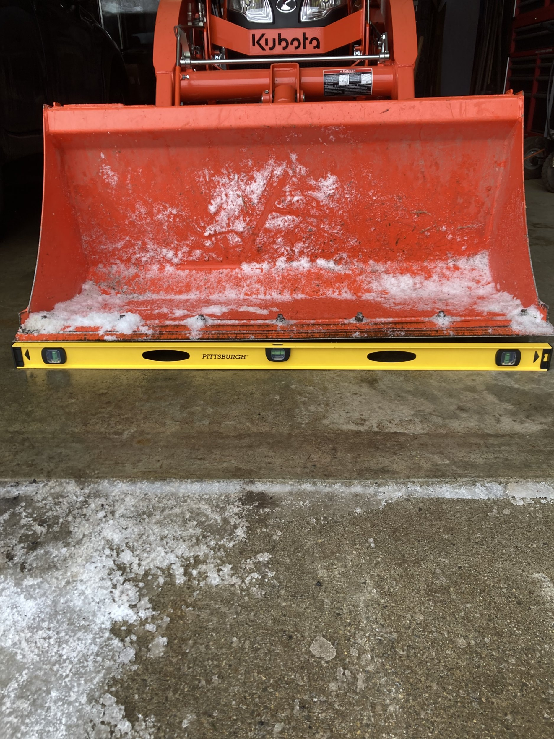

Still dealing with the loader bucket/pusher coming down unevenly, right side still hits first. Tired of dealing with it. I made my own relocation kit for about 1/2 the price of the botaproducts one. Still have to get the Summit 3rd function kit installed so I can try out grapple this spring.

Well, picked it back up from dealer yesterday regarding my 3 issues. The bucket did seem level at the dealer on their concrete pad. Tech said he has 20lbs air in right rear tire, 17lbs in left. Adjusted the loader saddles. He was able to adjust the fender on right side so it doesn't rub the seat base bracket. He also added shims to bring the hydraulic pressure up, said he shimmed it to 1900, so when it breaks in it should be in the 1800 range. I also brought my R4 tires back to dealer, they will give me credit toward a full set of the R14T tires. They ordered a set, so who knows when they will show up... ordered some wheel spacers on ebay last night, also will be checking to see how much it costs to get rears loaded
Uneven tire pressure is NOT a fix. It's a no cost bandage so they don't have to make it right. If you have the loader on and work on a side slope with the left side downhill and turn to the right you might find that the left bead pops off. If you drive it any distance after that the bead will not get a lasting seal and will keep going slowly flat, but that new rim will be on you because you let them get away without fixing the new tractor issue.

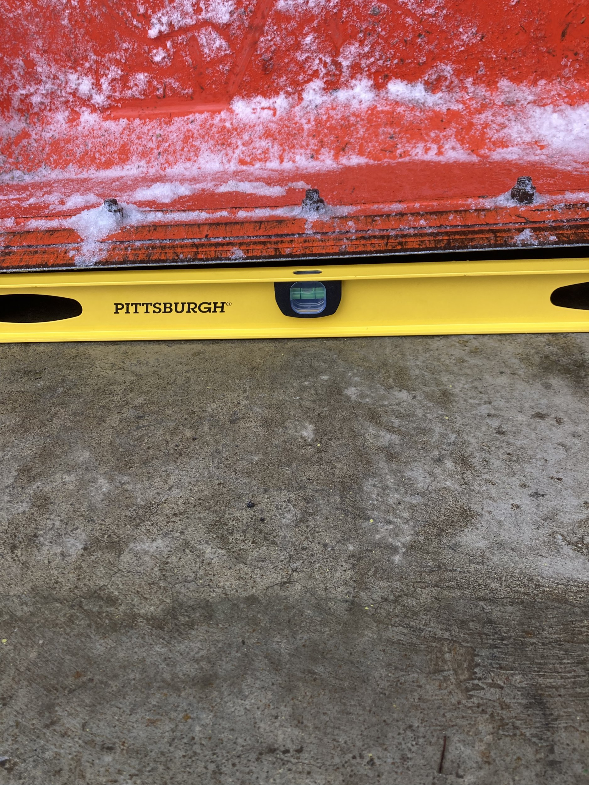

i fixed the uneven loader myself. When I loosened up the loader frame plate on the left side( I left the right side alone), the bucket went level. As soon as I tightened up the front bolts, the bucket raised off ground. So I added a washer between tractor and loader frame at the front 2 holes, alot better. Added a washer behind the 3rd bolt at top, seems to be level now. Made sure tire pressures even side to side before starting. We'll see if it stays the same when I switch to turf tires in spring....

Bob, can you post
i fixed the uneven loader myself. When I loosened up the loader frame plate on the left side( I left the right side alone), the bucket went level. As soon as I tightened up the front bolts, the bucket raised off ground. "So I added a washer between tractor and loader frame at the front 2 holes", alot better. Added a washer behind the 3rd bolt at top, seems to be level now. Made sure tire pressures even side to side before starting. We'll see if it stays the same when I switch to turf tires in spring....
I believe this placing "washers" in there is a band-aid fix and its going to come back as the same problem you started with when it works itself loose.
You are actually losing rigidness by using washers in there because you are moving the solid mounting for your FEL away from the solid tractor frame, and leaving an air gap.
I would have loosened BOTH sides, and settled & leveled everything out, then i would have tightened the left side first, if you`re saying it was the left side was the trouble maker.
Most of all, how do we even know, that it is actually the left side that is causing the main issue. What kinds of measuring have you done to compare.
I`m just trying to makes heads & tails of what`s going on here. Pretty hard to see things from my house to yours.

Took washers out. Gonna fiddle with it some more today-this is what I’m dealing with, tires even pressure side to side and front to back. Dealer took it on Feb 9,2021 to try and correct this issue. Second time I dropped it off in June I think. I only have the service order receipt for second attempt where they put different air pressure in rear tires. I think I’ll be sending pics and letter to corporate about this issue. I’m going to kindly request a new loader setup(frame holders, loader, ssqa mount) - it just isn’t right. I shouldn’t have to deal with poor workmanship…
