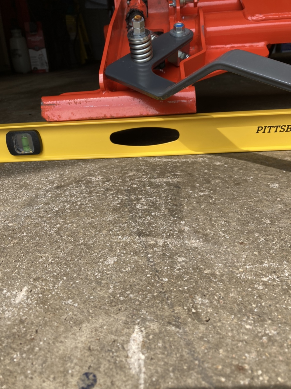

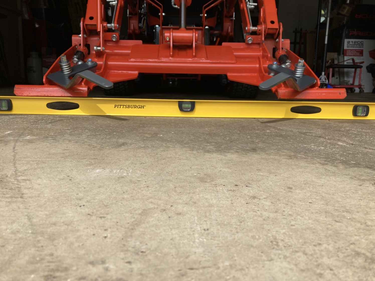

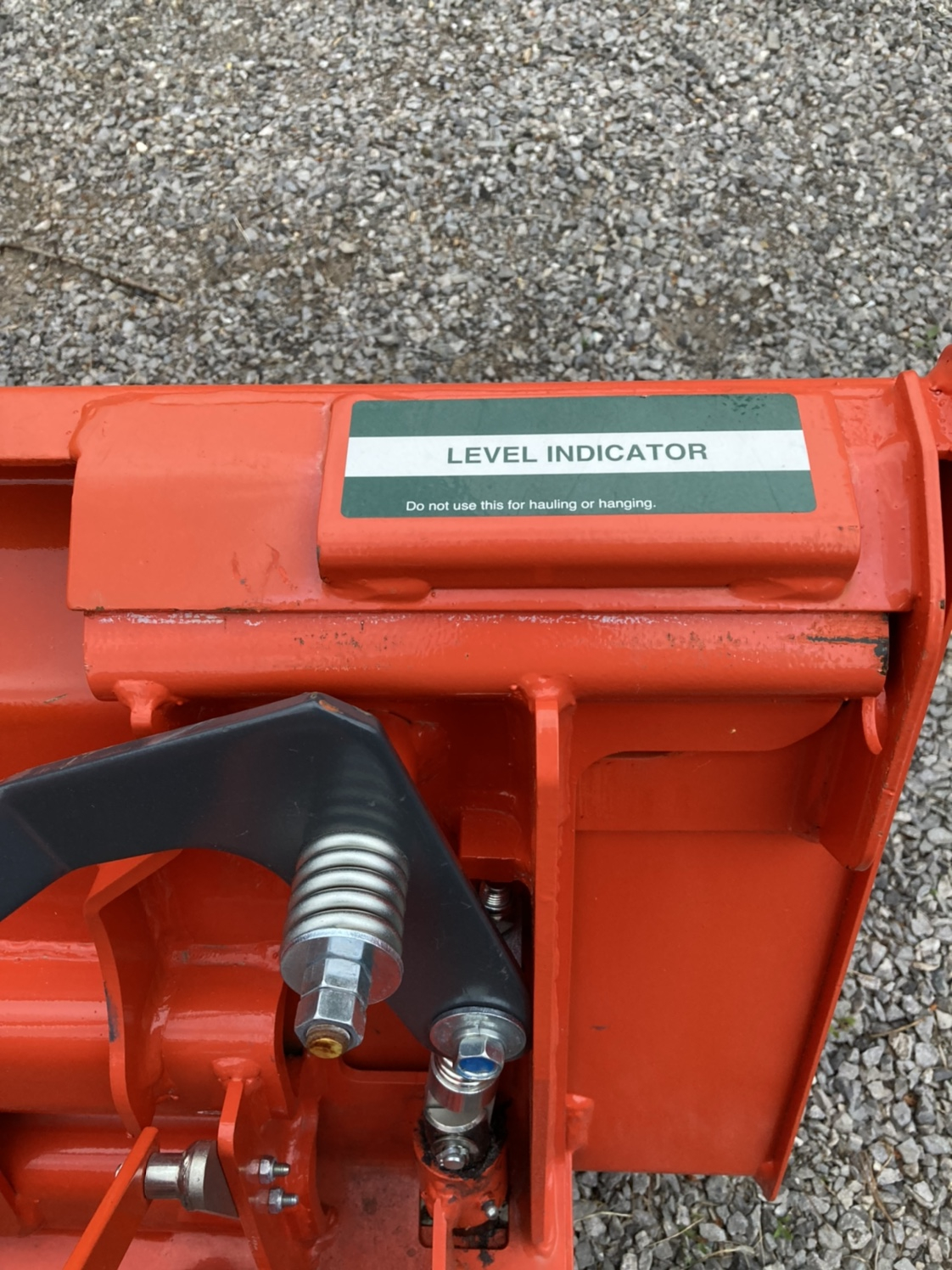

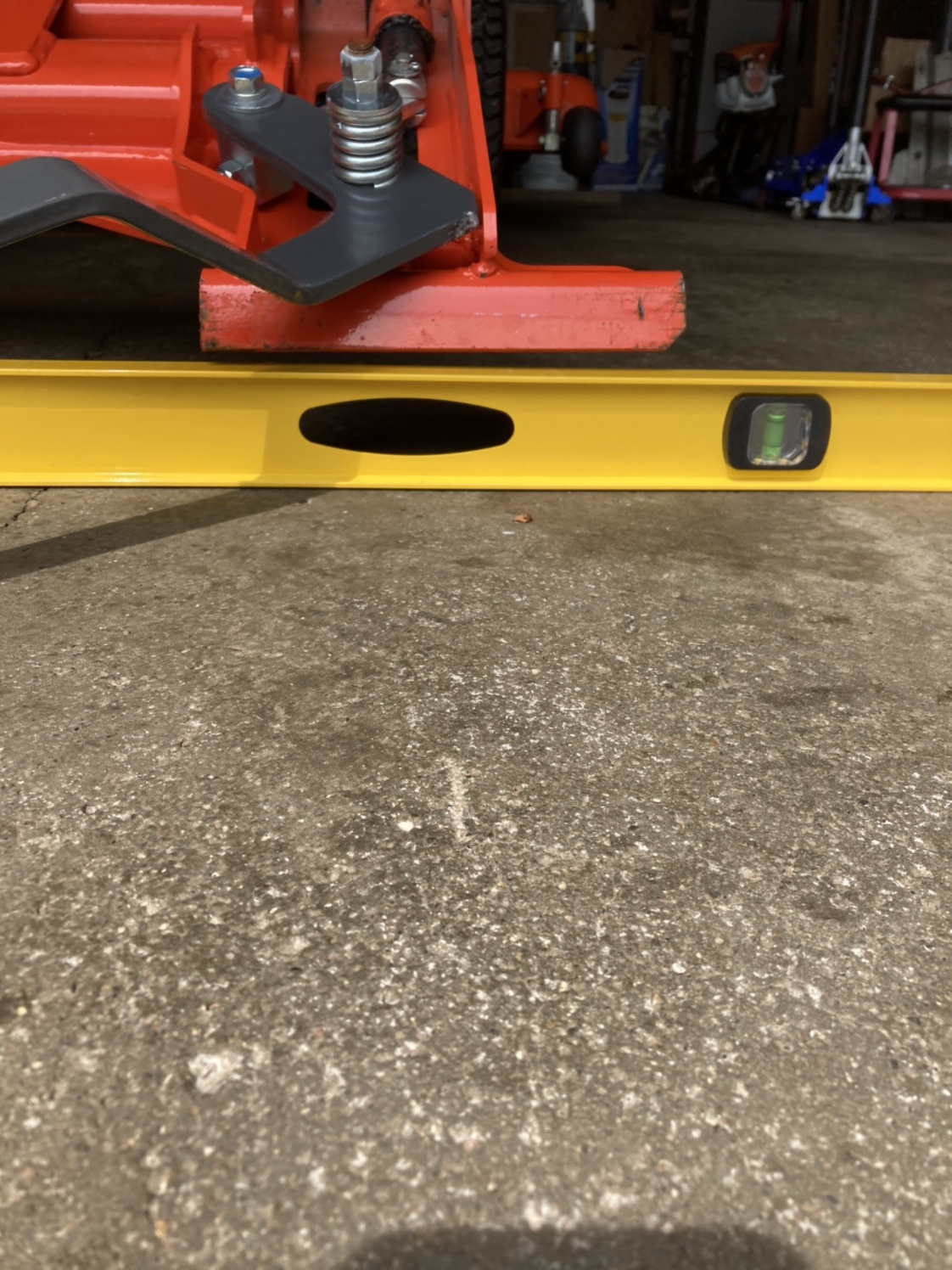

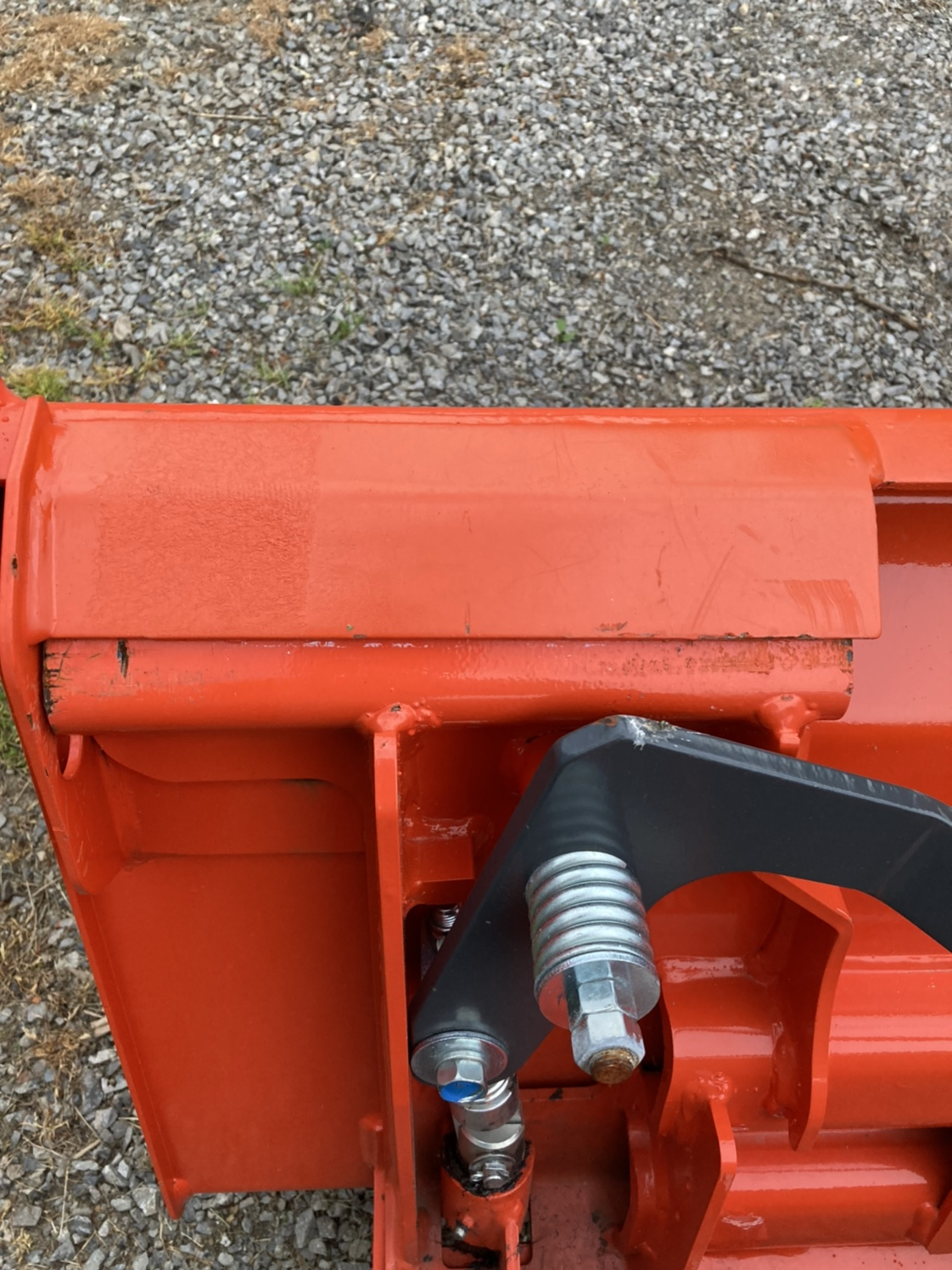

I'm not sure, but MAY have found the uneven bucket issue. After mowing , I hooked loader back up. As I was lowering the loader, I noticed that the left side quick attach didn't look even where it slides into top of bucket. Checked all the measurements between left and right side, same. Left side doesn't fully seat into top of bucket. Latches are seated. Unlatched and took bucket off. Eyeballing the SSQA plate that's attached to front of loader, it sure looks like it's bent back ever so slightly. Got a level out and set it across front of plate-flat against right side, a decent gap on left. I'll get some pics and post to see what forum members think....

First photo is the left side, latch is fully seated. Seems like the mounting isn't fully seated into bucket. Second photo is right side, which looks like it is properly seated into bucket. Third photo is full view, no wobble of level on the floor, tires even pressure side to side. Am I crazy or do other people see what I see??? I am going to dealer on Wednesday to see what can be done, along with the right seat base hitting the fender lip just above fuel tank...

Well, picked it back up from dealer yesterday regarding my 3 issues. The bucket did seem level at the dealer on their concrete pad. Tech said he has 20lbs air in right rear tire, 17lbs in left. Adjusted the loader saddles. He was able to adjust the fender on right side so it doesn't rub the seat base bracket. He also added shims to bring the hydraulic pressure up, said he shimmed it to 1900, so when it breaks in it should be in the 1800 range. I also brought my R4 tires back to dealer, they will give me credit toward a full set of the R14T tires. They ordered a set, so who knows when they will show up... ordered some wheel spacers on ebay last night, also will be checking to see how much it costs to get rears loaded
