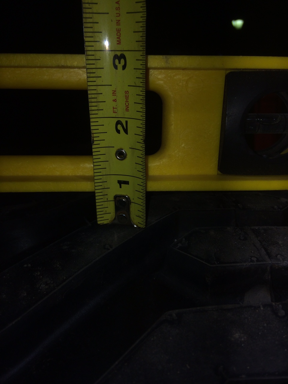

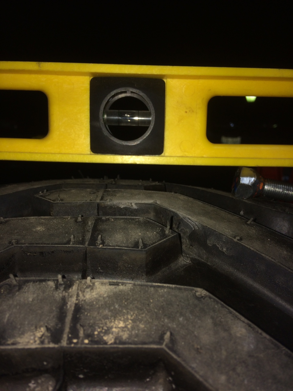

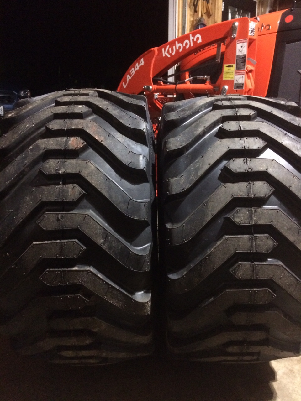

Wow thats crazy. They are the same spec tire right?
Yep. Only reason I measured was someone on another forum had the same problem on an 1880 and his rear tires were different height by about 1/2"- about same as what I'm off...

The level is sitting across other tire and this is about how much difference there is to make it level, I just grabbed what was close to raise the level.....

What brand tires are they?
   / New 2021 Kubota BX2380 w/MMM & FEL- first impressions and any problems/issues....
#16
Garden Master I think. Got a different pair of tires and still no change :mad: :mad: :mad:. I loosened up loader bracket mount to tractor frame on left side, and bucket goes level-soon as I tighten one of the bolts, loader frame pulls to top and becomes unlevel again:mad::mad::mad:...after that, I loosened the right side, then tightened left side, still pulled bucket up....

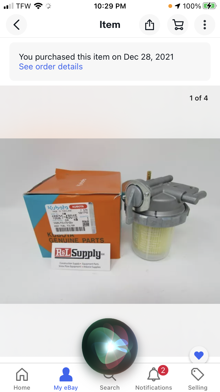

I got my LED headlights I ordered off eBay- a 3 pack for around $13. Installed them and they look nice and bright. I bought some LED squares and harness kit to mount on my ROPS. I got the mower deck off. Still need to investigate that stupid seat switch, I think I just zip tied it down on the 1870. Got the Messick's adjustable links installed along with the Ai2 BX receiver hitch. I also ordered another Kubota fuel filter housing to replace that dinky fuel filter underneath.
WHAT Kubota fuel filter & housing did you get?
#20
This one. I also used 2-1/2” aluminum angle for the bracket to mount it to. I bought a roll of 5/16” fuel line off eBay when I put it on the 1870, so I still have plenty left over. Not gonna install it until loader situation gets taken care of…
