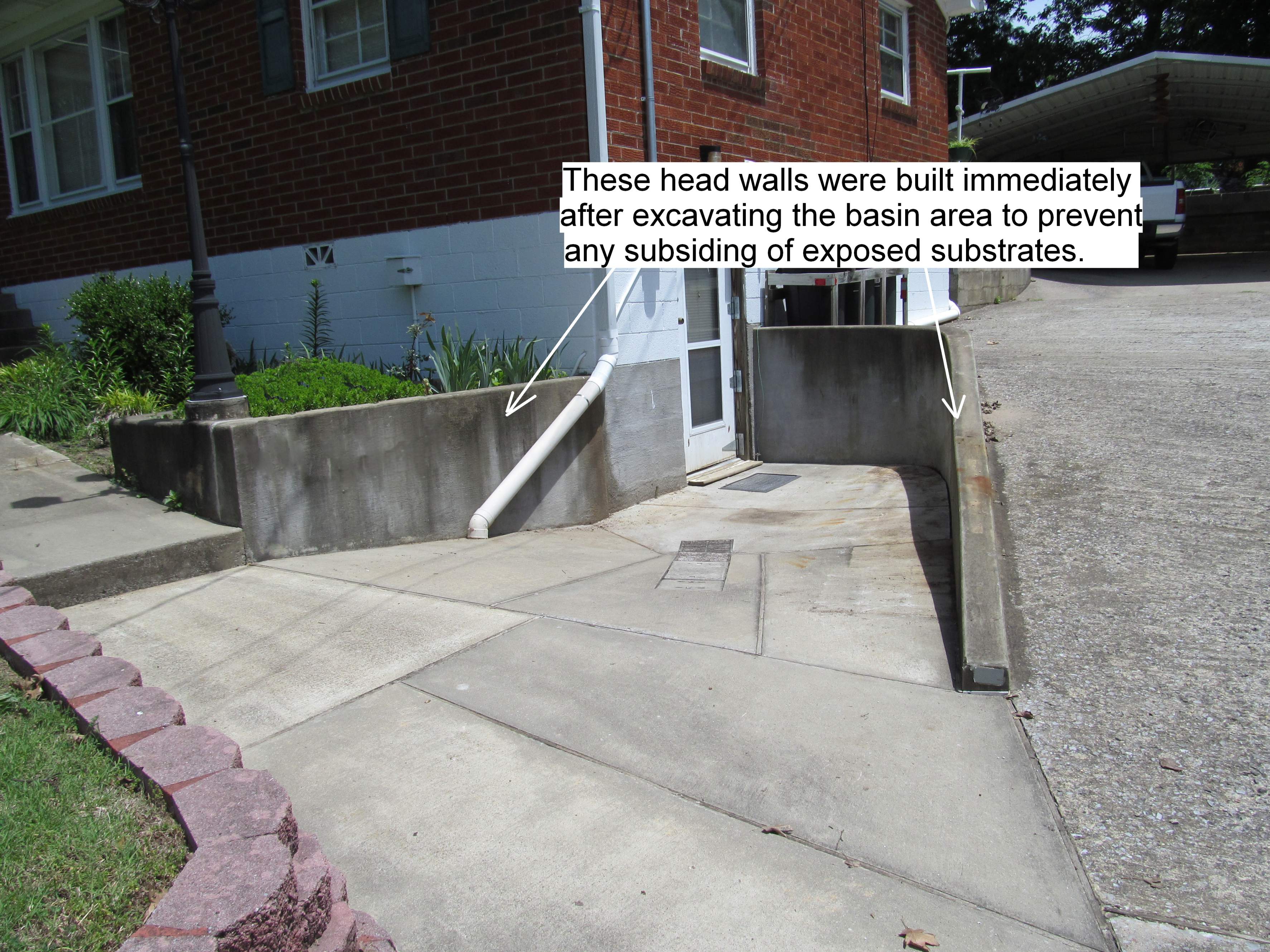

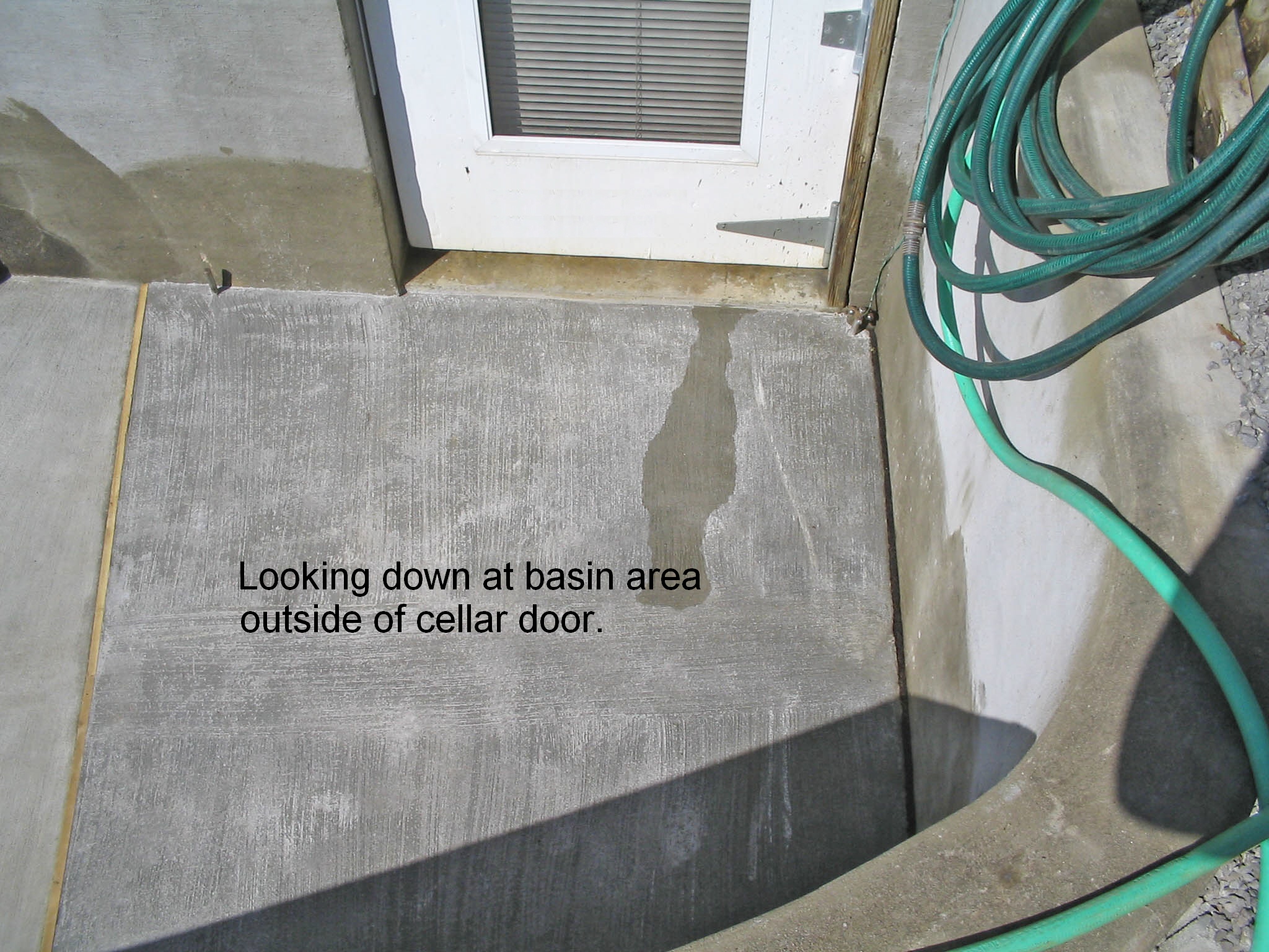

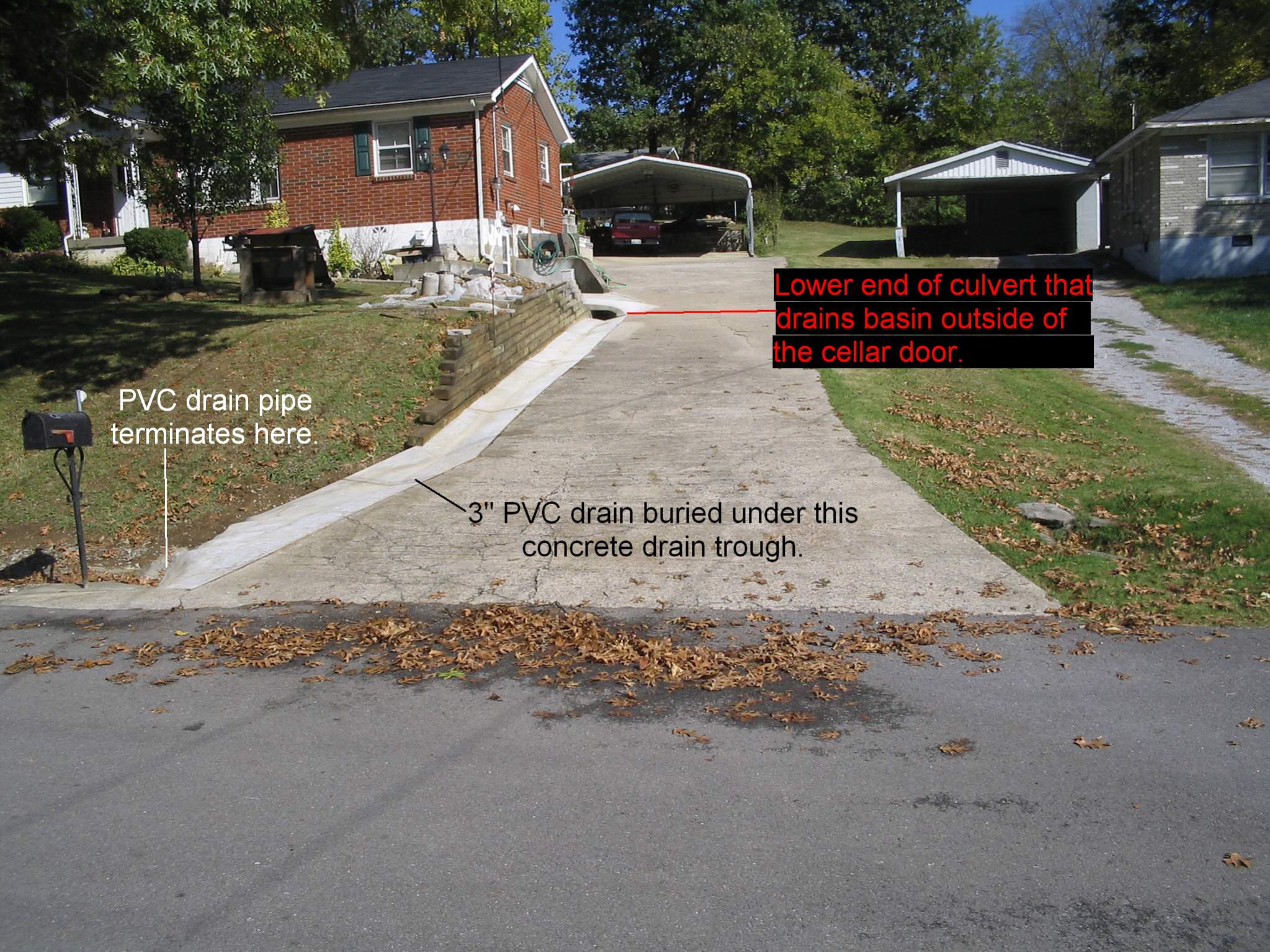

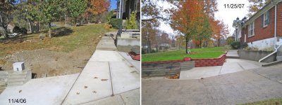

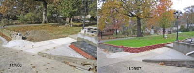

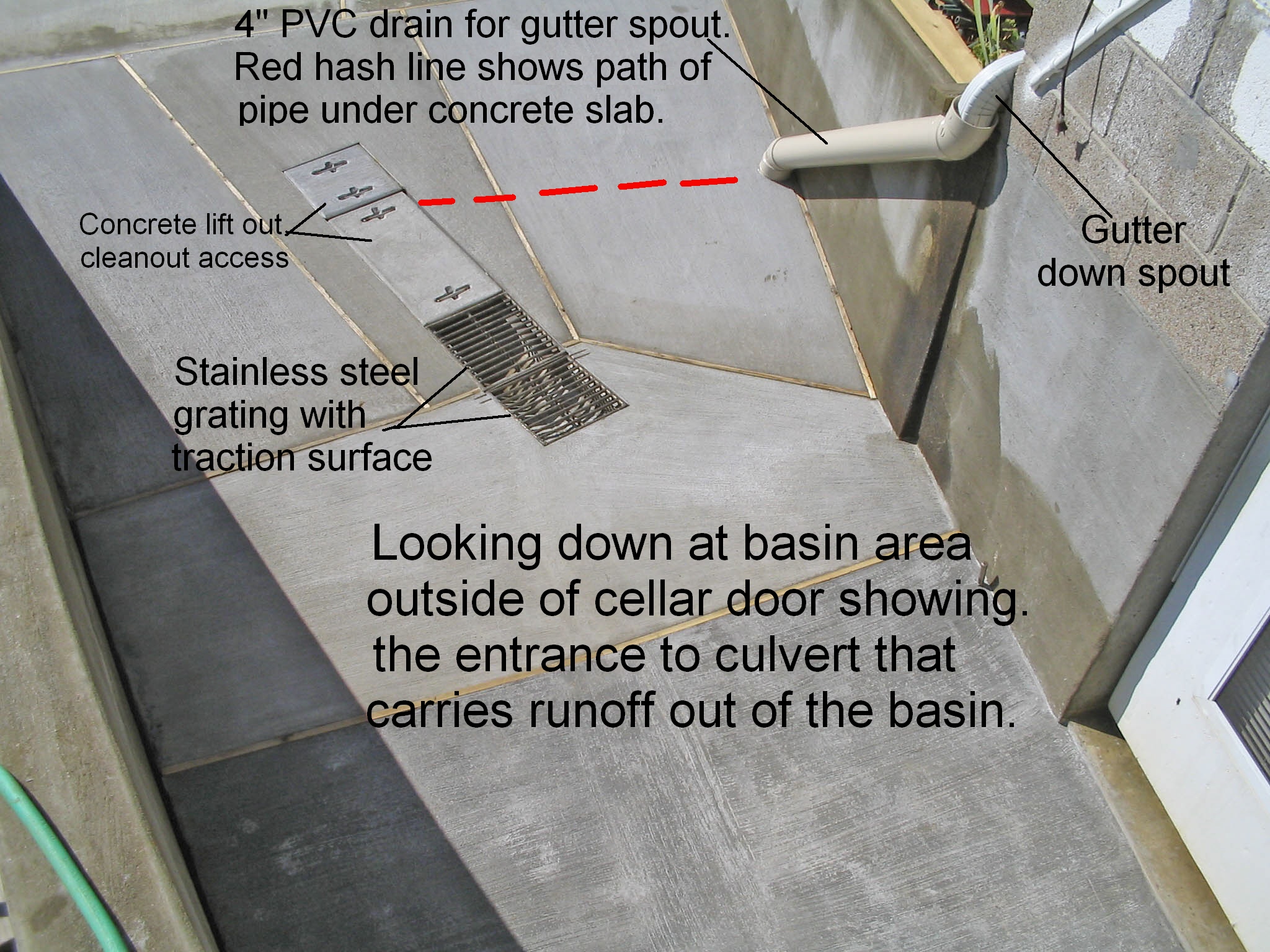

Even better, I am a somewhat experienced backhoe operator. I ran an old Ford 4500 hoe for the private owner on his land for 3 years doing projects he needed done. Built a big pond and did some septic drain field work he contracted to dig for a builder friend of his. Later, I rented a compact backhoe/FEL for an ambitious project at the house we live in now. This project was to install a gravity drain system for the cellar of the house, which we found out after the drought ended and the rain came, would be prone to standing water 12" deep after a storm. The house is notched into a hillside. It had a cellar that was accessed by going through a 36" high door at grade level and descending 4 steps to the concrete cellar floor. That arrangement was like a big bowl that would fill with ground water after a hard rain and took a couple of days time to drain out after the rain stopped. I dug out an area outside the cellar crawl through door, all the way down below the footing and shot a 3" PVC pipe to intersect with a sump cavity that I made in the concrete floor under the house. Then the 3" PVC pipe ran 80' downhill in a trench I dug next to the driveway.
The area outside the cellar door was then enlarged to about 15' X 10'. I installed a drain culvert to carry away rain and runoff from the gutter downspout to a concrete trough I made above the filled in trench next to the driveway.
Then I poured concrete outside the cellar crawl through door. The last thing I did was knock out the small 36" high by 28" wide crawl through door and replace it with a walk through door.
The photos show some of the work I did (and I mean "I did" with my 2 hands).

By the way, nice job on the water management on the current house.
