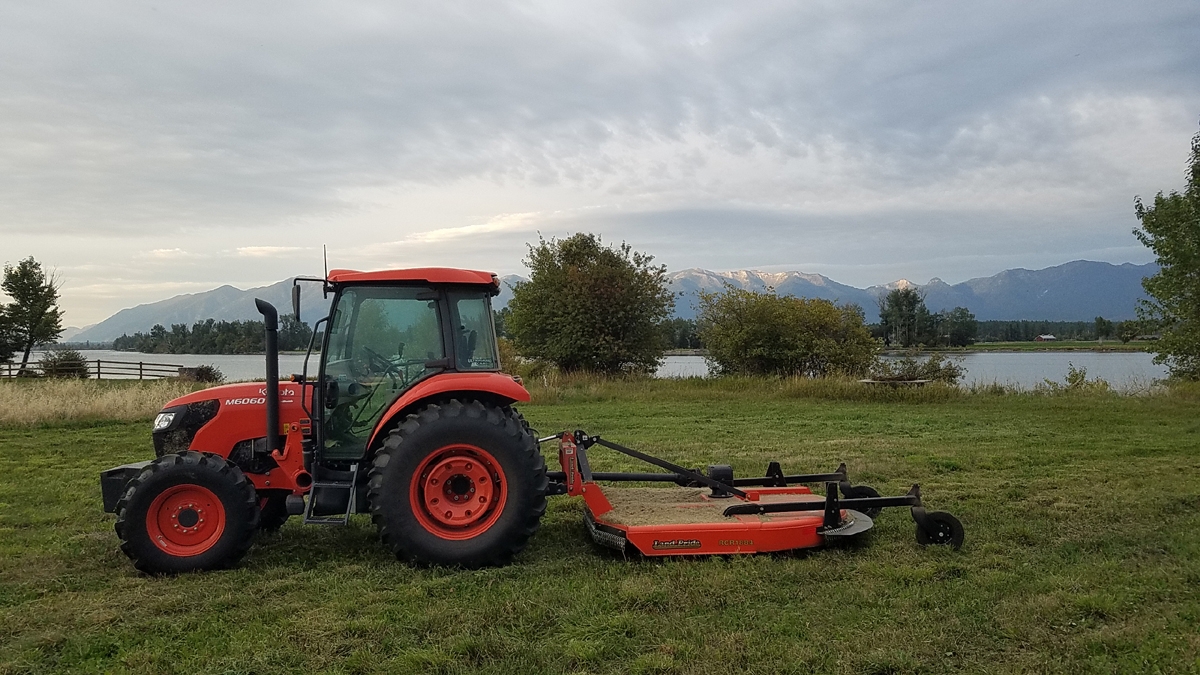

I have a Kubota M6060 F8/R8 with creep range and hydraulic shuttle. It's a beast of a tractor compared to my MX6000. Both have four cylinder engines putting out mid 60s hp but the M feels like it has a lot more power and torque. I would have ordered an M7060 with the F12/R12 if I hadn't come across the 6060 for such a great price in Sheridan, WY. Anyway, I suggest looking at the M6060/M7060.
