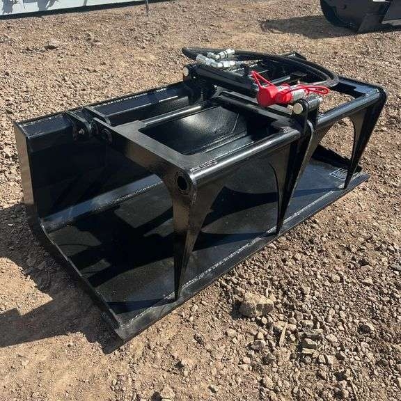

Consider a grapple of some type. I suggest a flat bottom style. This just may be my preference on style, but I have used 2 styles and like the longer flat bottom for brush and longs.
