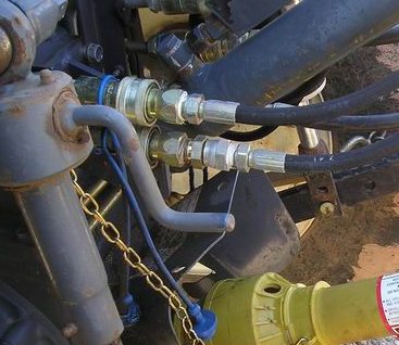

I thought I would post this data about hydraulic restrictors for anyone interested. Your basic restrictor is essentially a fitting bored to allow a certain amount of fluid to flow and limit the speed of hydraulic cylinders in both directions. Then there are the more elaborate restrictor assembly's which allow one way travel, and two way travel. These also have filters in them to keep the unit working as advertised.
The one way restrictor is used to slow, say the grapple in the closing mode, and have full speed in the return stroke. You would normally want it to open fast. The two way lets the orifice work in both directions. There are formulas to compute the flow through an orifice, but some people just guess at what they need. These will cost a little more than the $5 orifice.
Restrictors

Brian, I've never found restrictor fittings online except that I've found them in Parker's catalog. I get mine at my NH dealer and I think someone else said they found one at Tractor Supply, but I've never seen them there.
About the OP... I got the impression that he was talking about a BH that attached to his tractor's remotes. He was using those remotes for other attachments and wanted to slow them when they are attached. Having other attachments means he will have to buy male QCs no matter what his setup, even if the other attachment has its own hoses. An orifice and at most a single 1/2 to 3/8 adapter is all I've ever had to add to any circuit. Since the restrictor has a female fitting on one end and a male on the other, it goes right inline with 3/8" hose, no other fitting required. I'm including a picture of the restrictor orifice attached inline on my toplink. You can only tell it's there because the lower fitting is longer than the top. That's about as simple as it gets. If I disconnected this and attached a backhoe, then the restrictor would be gone. I'm just having a hard time seeing all the extras you mentioned.:confused:
BTW: The OP has already opted for a solution, so this is all just sidebar discussion anyhow. It is interesting though.:)
