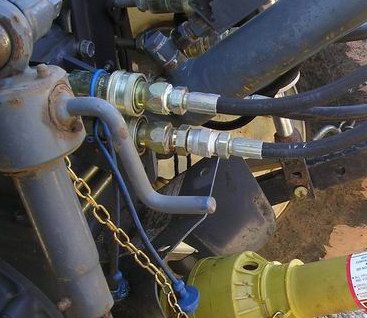

Your logic is flawed if you think different size cylinders will fill up and extend at the same rate using a set orifice. Just how do you think the flow control valve work. It is a variable orifice allowing a certain amount of fluid to flow. That is how you get speed control on a hyd motor, or the rate of cylinder extension. The FEL valve itself is a variable orifice.
A set orifice with a set pressure will let so much fluid flow, which will equate into GPM's, and further equate into time for extension. The cylinder extension times is based on the volume of fluid entering the base of the cyl.
CYLINDER SPEED IS BASED ON IT'S INSIDE DIAMETER, AND GPM.
No, my logic is not flawed. I know how a flow control and hydraulics work. When you push fluid through a set size orifice, it passes at a certain rate depending on the pressure. The orifice has no idea of cylinder size or what is making it flow. Pushing fluid through a 2" bore cylinder, then a .030" orifice, will create a backpressure, usually not making the relief valve open on most tractors. Pushing fluid through a 3" cylinder will do the same, however, because the 3" cylinder holds more volume, it will push the fluid through faster, causing the cylinder to move faster. As I stated, why do you think .030" is so common?
About the last thing I need is a schooling from you on hydraulics. BTW JJ, you asked me for my qualifications, which I posted. What are yours?
/ Need to slow down rear remotes. #22
Just good old common sense, and that is not bragging about ones degree, because I am not impressed.
/ Need to slow down rear remotes. #23
www.tompkinsind.com. Just about any restrictor fitting you need. They go inline, no adaptors needed. You guys are not getting the theory behind having an .030" restrictor. It reduces the flow just about right no matter the cylinder size, except if you get into real big stuff.
This is just not true. You would notice almost no difference in speed by changing your cylinder size, within reason of course. The more fluid flow of the 3" cylinder would push the fluid through the restrictor faster. I have seen this personally. The main difference would be the extra pressure in the 3" cylinder to push the fluid out at roughly the same speed. This is why the .030 " restrictor is such a common size. The .030" restrictor works for almost every implement requiring slower speeds.

Brian, I can't speak for Wayne County Hose, but a 3" cylinder and a 2" cylinder doing the same work will experience different internal pressures. The 3" will have a lower pressure and therefore allow more fluid to flow through the same size of orifice. With a 3" inch cylinder and larger equivalent load, the flow would slow down, but in positional circuits you would probably like that effect. With the 0.030" restrictors I use, the movement of my toplink is still quite fast and my grapple on the front of my tractor through 1/4" hoses is extremely fast if I fully open my remote valve. Even with the 0.030" orifices inline, I still have to feather my remote lever for slow and precise movements of the cylinders. Without the orifices, it was hard to ever move my cylinders less than 1". With the restriction, it's easy.
I'm sure you can adjust a needle valve for small flow and have unbelievable control. I'm also pretty sure that it would become a pain to readjust for every application if you just had one set up to change between any implement. I think you would soon just find a single "best" setting and that's where the valve would stay most of the time because you don't want to get on/off your tractor and adjust/readjust until you get it right. However, I don't want to assume something I have never tried. My impressions may not be correct. I only ask the same from those who have never tried one of these fixed orifices. If you try the simple solution and it is not satisfactory, by all means go to that adjustable needle valve orifice and don't look back.:)

Sooooooo, with all these variables that each and everyone of us have to deal with, and most of us are not really qualified to figure this stuff out.:eek: If and this is a BIIIIIIG if, we are to use one valve for multiple uses with different size hydraulic cylinders, would it not be best to use a needle valve to get the control on the cylinder that we want? Jinman mentioned that his top link with the restrictor is still fast, but controllable. Is it not true that he could slow it down even more if he had a needle valve in the line?
I concede that the restrictor is the cheapest and easiest way to slow down hydraulic movement most of the time. But in my opinion, there are times that a needle flow control valve is the way to go.

What works for one person, may not work for someone else. An orifice will let a certain GPM flow, to operate the cylinder. A FEL valve is doing the same thing by activating the lever a small amount, and allowing a certain GPM to flow. There is only a small drop in pressure after the orifice. Wayne has a hydraulic shop, and could set up a test and verify the results. He would have pressure gages, and flow meters, cyl, etc. About the only results we would like to see is, what GPM is being pushed through a .030 orifice, compared to an orifice of .250, and timing on a 2 in cyl with a 1.125 rod, and a 14 in stroke, using a 10 GPM pump. He probably won't do it for me, but maybe for the rest of you guys. If I am wrong, so be it.
/ Need to slow down rear remotes. #32
Andy, would you have an estimated travel time difference between a 2" and 3" cylinder? Would you say 25%-50%? :confused: Maybe an educated guess?
Don't know how many gal the .030 orifice will flow, but if it will pass 5 GPM into a cylinder.
Maybe this will answer some questions.
CYL BORE ----- GPM ----- IPS
3-------10-------------5.4
2-------10-------------12.3
3--------5--------------2.7
2--------5--------------6.1
3--------2--------------1.1
2--------2--------------2.5

Have to agree with Mountain on the extra for the needle valve. Expecially if one doesnt know how to calculate the restrictor or its workings.To be able to infinetly adjust it is well worth the extra money. Of cource more moving parts and seals to go wrong with it.
#34
Very interesting discussion over what I though was a simple question!
I'm not concerned about having to adjust the needle valves as the valve will be right behind the seat so I can stand off to the side of the tractor, move the lever, too fast, close the valve, too slow open the valve, no problem. I'm also not too concerned about it being more complicated and breaking for 2 reasons. First it is such a small addition to the overall complication that is already in place that it hardly makes any difference, and second I can just unplug it from the line and go on without it.
