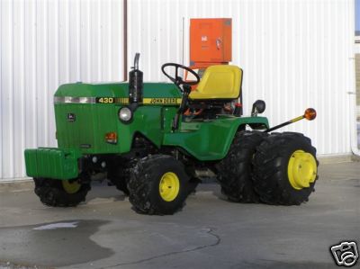

Though the attached file shows a small tractor, it looks like it might do well on a hill.
Yooper Dave
