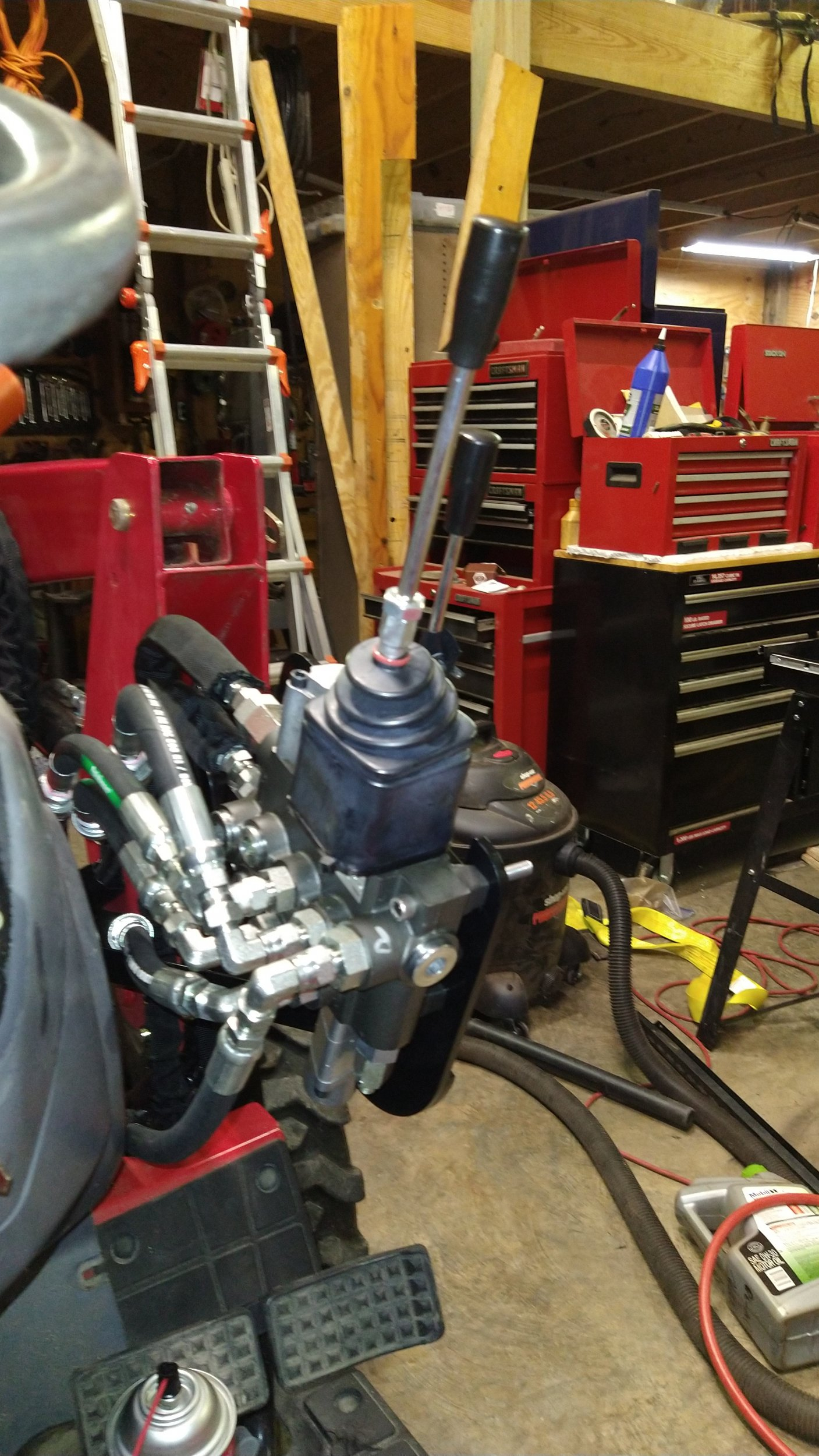

After having thought about this. I think all that needs to be done is to swap spools. So the first and second spools would need their guts swapped out. The float spool is longer and there is a longer section at the bottom that would need to be swapped as well. This is assuming all the castings are the same no matter what valve you have. So if I am right, the new patterns would be 12 o-clock and 3 o-clock.
   / Need loader valve for Mahindra MH115 loader for 3016 tractor
#27

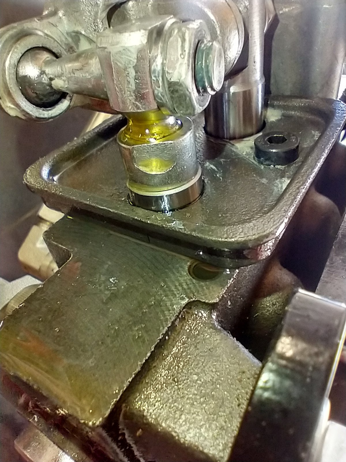

Ok well, I went forward with the 9 o-clock pattern with the ports turned inward. This worked out ok and I redesigned the mounts. It worked fine but the curl spool was not working right. It would not stay centered and the bucket was stuck in curl up. Took the valve off and the screw that holds the spring on the end of the spool was loose causing the problem. If this had been on the boom spool, it could have been bad. Good idea to check them. Remove bottom cap.
   / Need loader valve for Mahindra MH115 loader for 3016 tractor #28
Perryg nice install. Can you provide the part number for the valve you have? I just got a 2545cl loader for my 2638 open station and need to build something similar. Any extra photos would be great. I still need to figure out the feed and return lines on the tractor.

Update, the valve has worked well but there is an oil leak at the top threads of the boom float spool. Replaced O-rings no go. The threads at the top of the spool are leaking. Looking for something that will seal the top threads. I have some blue locktight.
