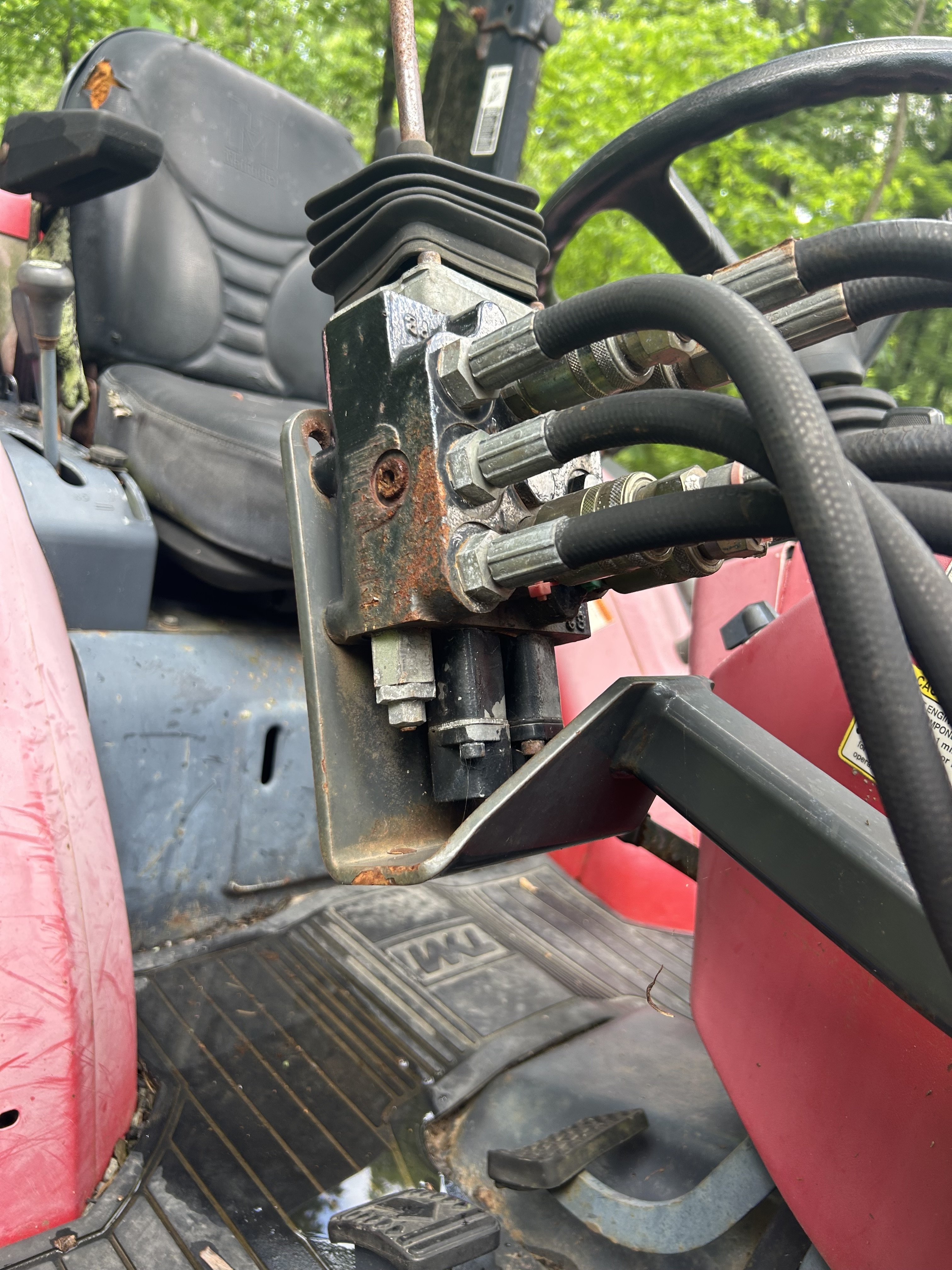

I have a Mahindra 3510 with a ML108H front end loader on it. The little picture on the loader control valve shows that it has a float function if you push the lever forward all the way.. mine won’t allow me to push it all the way. It’ll only go as far as dropping the loader. There’s no extension that would push it into float “mode” per se. Does anybody have any insight on how to get my loader float function to work?

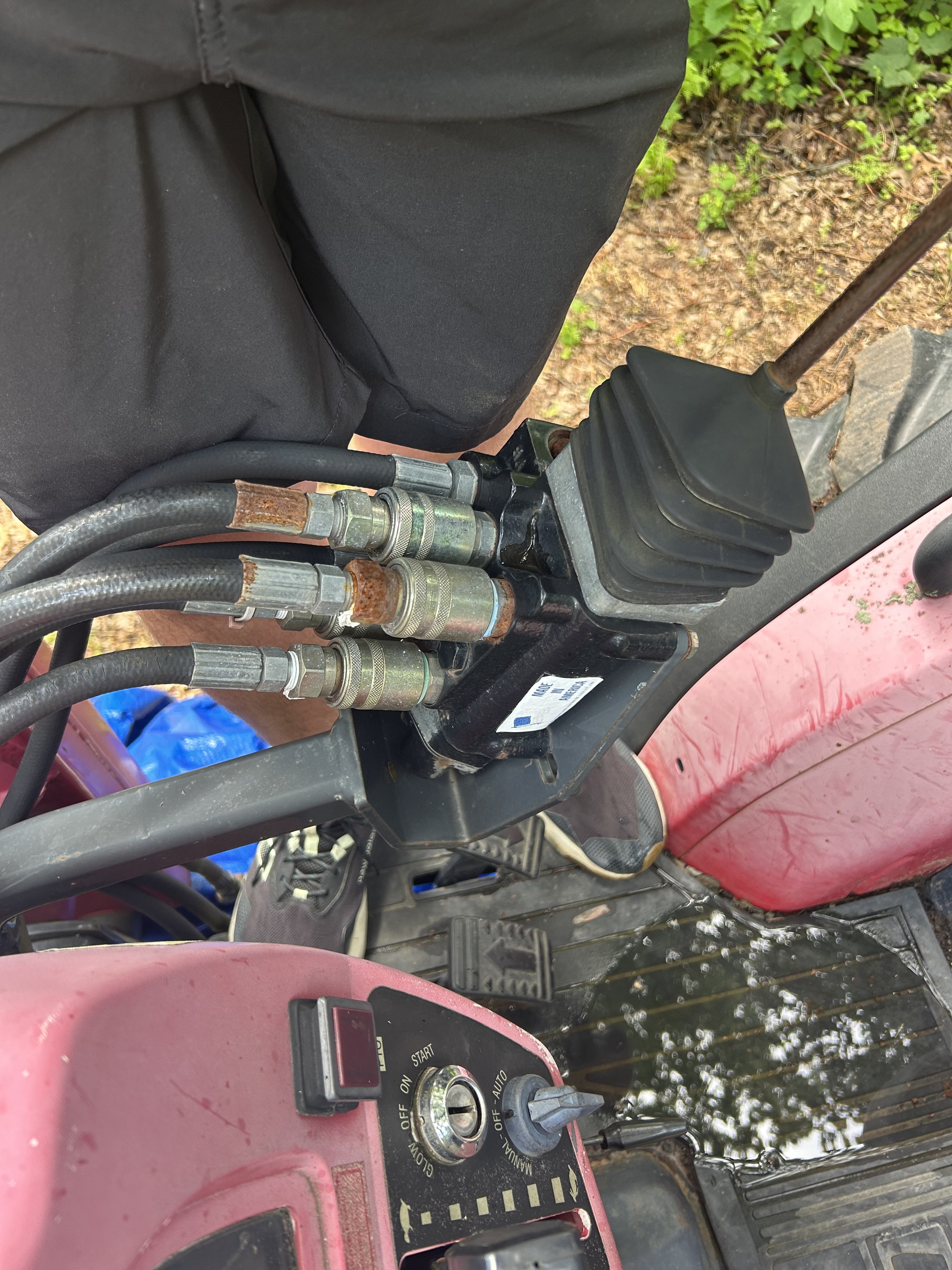

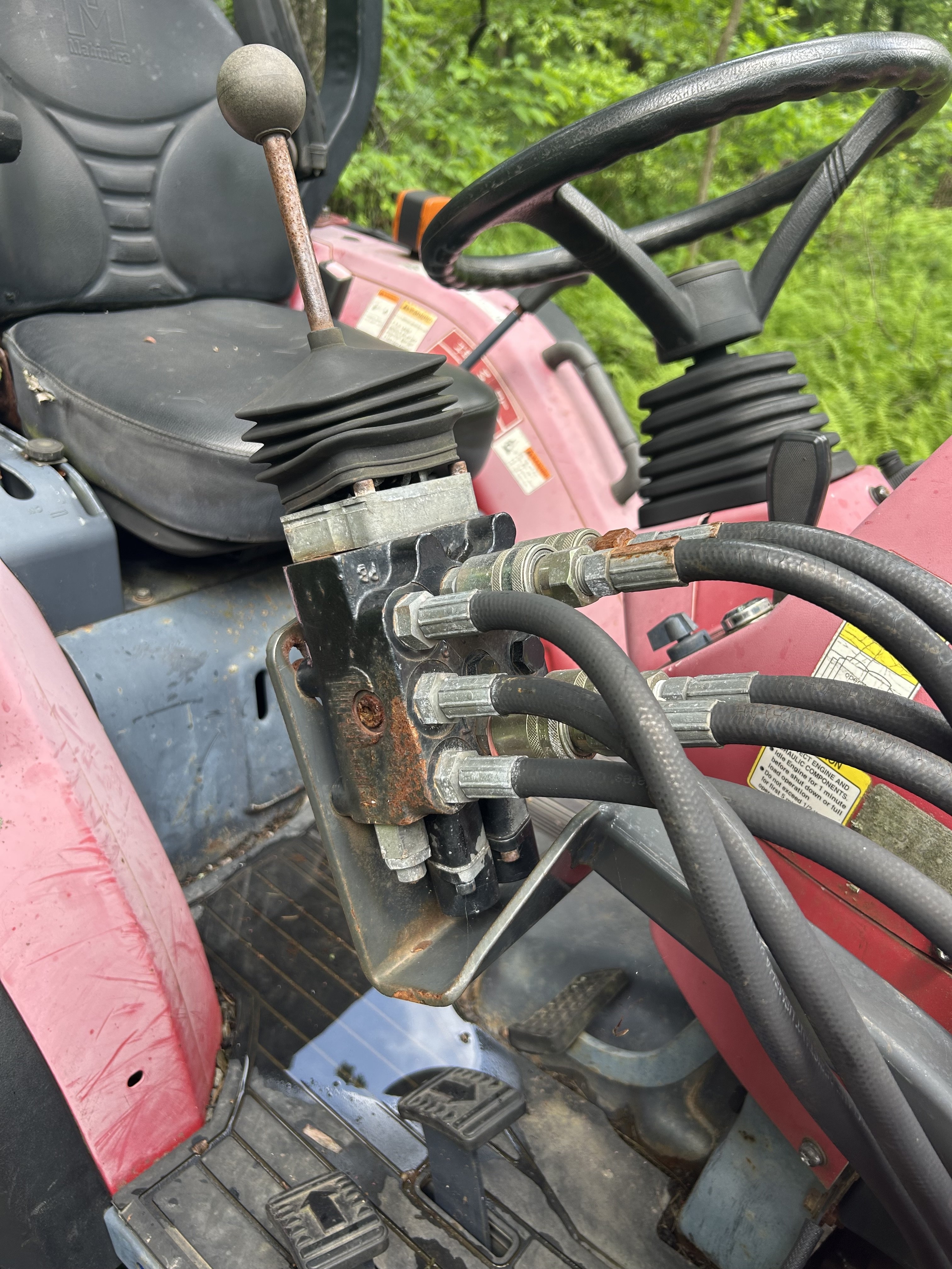

Here is my loader control valve. The loader is a ML108H and the little diagram shows a float function on it.. and to push upwards past the loader down. If it’s like the other tractor I use.. I’d assume it “clicks” into the float position 🤷🏻‍♂️

Does the curl dump have detent on it.? If not I don’t believe that valve has float since the spring caps or covers appear to be the same length while detent option the cover is usually longer
/ Mahindra 3510 loader float valve #13
I'm thinking the same thing from the equal cap lengths.

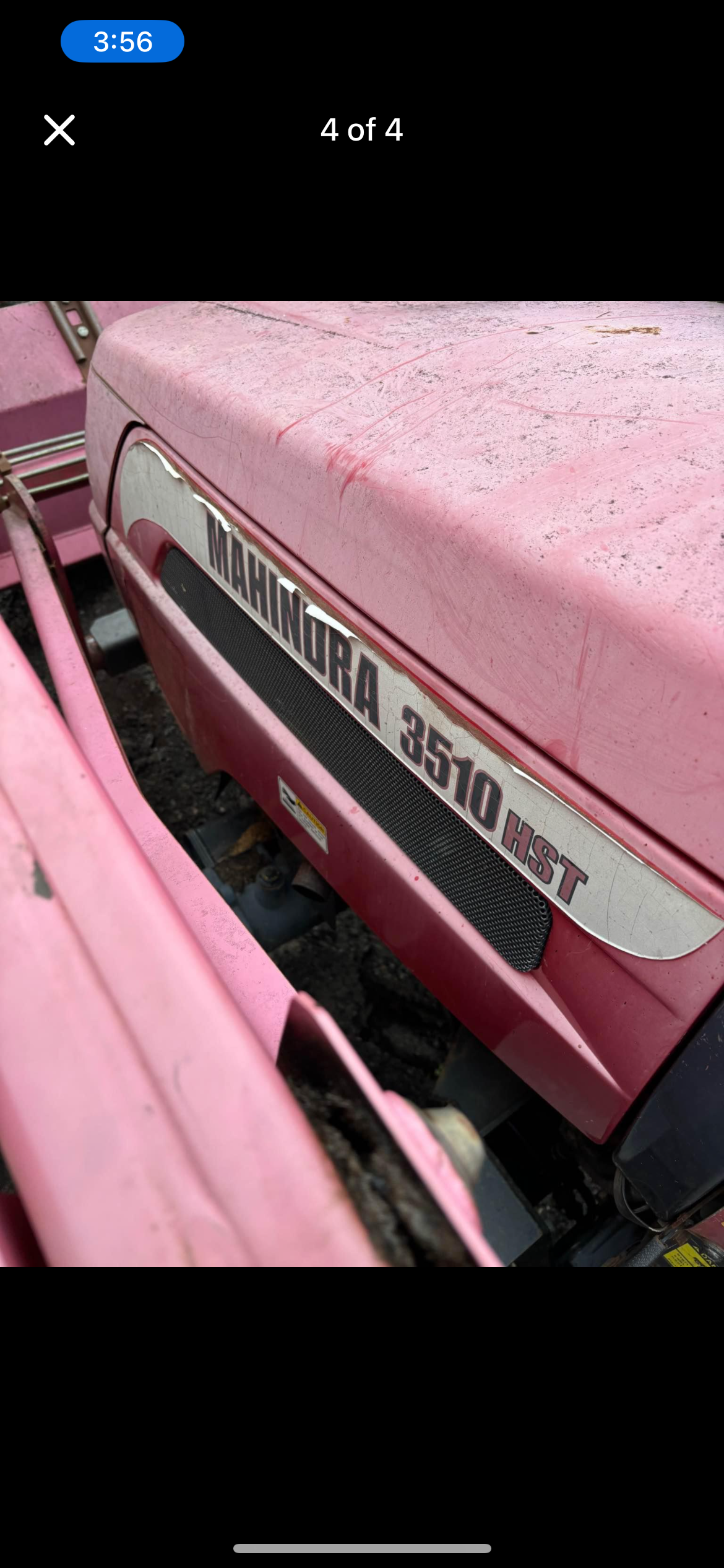

Just wondering, is that a Mahindra 2810 or a 3510?

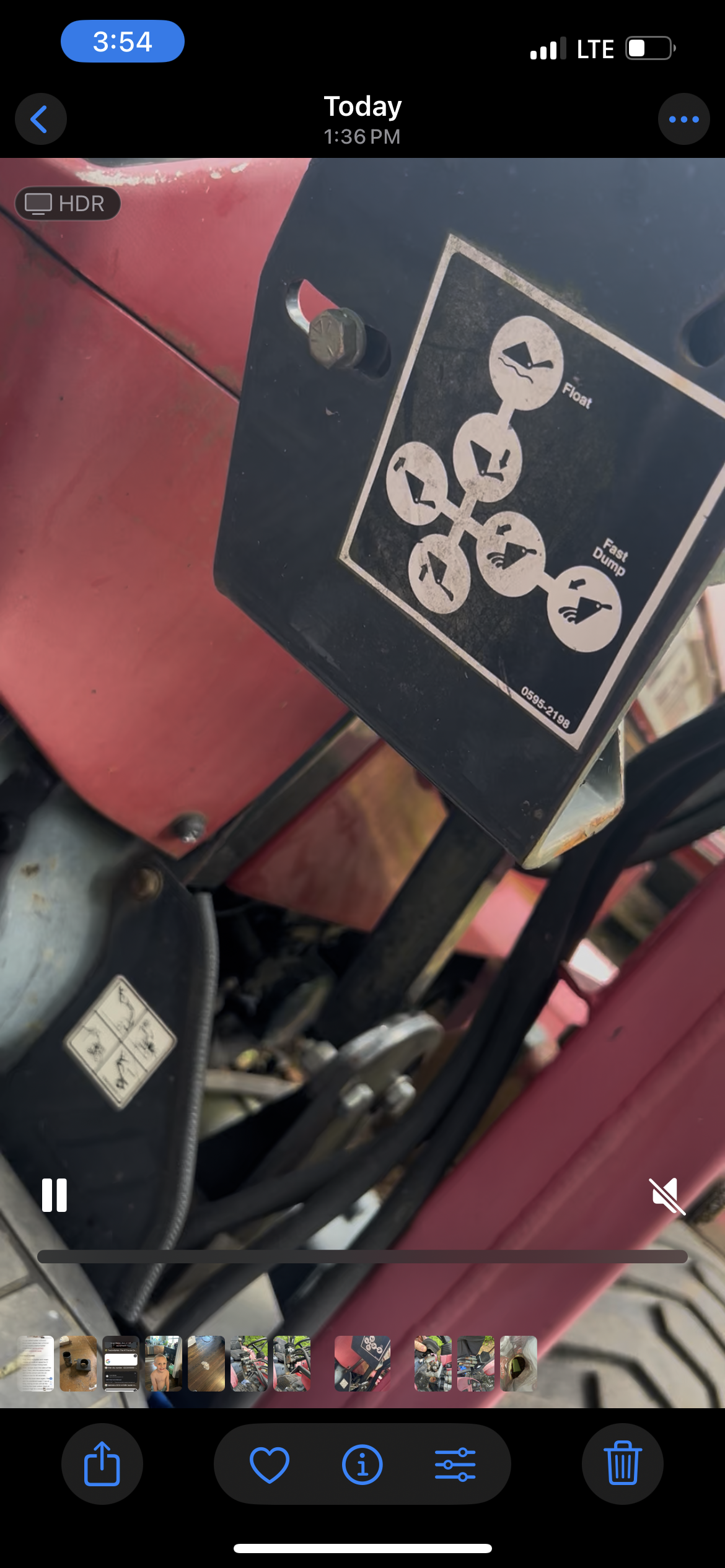

Yeah, it’s on Mahindra 3510. I attached a photo of the little diagram attached to the control valve. It shows to push it forward almost in a detent manner, but it won’t allow me to push it past the loader drop

OK, those caps are the same length because you should have the detent setting to the top and to the right.
If it does not want to go into that position it may have something loose inside the springs or they are seized up in the valve.
I was wondering about it being a 2810 because I have only seen 2810s with a dash and levers like that. But I have not seen many 3510 hydros.
