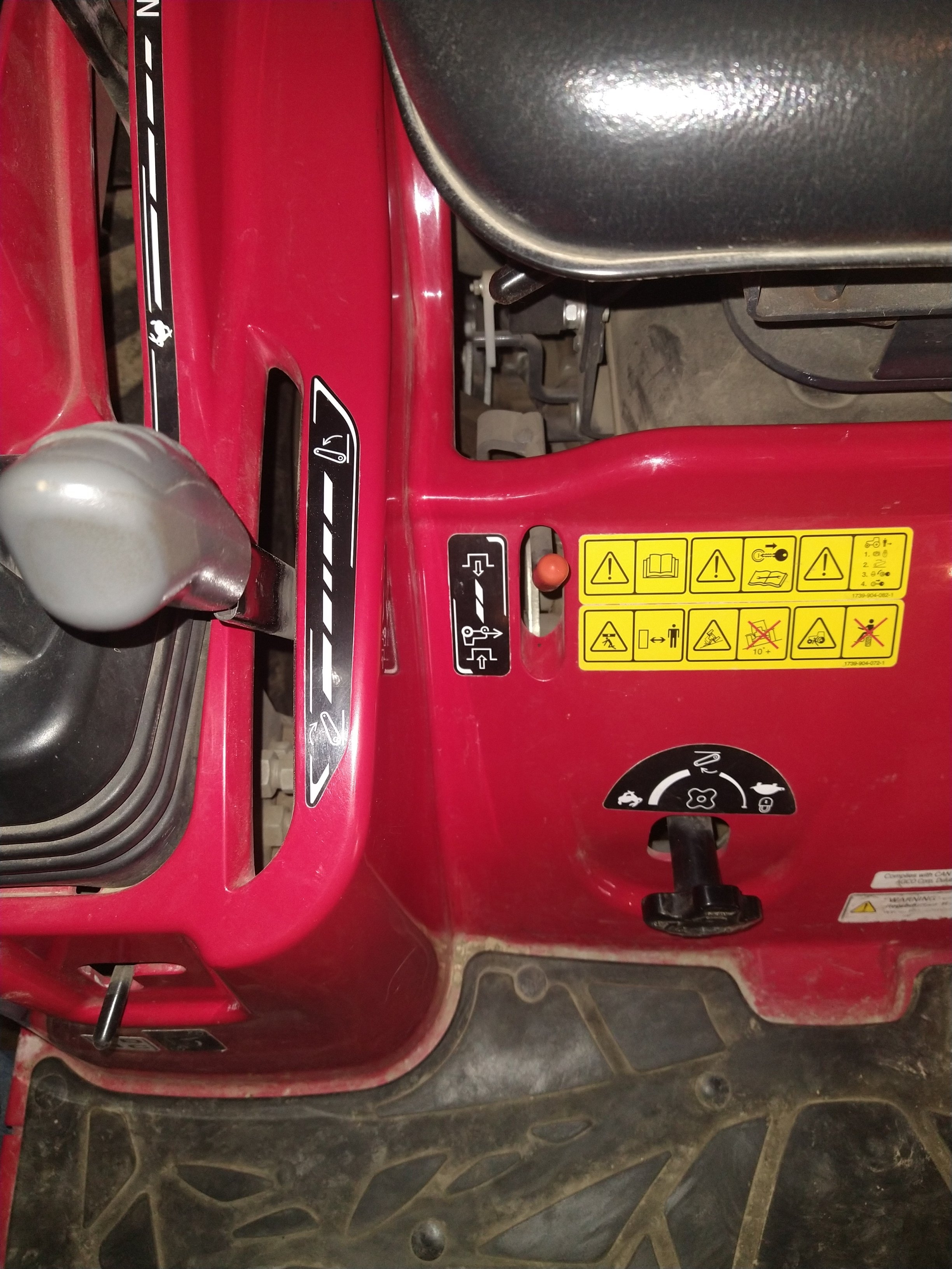

those locks / stops are pretty universal.
should work with most brands that use levers / slots like the pictures show.
they simply friction / cinch down and stay in place until knob or cam loosed.
a stout shroud on 2 sides of level and all should work.

no I have no stop lever my 3 point control has a spring so pushing it down drops it and when you let got of the control the spring returns it to the neutral position. to raise the 3 point you pull up, when you let go the lever goes back to neutral which I presume is actually keeping pressure on the 3 point hydraulics to keep it in position. Thanks for the input!

Yeah, that's the same as my GC 1725, which is just a newer version of your ...
I'm not sure of the official name for the valve, but move the handle forward the 3pt drops until either you let go and it returns to center, or it hits bottom, it will then stay in that position until it's raised, by moving the lever backwards from the center position it raises it ... The rate of drop can be controlled by the knob by the floorboard, which can also lock the 3pt from creeping down (but not up)
It doesn't have "position control" like my Kubota ... On that, once I know what height I want the 3pt at, I just move it to that number, the lever stays in that position until I move it up or down, say I was rototilling, and knew that #3 was good, at the end of the row I'd lift it by pulling it back past #8, then once I had turned around and was ready to till again, I'd drop it to #3 again and it would be in the same position as before.
With these little GC's it's more of a guess and eyeball it type of thing!

If your 3-pt lever has a down stop to set how low the implement will run, the bottom side of the same stop also limits implement float from raising. That' s the way all of my Massey tractors came from the factory.

Indeed drop the implement as soon as your rear tires hit a high spot the implement is no longer contacting the ground going to try a chain as my top link which will give some slack otherwise will lock the control in the down position until i need to raise it at the end of my round. Thanks for the input!
