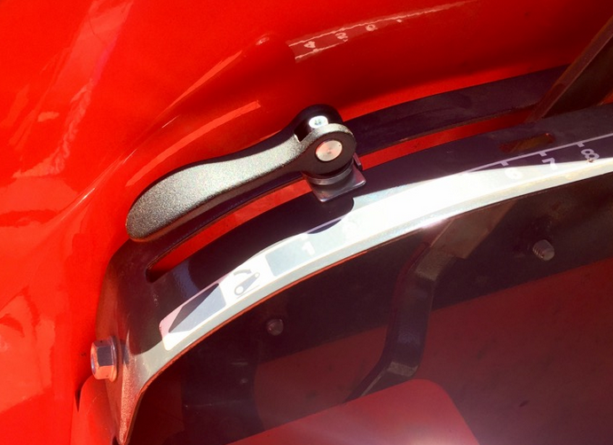

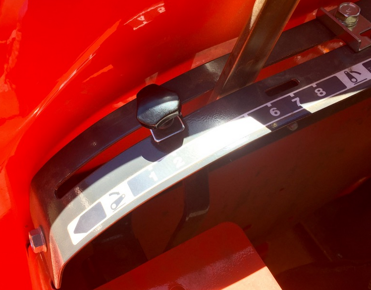

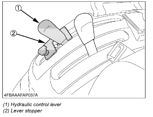

Kubota / Ford / etc... make hydraulic block lever locks / lever stoppers.

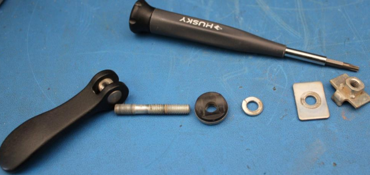

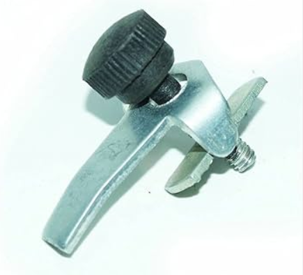

Maybe these factory made parts would work. I have used for years as I need to lock down the 3pt lever in the down position when using my BH65 BH. About $10 - $20 depending on which one may fit. EBay and Amazon also have lots of options for lever locks / stops.
View attachment 5405221View attachment 5405223View attachment 5405224View attachment 5405225View attachment 5405226
my 240 massey has these stops did not know there were locks will check it out I would have to find a lock that can be released easy since using a disc or dethatcher I have to lift up the implement at the end of my round. Thanks for the tip!

those locks / stops are pretty universal.
should work with most brands that use levers / slots like the pictures show.
they simply friction / cinch down and stay in place until knob or cam loosed.
a stout shroud on 2 sides of level and all should work.
