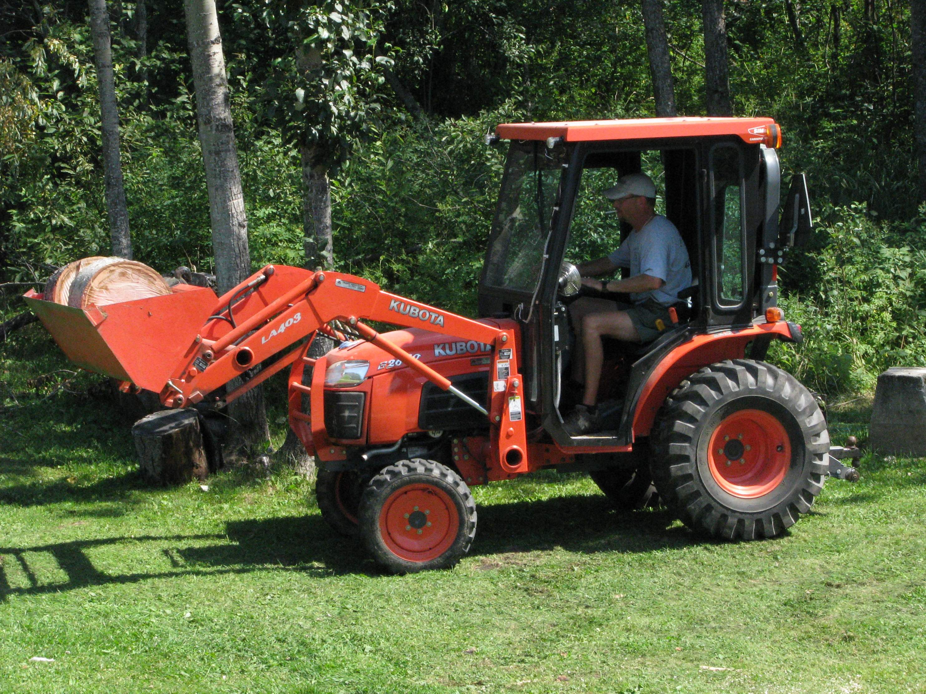

I am wanting to buy a Kubota tractor and not sure what model would be best? My uncle is selling his " 2009 B2630 with loader and heated cab"with about 600hrs on it. Its in very nice shape and uncle Cliffie is pretty good at doing maintenance on his stuff. He had a 73hp Kubota for about 15 + years. He had good luck with it. They have sold the family homestead and moved to town( He's fighting the big " C " but he is winning). I want to put a 90"QH Kubota blade for snow on it ,5'snow blower and a 72" finish mower. I am pretty sure the B-2630 will handle these attachments. If I am wrong do please let me know. He is asking $18000.oo for the tractor/loader. Is this a little rich or the going price. I will post a pick of tractor.

Kubota publishes an implement guide in every manual, for all its tractors.
That data sheet would be where I would start before assuming I could run this blower or that blade, etc. Kubota still has that tractor on its website here:http://www.kubota.com/product/B2630/B2630.aspx
Look at the size of the implements Kubota recommends.
As for the price, do yourself a huge favor and shop at TractorHouse.com for a similarly equipped model. Be sure to deduct 10% from the "list" price stated, as very, very few tractors listed ever sell for their asking price. You need to be armed with this objective information.

Here's another attempt to assist you in your decision. A Kubota B2630 only has 19.5 PTO HP. I, for one, do not think that this model would have the sufficient HP to utilize the attachments that you mentioned in your question. I own a Kuboto L4400 and can testify that Kubota products are well made. But there are several other manufacturers out there that make excellent machines also. I also agree with the other member's comment in regards in dealing with relatives. I am against it too. But that is your decision, and yours only. Good luck and Happy Tractoring.:tractor:

Like bp said, the best source would be the manual. My 2920 (next frame size down, with 29 HP) will only handle a 50" snowblower and a 60" blade (I think).

Off-topic: since when do B2630's come with CABS--even as an option? And I keep thinking the model number visible is a B3030--or is it the Heinikins talkin'?

PS It is a 26 with after market add on .......... I just got a 27" screen and new tower , so I can now see heaps more than the laptop-days :laughing:
