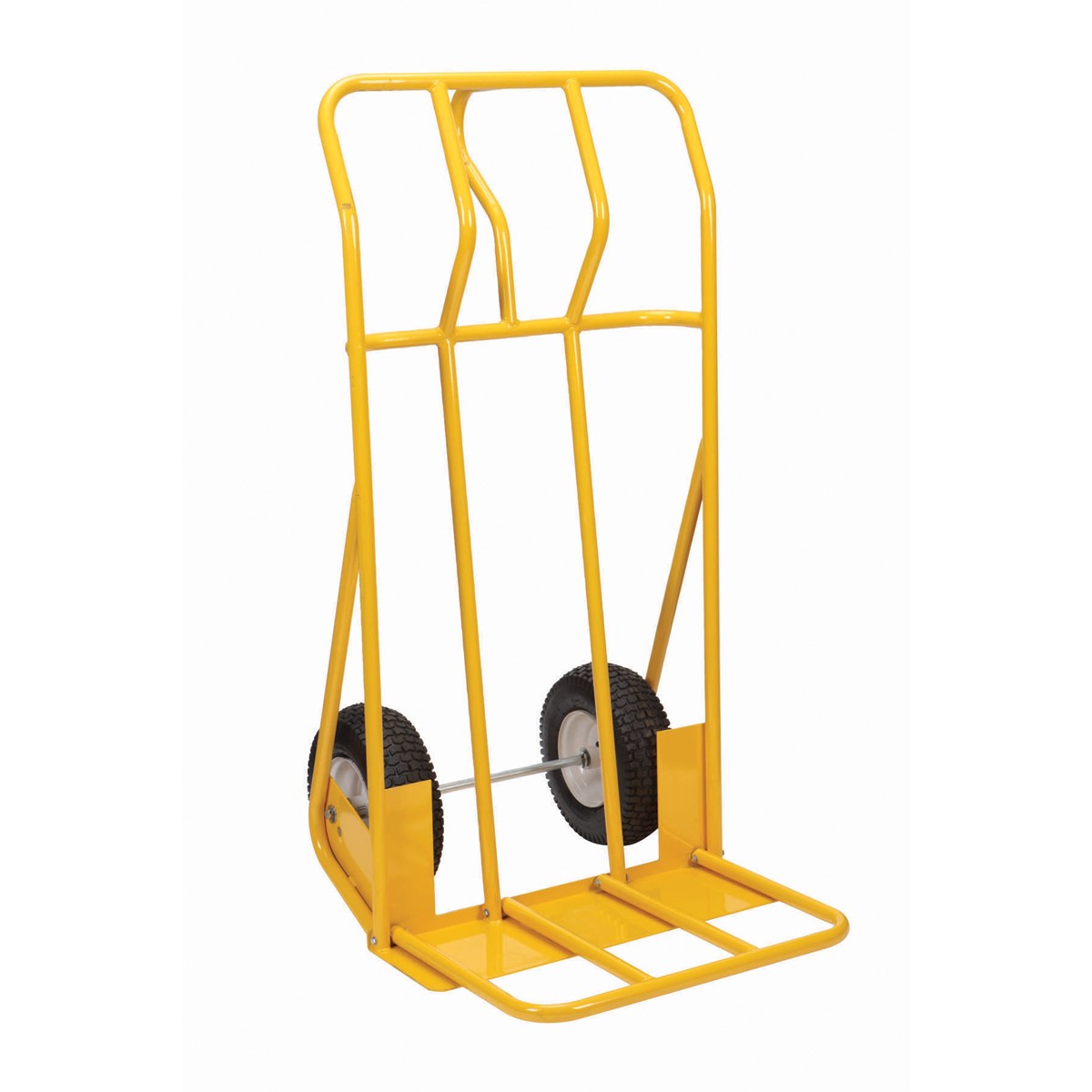

/ Need ideas for a hay cart
We've tried the wagon route and they are too tippy with the hay bale on top, for some reason they make the axles so narrow and tires too small! We've also done the wheelbarrow and rubbermaid cart and bales are too big for rubbermaid cart.

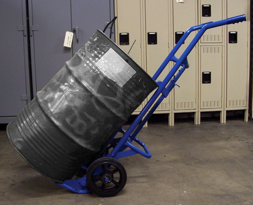

I would really like it to be something she could wheel up to a bale and just scoop it up. Needs to keep the bale low to the ground for gravity.
/ Need ideas for a hay cart #5
If you were building your own, you could make a 4 wheel wagon with wide wheels, perhaps dropping the bed down to the axles, although the steer axle could be a problem.
A drum hand truck isn't any different than a regular hand truck, except perhaps with a holder optimized to pick up the lip under a barrel.
I've seen people use the Rubbermaid Carts with ONE bale quite effectively. The large (and expensive) carts, of course. How many bales do you want to carry? Perhaps you have much rougher terrain than I was thinking.
So, if you're building, if you don't like the 4-wheel cart, then perhaps something like the two wheel wooden garden carts.
The trick would be to get the balance right so there is just enough weight on the handles. You could put large or small tires on it, although the tire size may also determine tire placement.

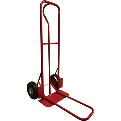

For one bale at a time, use a regular pneumatic rubber-tired handtruck. Stand the bale on end, use a cargo strap or rope to secure it to the uprights and pull it behind you. <70lb bales are easy to handle this way, and can make it over reasonably bumpy/muddy ground with ease.
