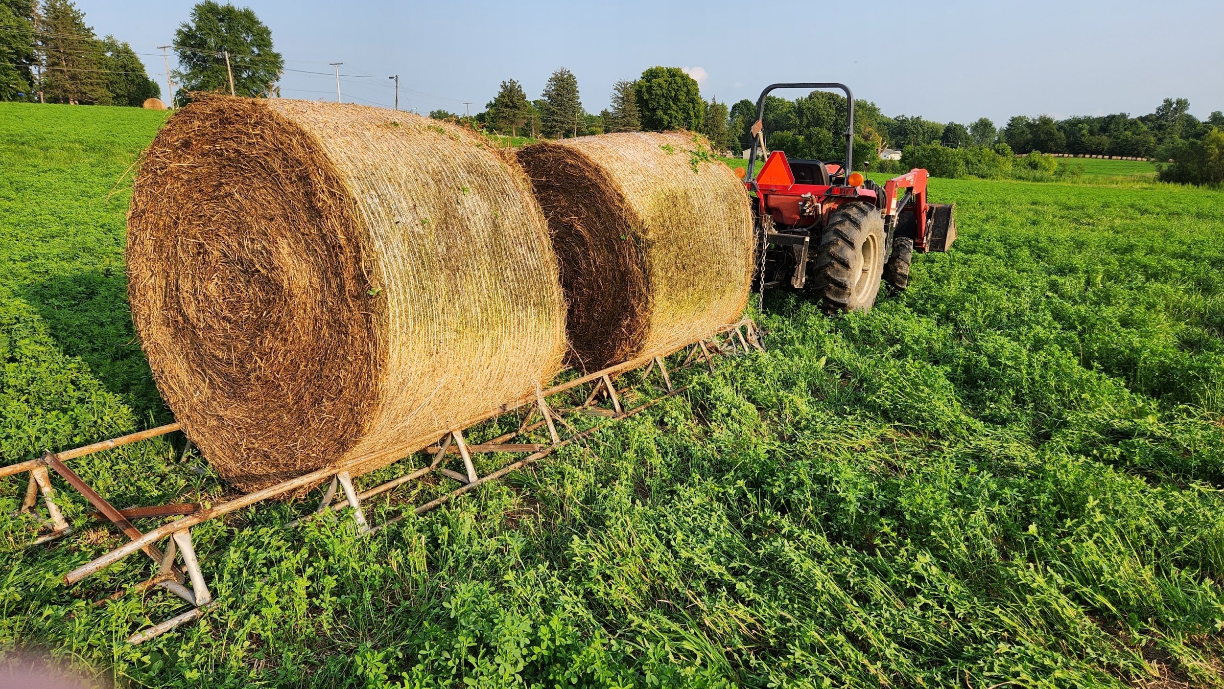

I built a prototype hay sled to move round bales that are too heavy for my MF1250. I'm having a 3rd year engineering class engineer something that should hold up much better. There is a local student run high school fabrication business that I plan on talking to about listing them as a product. If interested, you would be buying from them, I'm just facilitating the project.
The sled worked well for me. It didn't tear up the field and reduced my number of trips. I expect the final sled to carry 4 bales. How many folks are in my position with one tractor that is just a bit too small for hay?
Any thoughts on requirements that I should give the student engineers? How many bales? I'm targeting a 30 hp tractor. The hitch point should be high enough to use the 3 point hook without dismounting. Light enough to put on a trailer with a couple of guys. Short enough to trailer on a car hauler (maybe it's two sled chained together?). Maybe a rear set of wheels so it would work as a poor man's low boy.

So here's my Engineer's Cap input: Fundamentally, your sled is too narrow to remain stable if & when turning will be needed for maneuvering. Assuming a 3' c.g height for the bales, the sled should be about 6' WIDE to safely transport a product to be purchased by retail customers and avoid product litigation (if that's where you are going with this). You could add 'outriggers to do this job, but it's extra weight and cost. Just recently a man was nearly killed when a similar device in use dropped a round bale on top of him.
Then the 'bridge structure is not tall enough to support point loads at each end that are the expected weight you will be carrying. It looks to be a similar to a hay elevator bridge. That would have an additional center support pier. If it's to be a 'sled', then you need wide 'runners' to support the expected weight assuming a nominal sliding coefficient of friction and soil compaction.
Then there is the 'Answer to a question not being asked'. If getting hay out from a field with insufficient lifting capacity, I'll point out my own situation. I do hay all by my self, my solution for minimal cost and tractor power is square baling and a NH Stack wagon. My 22 hp Yanmar handled all of these tasks just fine (although i'm up to a 35 hp JD 1070) : NH 479 haybine, JD square baler, and a NH 1012 stacker. The stacker has dump as well as single bale unload. All of this works with any strain on me, my fields, tractor, my accountant, and my customers. I should point out that this solution has triggered additional 'at barn' inventions: squares into rounds and rounds into squares. Each of these technologies is applicable to safe handling of heavy, awkward, and legally tempting material handling needs & requirements.
But finding a use for a discarded space frame is the wrong way to go. First the need to move hay followed by a means to accomplish it is what your students should be challenged by, some of whom may already be dealing with your hay transport situation. Obviously a tractor or skid steer upgrade is the safest method I would pursue.

So here's my Engineer's Cap input: Fundamentally, your sled is too narrow to remain stable if & when turning will be needed for maneuvering. Assuming a 3' c.g height for the bales, the sled should be about 6' WIDE to safely transport a product to be purchased by retail customers and avoid product litigation (if that's where you are going with this). ...
Assuming the bale didn't slide off of the sled first and that the sled will not slide sideways, wouldn't 6' wide track allow you to pull 1G in the turn before rolling over? My tractor doesn't go that fast.
Why is a sled with a 4' track that puts the CG at 3' less stable than a hay wagon with a 7' track that puts the cg at 6'? The low CG should greatly increase the stability of the implement.
I'm missing something with the analysis, because it seems intuitively obvious to me that leaving the bales on the ground (or within inches) is more stable than lifting them onto a hay wagon that has wheels and no brakes.

... you need wide 'runners' to support the expected weight ...
It looks like 5 PSI is a good goal for ground pressure. So, very roughly 4,000 lbs / 5PSI = is 800 square inches. So a minimum of a 67" track 6" wide on each side.. though I'd want the skids in the corners, so 4 36" skids each 6" wide (or shorter and wider). Is that what you are imagining?

The sled doesn't have to be 6' wide, just wider outriggers to contain any sudden dynamic turn.
Tractors have tires which don't support a great amount of sideforce (by design intent). Your sled has rails that will 'trip' your load. Same reason a car will roll over on a wet, grassy field.
You have to understand the theory of "Forseeable Misuse". Designing it for the brightest, most careful user (probably yourself) is actually the idealization of your concept. YOU understand it's shortcomings and limitations. I would bet that someone else will try to drive it down a public road, sparks flying and hot metal starting a shoulder grass fire. Don't think this is funny. Its a sad situation I often faced working the auto industry. Wait until a drunk takes his kids for a ride and 1 falls off and run over.
