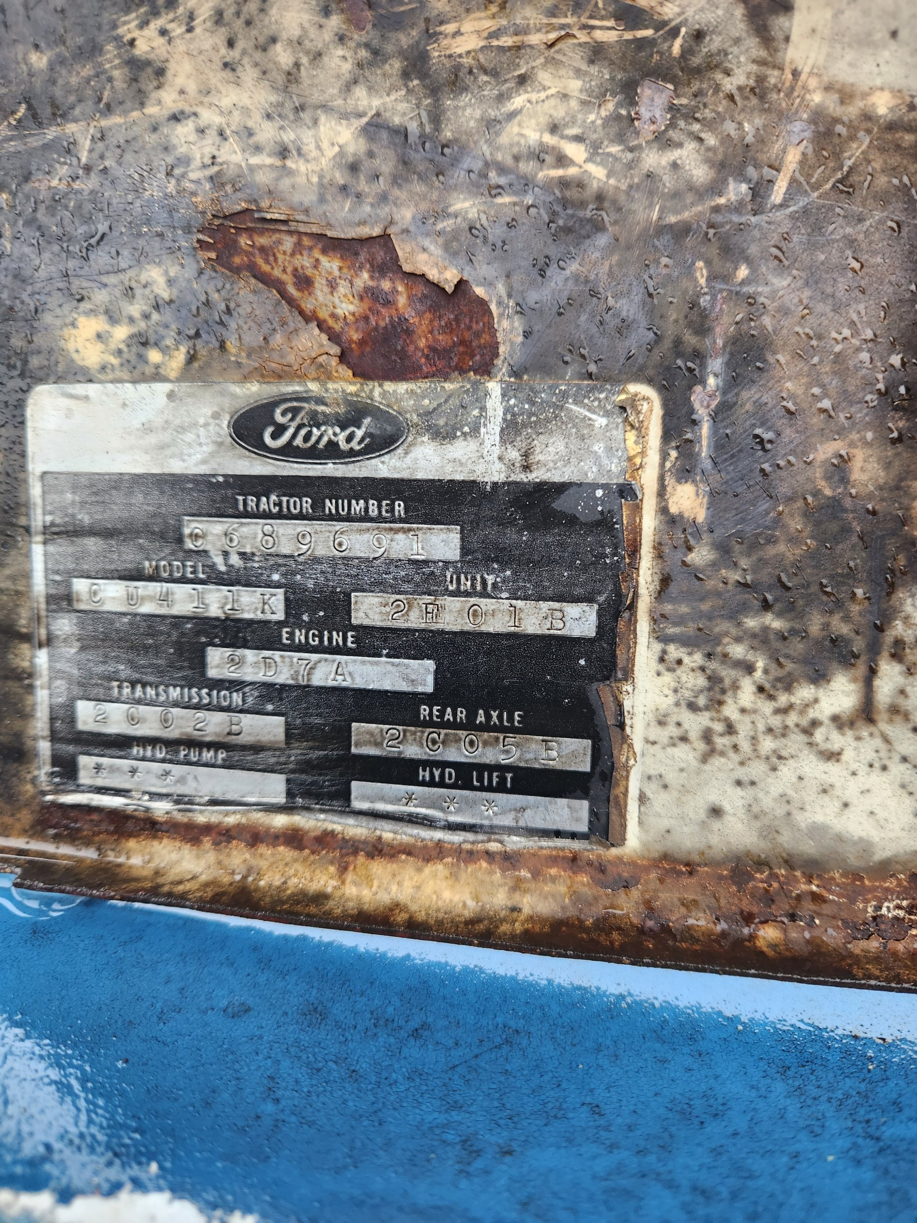

I have a Ford back hoe, but I have no clue what model it is. I have uploaded a picture of the tag under the hood.
The tractor number is c689691
The model is cu411k
The unit number is 2f01b
Thanks in advance.

The standard backhoe for the 3400/3500 was the 10 foot model 730.poer
C = power class, eg. 3000, 3100, 3400, 3500., 340 etc
U = Utility
1 = Diesel
1 = 8 Speed
K = PTO, probably None
This is tractor only, the loadet would be a Model 340, Backhoe 730
Don't remember so much anymore, been a long time since I was involved.

Model CU411K= 3400 diesel. no pto, 6X4 trans.
Built 2F01B = June 1, 1972, Day shift.
3400 built from '65 to '75.
Is your tractor blue or yellow?

Blue now but It might have been repainted.

Don't know why but after looking at the picture, I'm thinking that the loader is from a later tractor due to the link type mount on the axle support. But the ID tag info makes it a 3400. Leads me to believe someone mounted a later loader/backhoe on you tractor.
