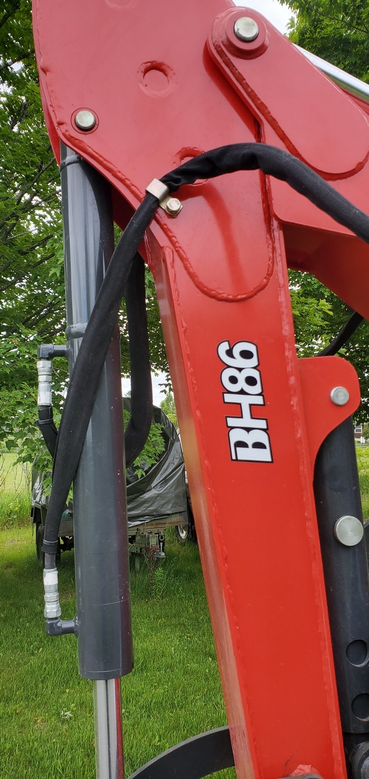

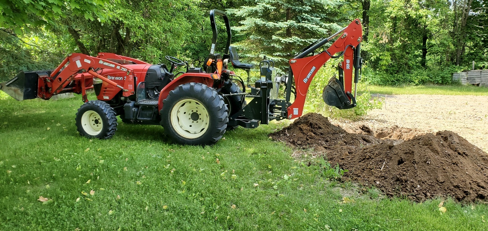

Hi All,
I got my used Branson in October 2023 [link] and have used it for snow removal, new gravel for the driveway and moving heavy things ever since.
I love having a tractor with front-end loader, snow-blower, pallet forks...... it has change my approach to and gusto for outdoor projects!
On lucky old Friday June 13th I brought home a used Branson BH86 back-hoe attachment.
First some photo evidence.......

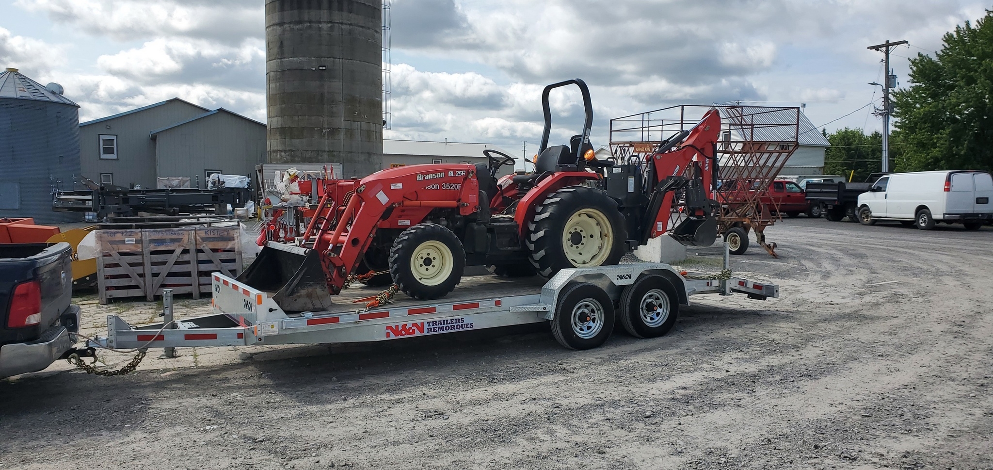

picking it up at the dealer:

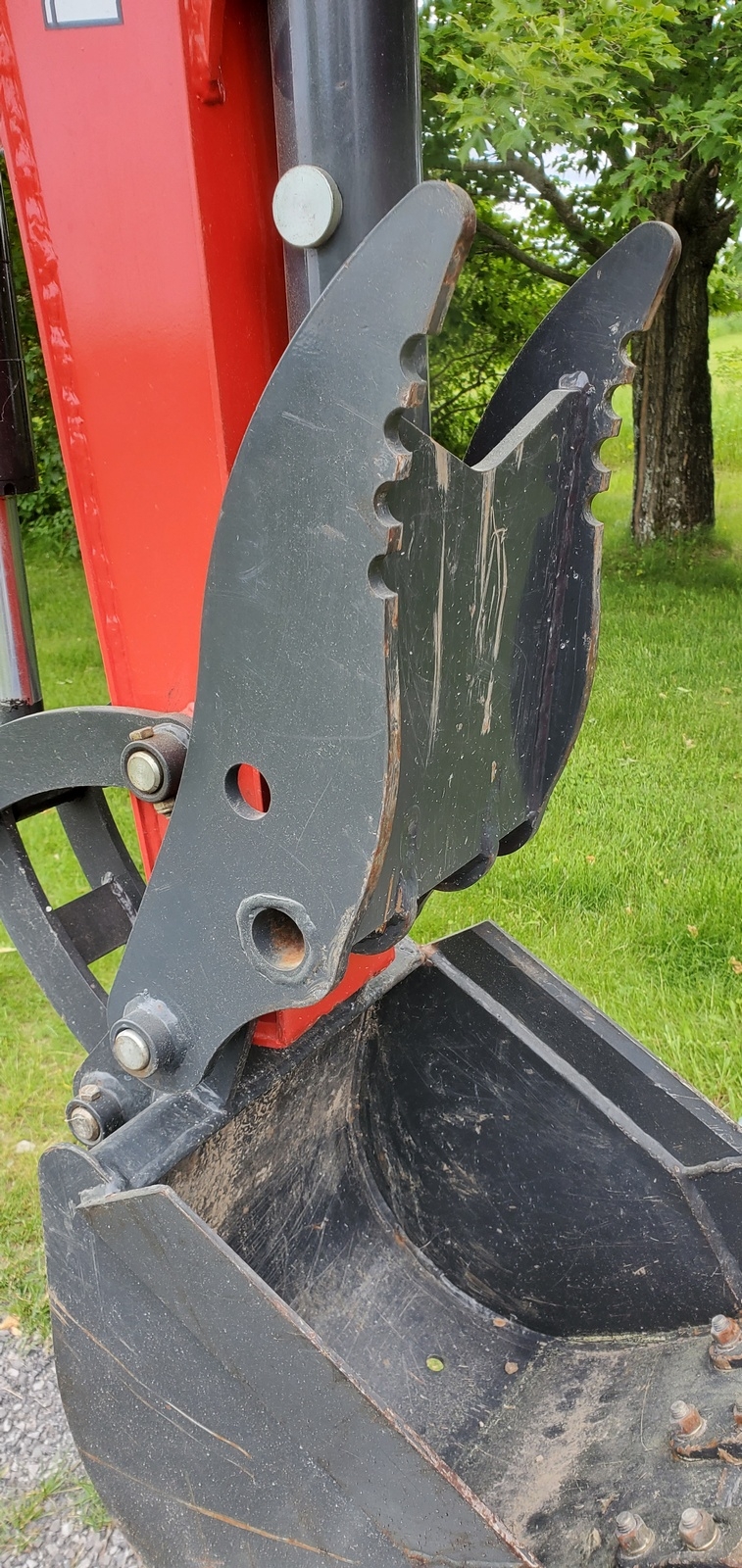

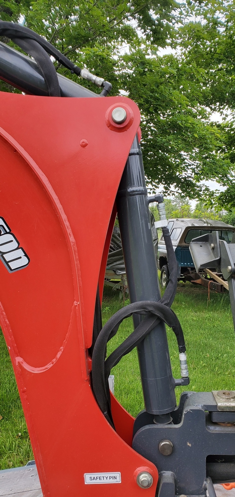

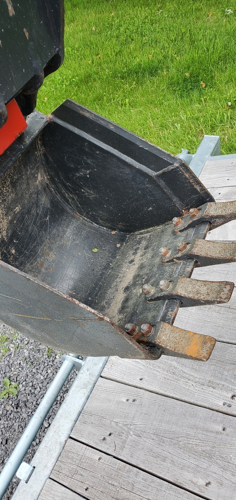

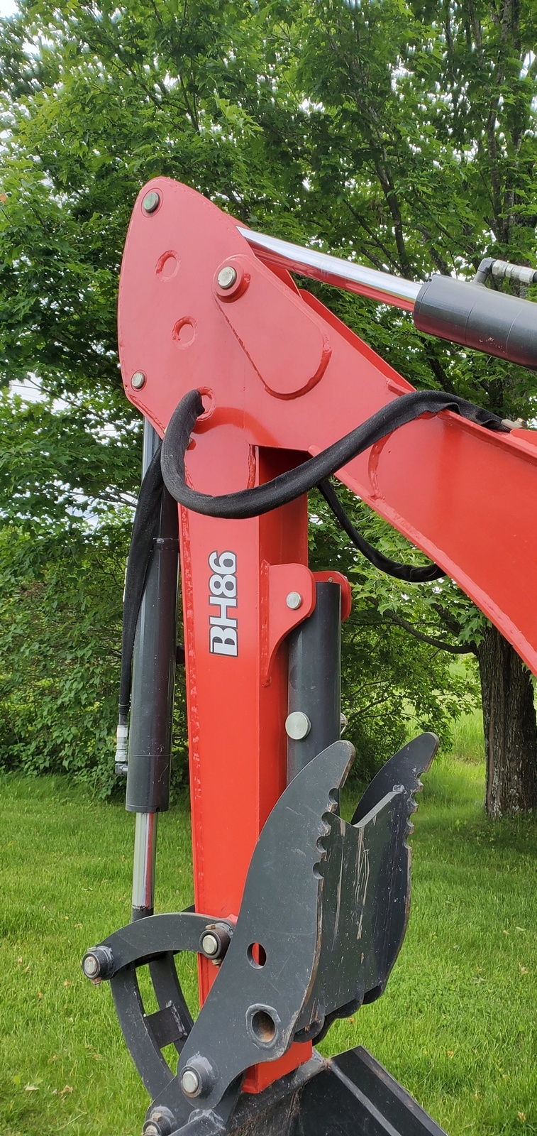

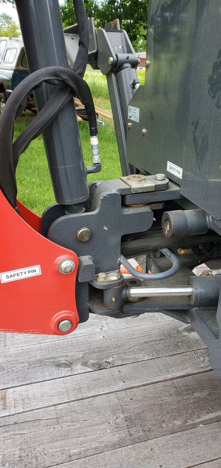

A bunch of close-up to show the amazing condition of the used back-hoe:

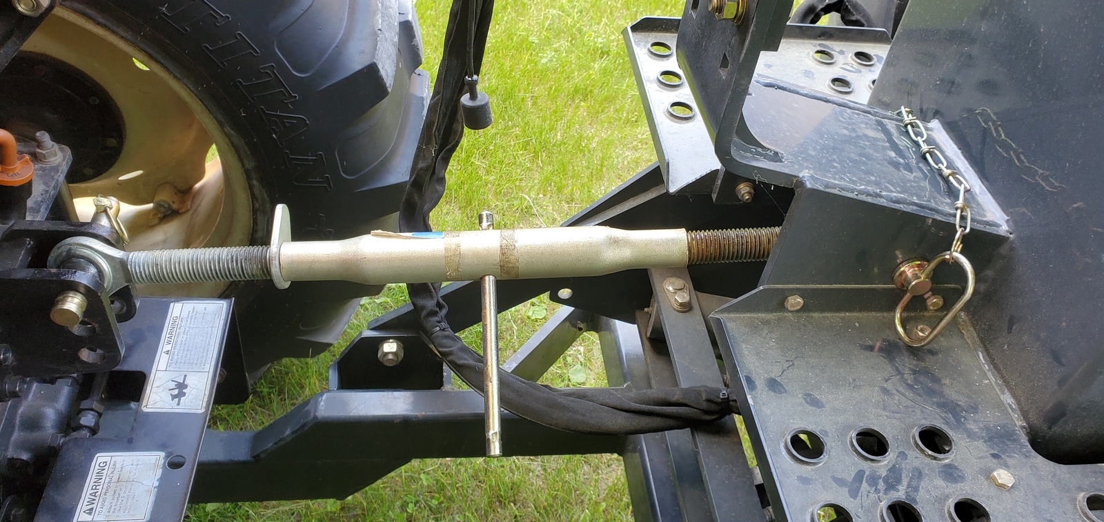

I found a place to add that top link after seeing the two posts here:
Branson BH86 backhoe weld/channel failure
and here:
Branson bh86 backhoe
I also already see the reason for the modification here:
BH86 / BH860 Boom valve 'speed' adjustment
....and finally some questions:
When I park the tractor with the backhoe attached, should I try to distribute the weight?
(I always lower the front-end loader bucket.)
If so, should I use the stabilizers, or place the bucket itself on a pallet?
Something else?
Although I cannot find an operators manual for my version of the BH-86, the operators manual I did find for BH350 model says:
Always keep cylinders in a retracted position when the
backhoe is not in use to guard against rust and
contamination which may cause damage to the cylinder
rods or hydraulic system.
....and sure I do see some logic in that, however, that leaves the resting weight of the installed backhoe on the tractor frame, tires, etc.
Thoughts?
What do you do and why?
Thanks,
Brian

Been my experience at the dealership where I work part time is people buy a backhoe and use it once or twice and then it sits. I sincerely hope your tractor has a subframe to distrubute the digging forces but from what I see (by the top link picture, it dont and that can cause rear case failure at some point down the road as the top link will fracture the top of the case casting behind the top link and you don't even want to know how much a new case costs. Last one we did. the rear case alone was 17 grand, not including labor. Total OTD bill was 21 grand. Needless the owner sold the backhoe and if he wanted to dig holes or trenches, he rented a mini-ex.
You can apply undue strain on the top link easily and the rear case casting is not at all forgiving.
Be aware of that....
Yes, mine is the full sub-frame model.
The top-link was added only after searching this forum for BH86 info and finding the two broken sub-frame linked above.
In fact the guy at the dealership that helped install for the first time said HE was the guy that removed it from the former's owner tractor, and the top-link was not used...... of course, perhaps that was just for transport.

Great condition. Couldn't help noticing there's no grease anywhere.
If one uses a something like a bh a cordless grease gun will quickly become your best friend I use grease with moly for all non bearing pins and pivot points.
Yes you are correct, most of those photos were taken before I even had it off the trailer.
Apparently the previous owner bought it to do a garage floor/foundation and then stored it (inside) for years, before trading it in.
Although I do need to go over it again carefully to ensure I found all the zerks.
