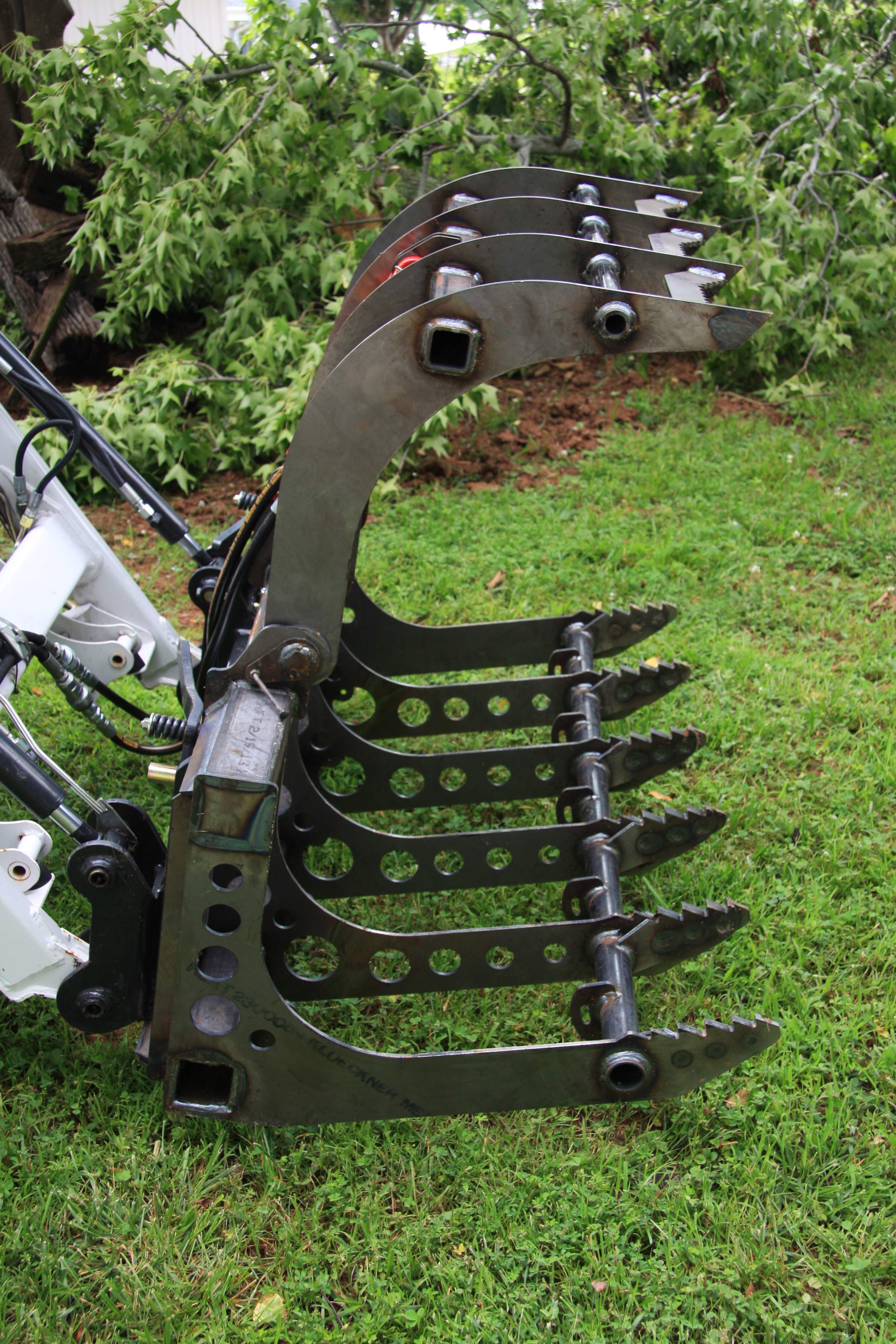

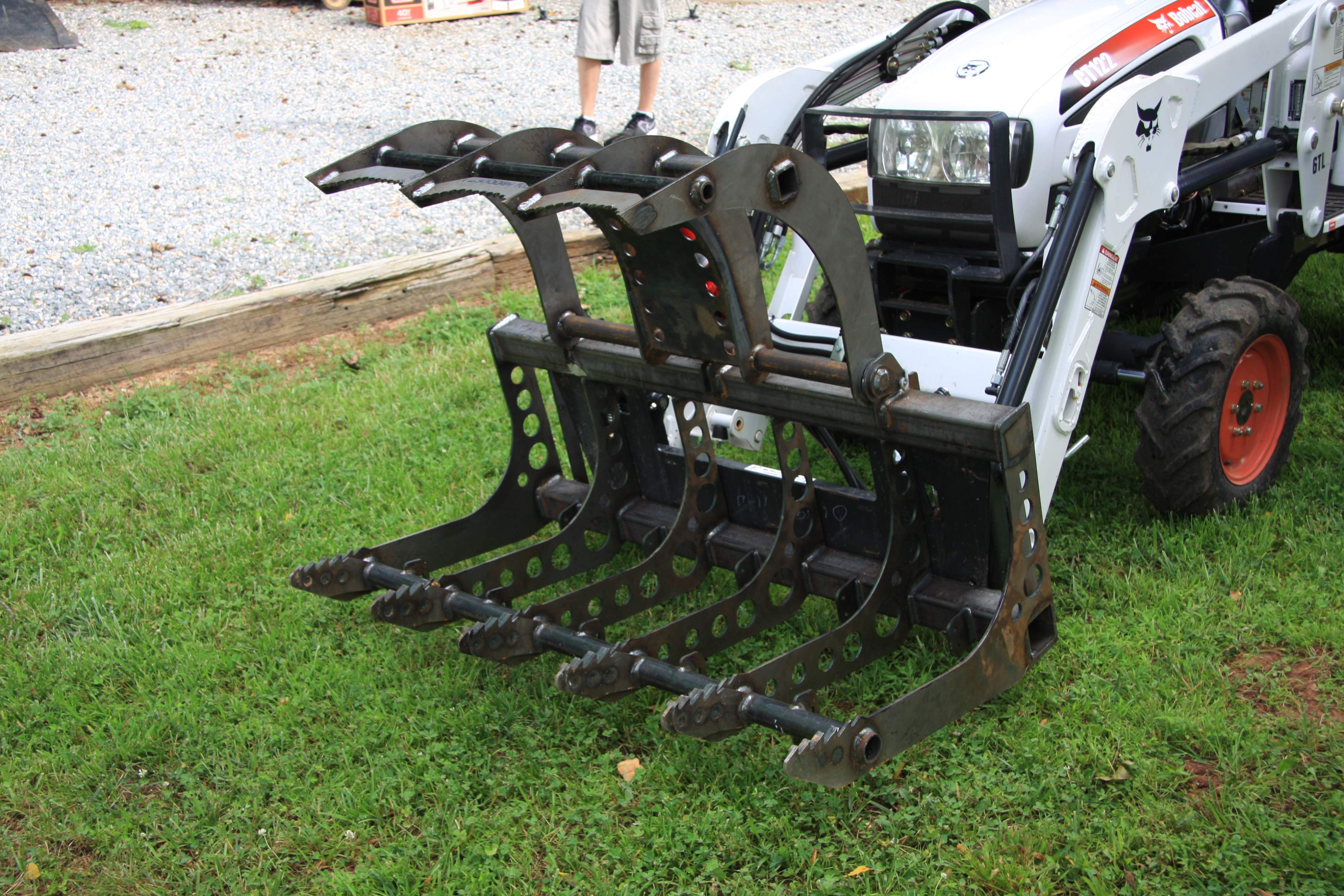

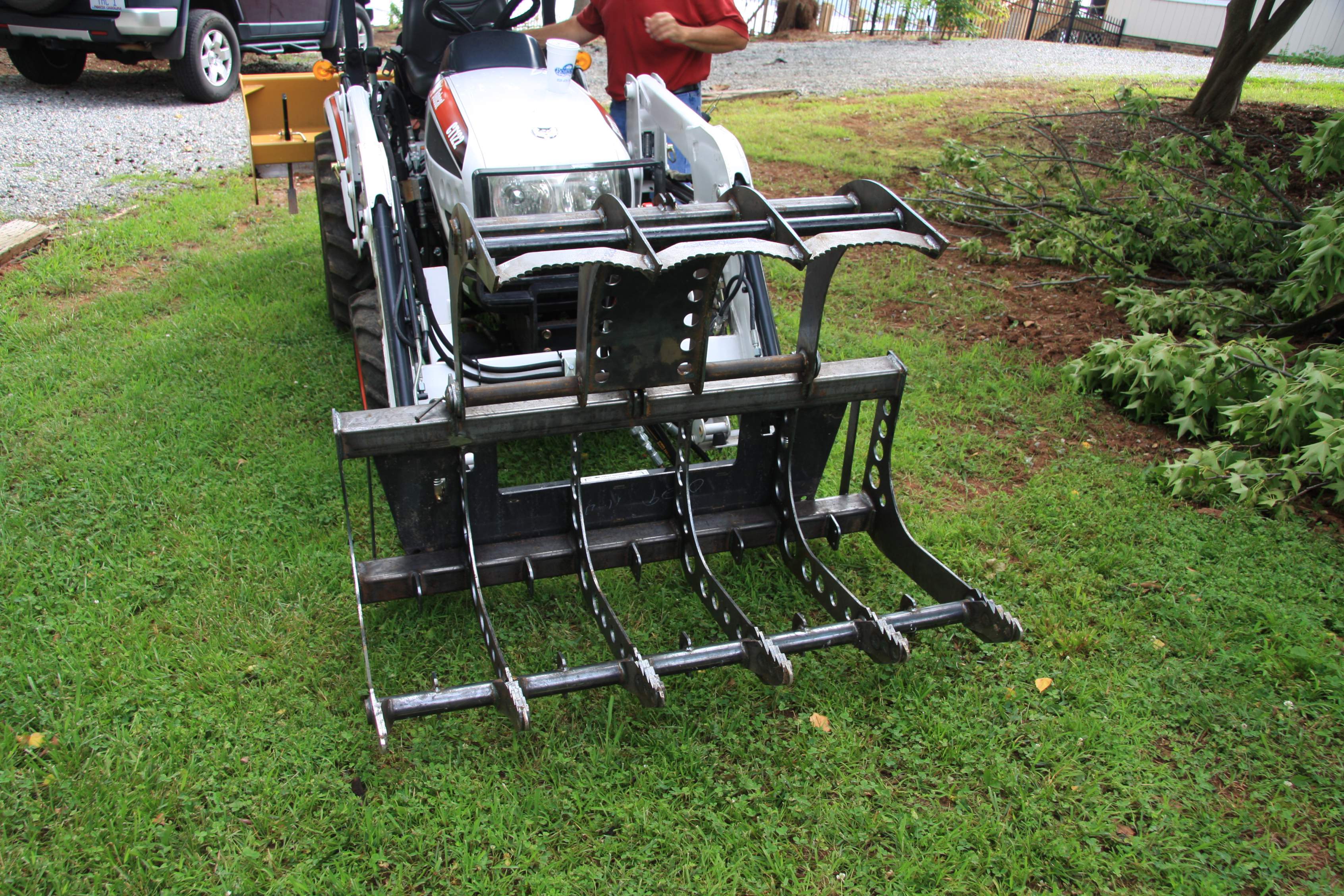

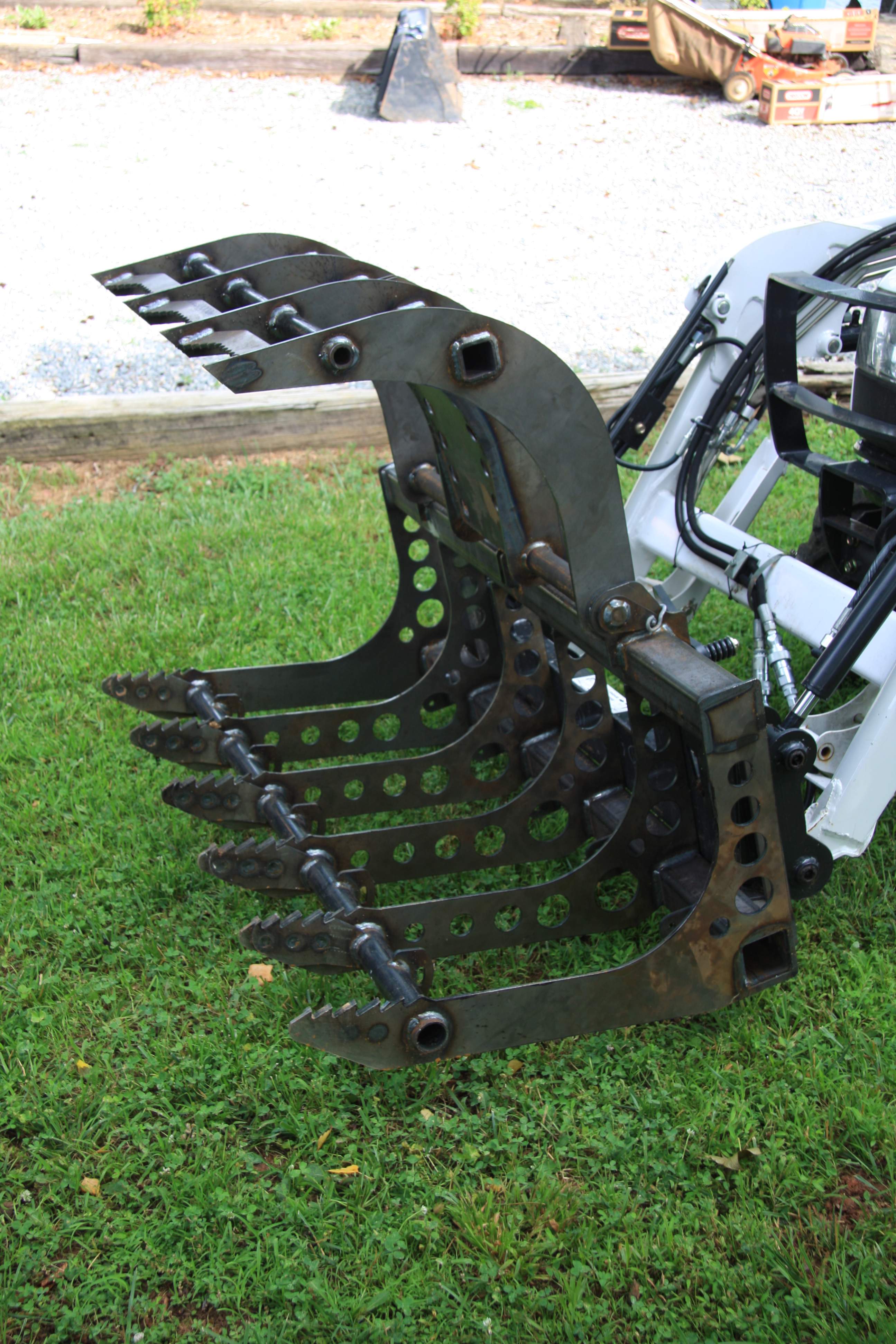

That looks just about perfect. I like the extra spacers. Any idea what the cost is?
I don't recall what I paid....it wasn't "expensive" relative to others. I've already call NAI, and their base price is a little over $1000....but I don't know what they are going to charge for the 1/2" steel or the spacers. But after the first of the year (money issues in retirement)...I'm buying THAT, built that way. And of course, shipping will be added.

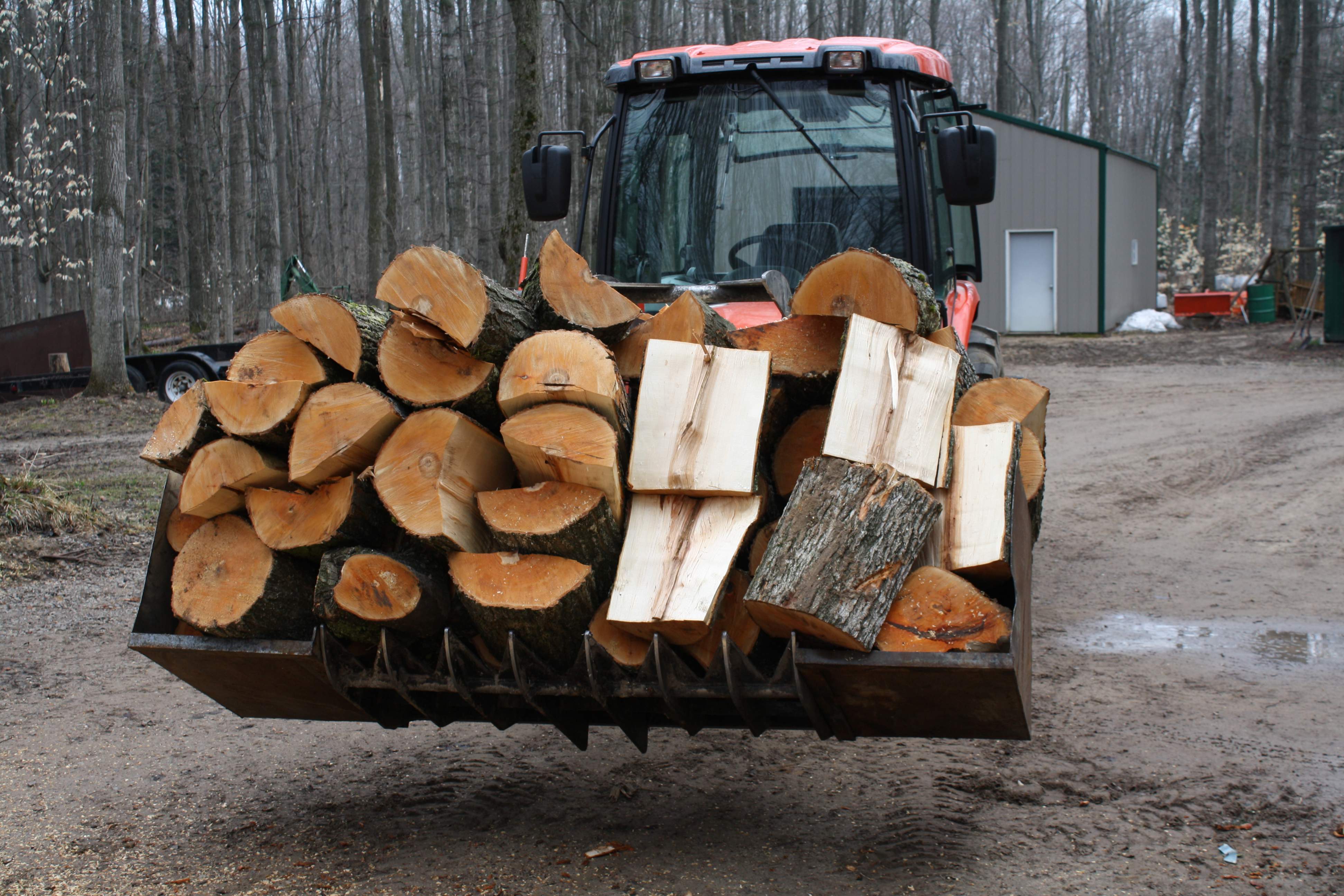

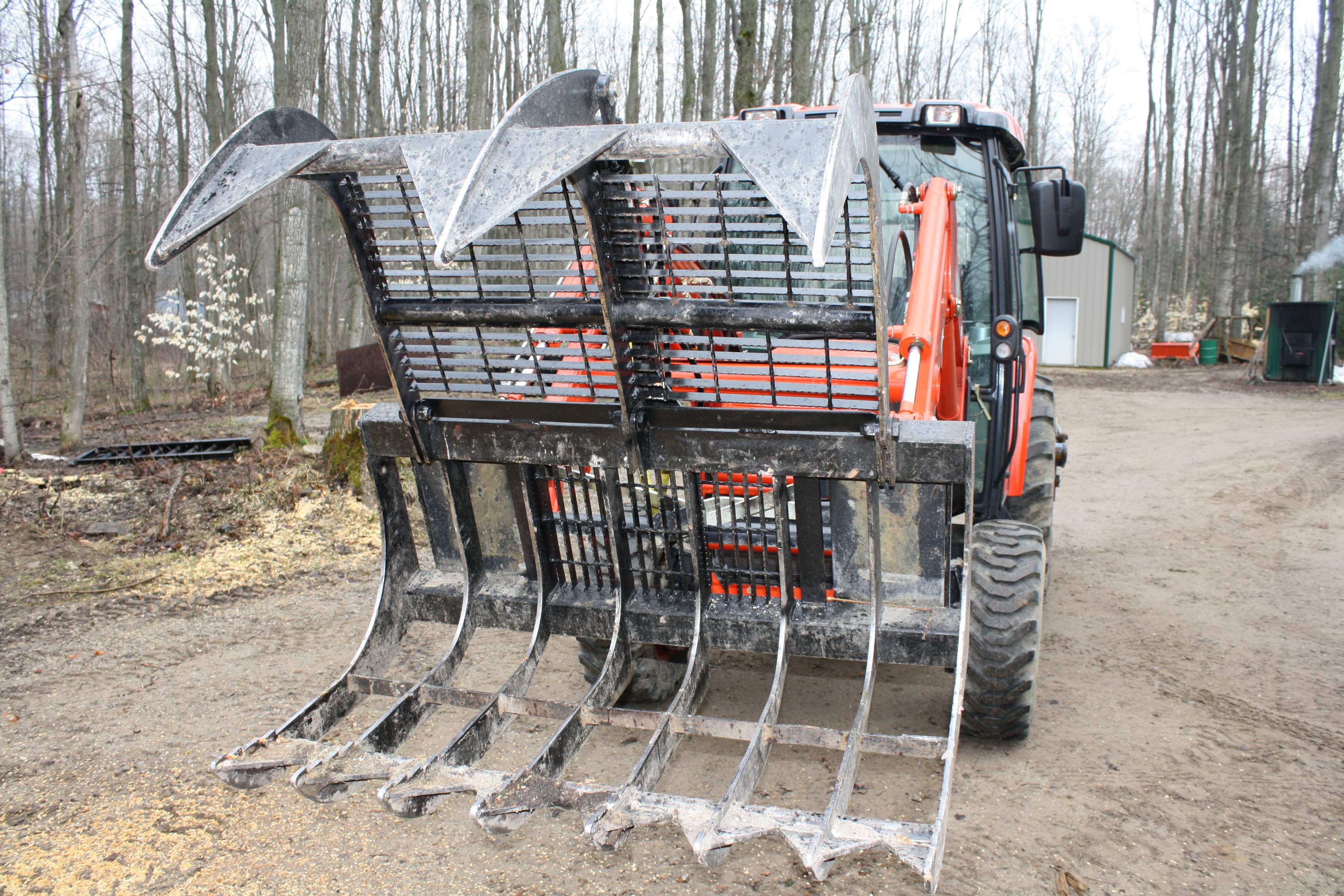

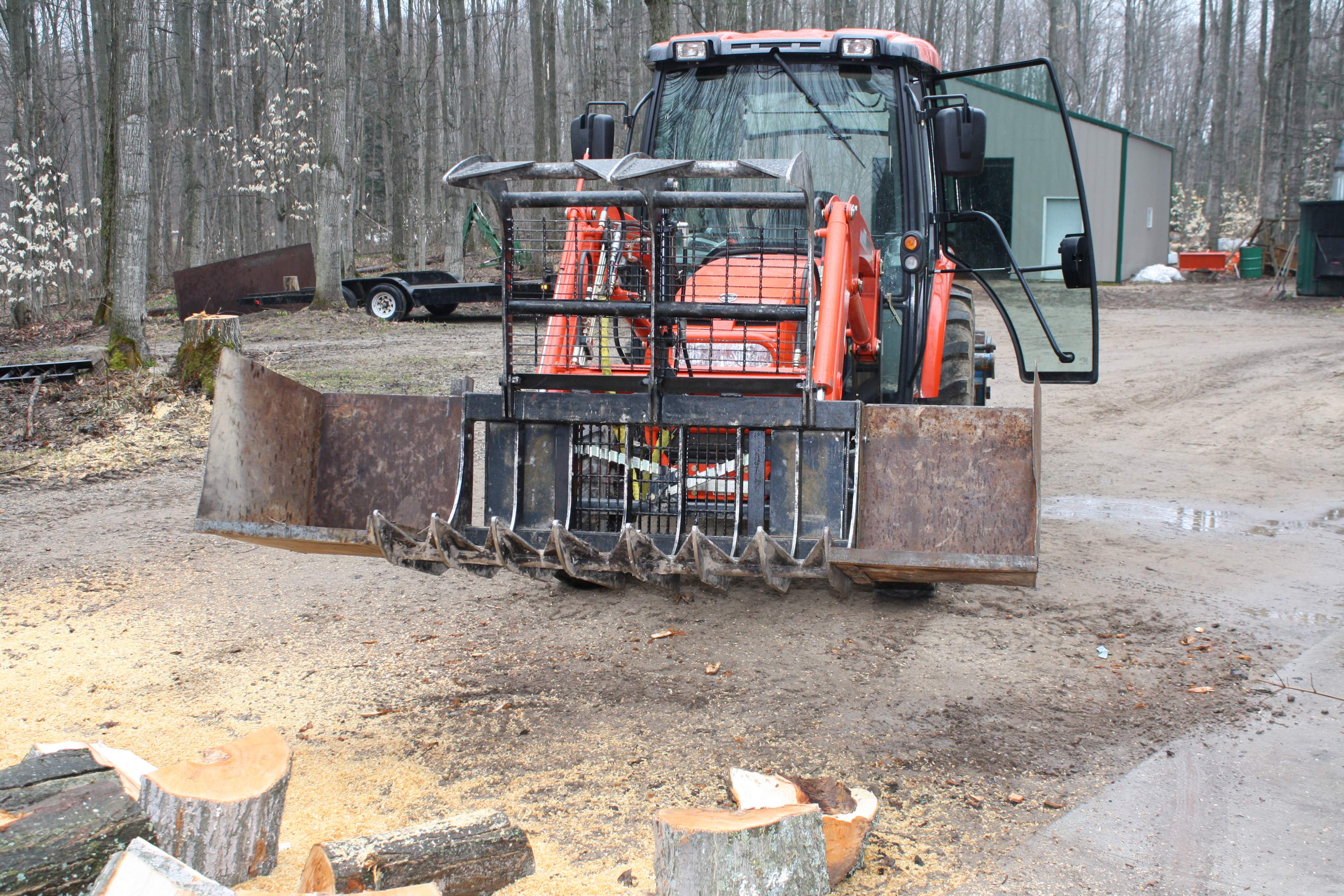

I just don't see the need for one to open wider than this:
View attachment 343884View attachment 343885View attachment 343886View attachment 343887
If it opened wider, the lid would have to be taller and the bottom tines would have to extend out further from the tractor, which would extend the tractor's center of gravity and lessen the lift capacity.
This would be a disadvantage, especially when pinching logs or heavy debris with a small compact tractor.......maybe not so much with a larger tractor.
The longer tines also reduce the breakout force.
Good points but lift capacity would only be an issue for smaller tractors. A bigger version of your Light Duty for 40+HP CUTs would not suffer. My 48 Millonzi has a 46" opening which is useful for collecting brush and also for big stumps. Maybe use 3/8 mild or high strength steel but keep the single wide lid and the removable slats.
So lift capacity is not a issue since your grapple tines are longer but you tell everyone to get a light duty grapple that weighs less so they can lift more?????????????????????
