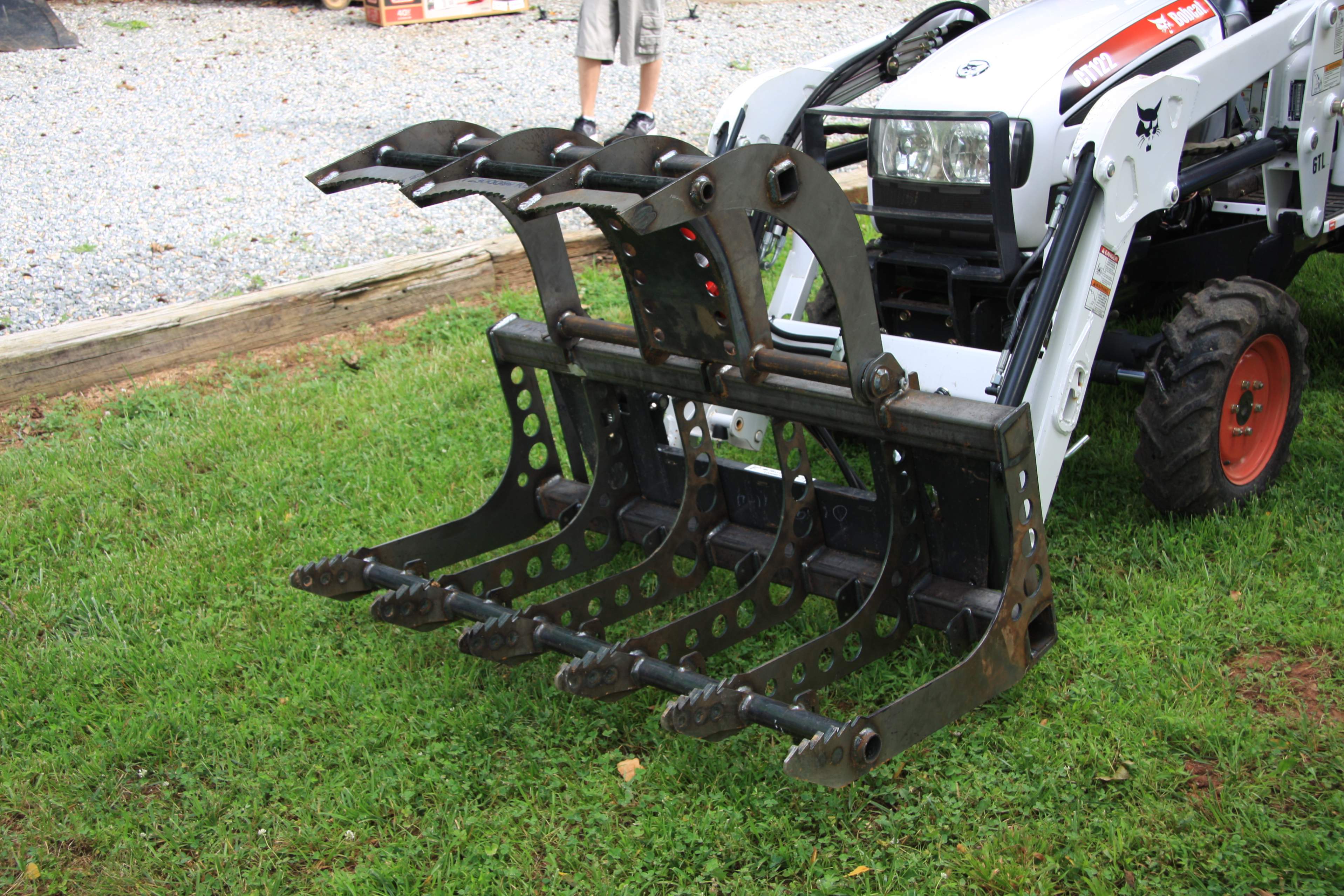

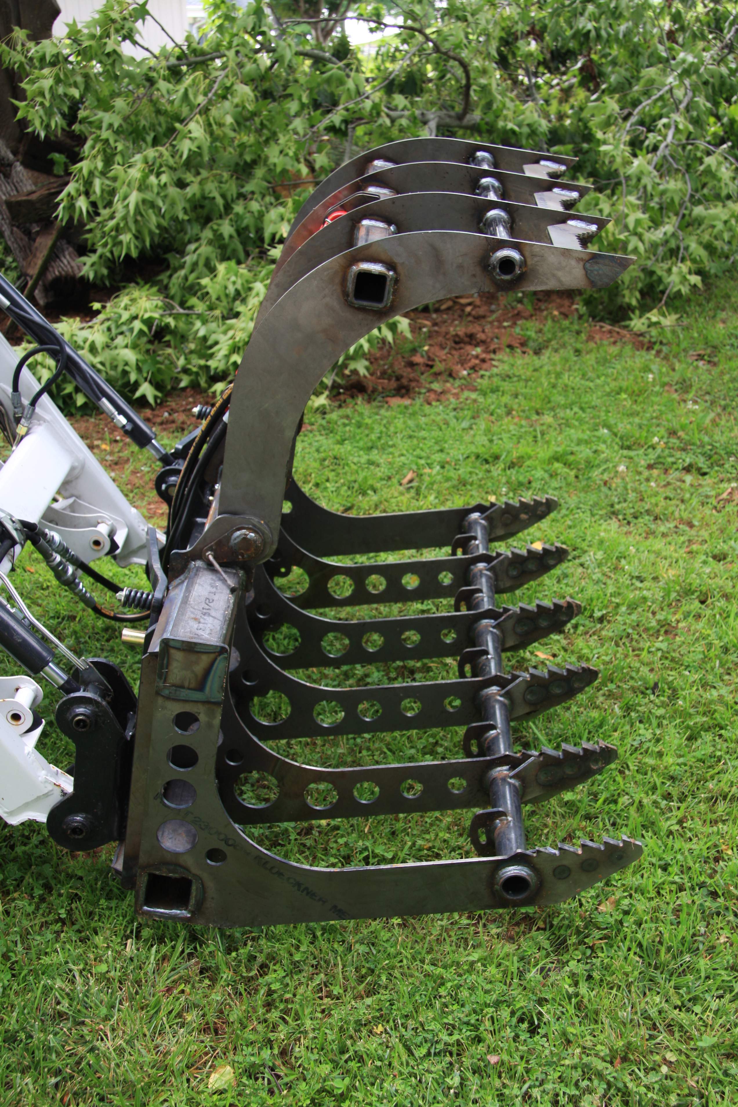

My grapple is now about 8 years old and is going strong. It has been mounted for about 400 hrs of work. It weighs only about 300 lbs and has spent most of its life on a heavy 40hp tractor with 2700+lbs of lift capacity. I use it aggressively in brush, tree, stump and rock removal. The 3/8" tines are still straight and adequate to any task I have tortured them with.
It is real easy in this business to get over excited by the concept of heavy duty or bigger is better. My "light duty" $500 grapple shows smaller works just fine too.

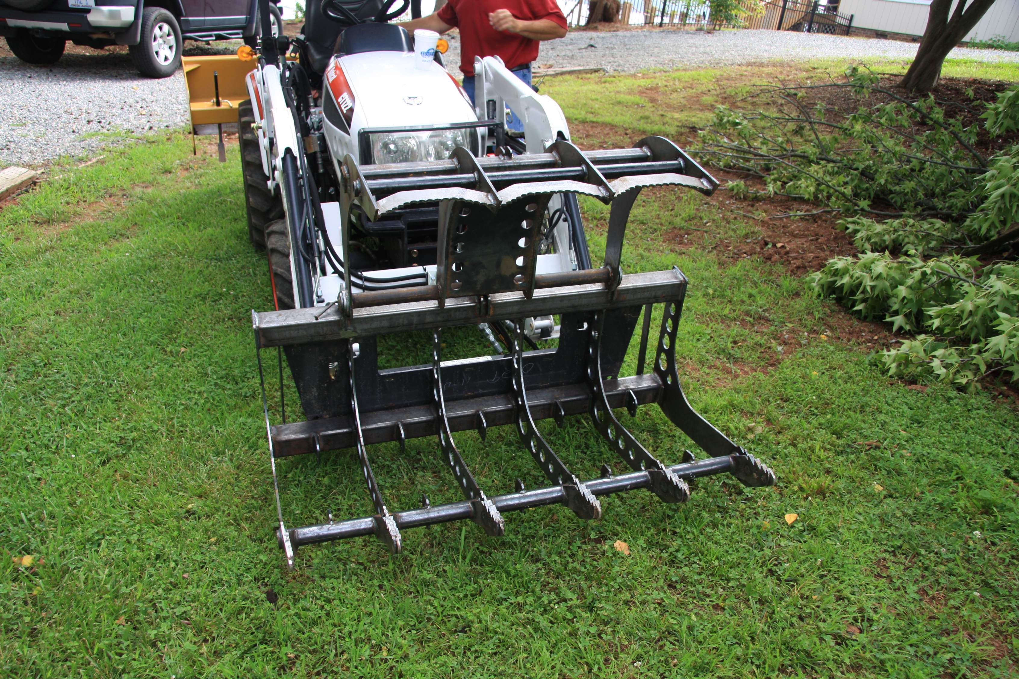

Here's a few action shots as promised... I cant believe I waited so long to get a grapple, they sure are useful once you get the hang of it!! I built a SSQA adapter to work with my Euro QA with universal SS conversion plates from Titan....it turned out to be a little too light duty for my needs so Im in the process of building a HD model to keep on it permanently. Im building my new SSQA based off the design of mwb(Mike) from TBN. I should be done with the new SSQA in a few days Ill try to post pics of it when its complete. I will also post a few before and after pics of my land clearing project once I get it all cleared and piled up. As you can see from my last pic it was a little to wet out to be moving brush around so I wasnt able to push my brush pile as tight as I would like without making pretty severe ruts. I look forward to finishing this field next week! Thanks again to everyone.

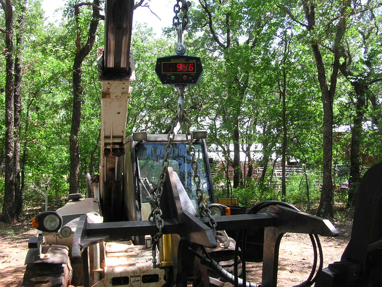

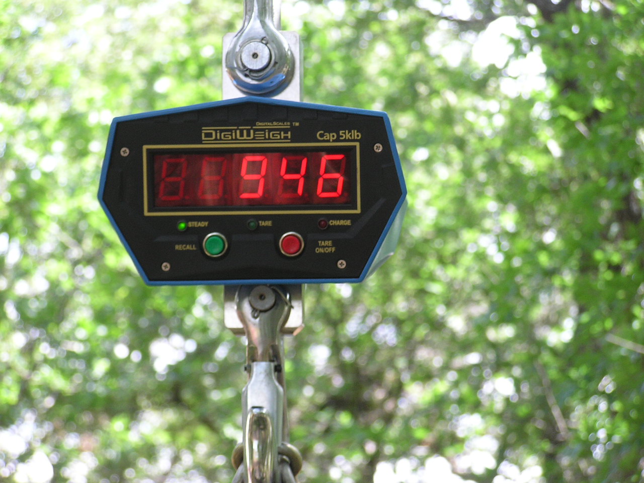

I have been wanting to install hydraulic gauges to tell how much load I have (more weight, higher pressure to lift load). Of course then I would have to calculate how far out the load is from the pins, how much the grapple, bucket or whatever weighs to subtract off. haha.
Where is faxman when we need him? I think he has an industrial scale.
/ Need help deciding on a grapple #218
Do the trucking terminals have a scale? If they do the next time someone gets a Titan grapple they should have them weigh it.
Hmm.. makes you wonder if some manufactures might "pad" their weight figures toward the high side, by including shipping weight on the theory that novice buyers will always tend to buy the heaviest as advertised product on the theory that a heavier product will be "better built" or something.. I am just talking thru my hat, but just an idea.
Do you know what kind of steel the 35hp and less EA grapple is made from?
/ Need help deciding on a grapple #219

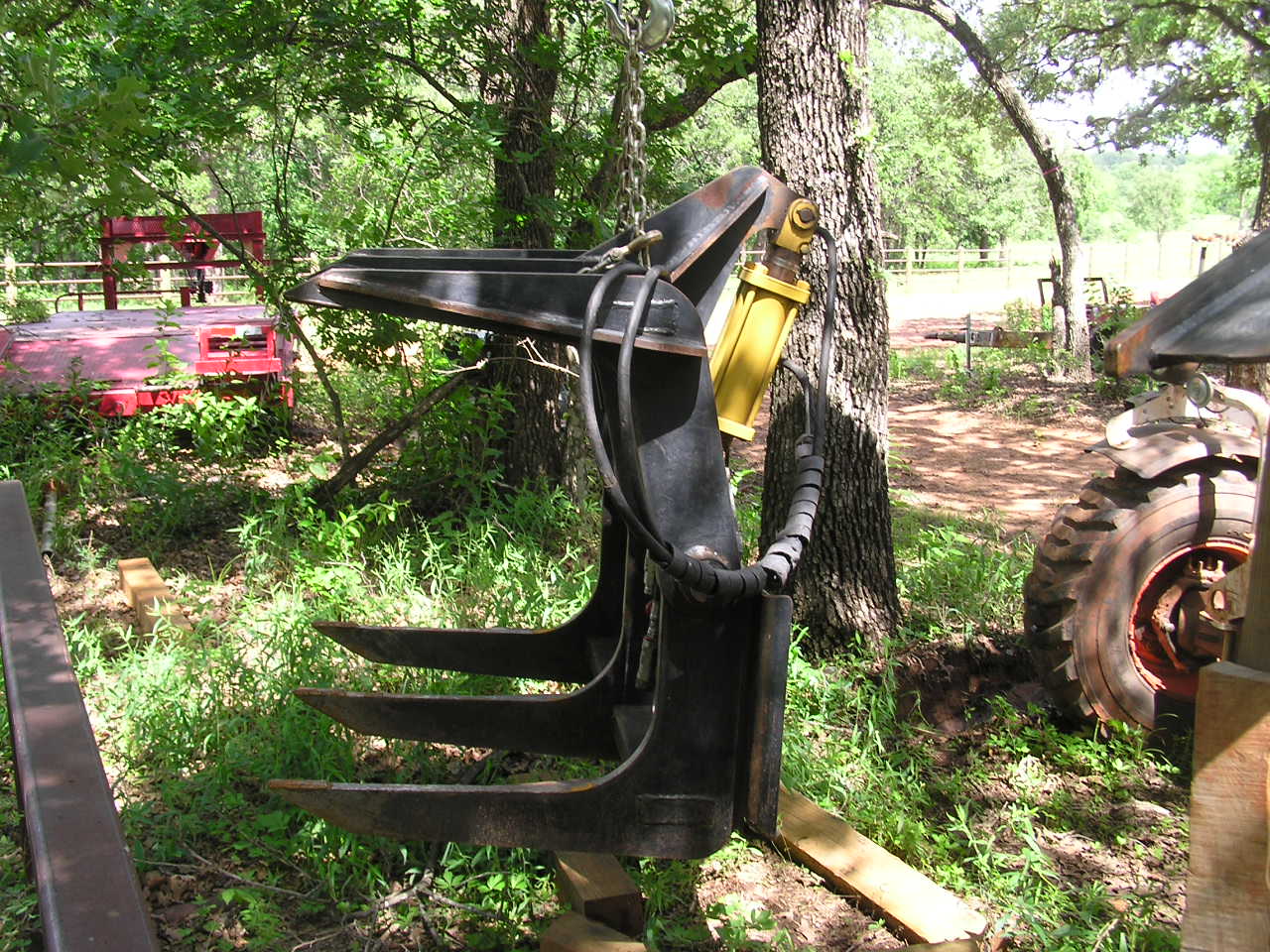

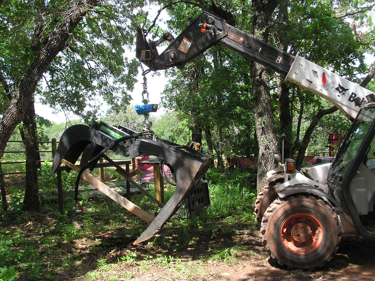

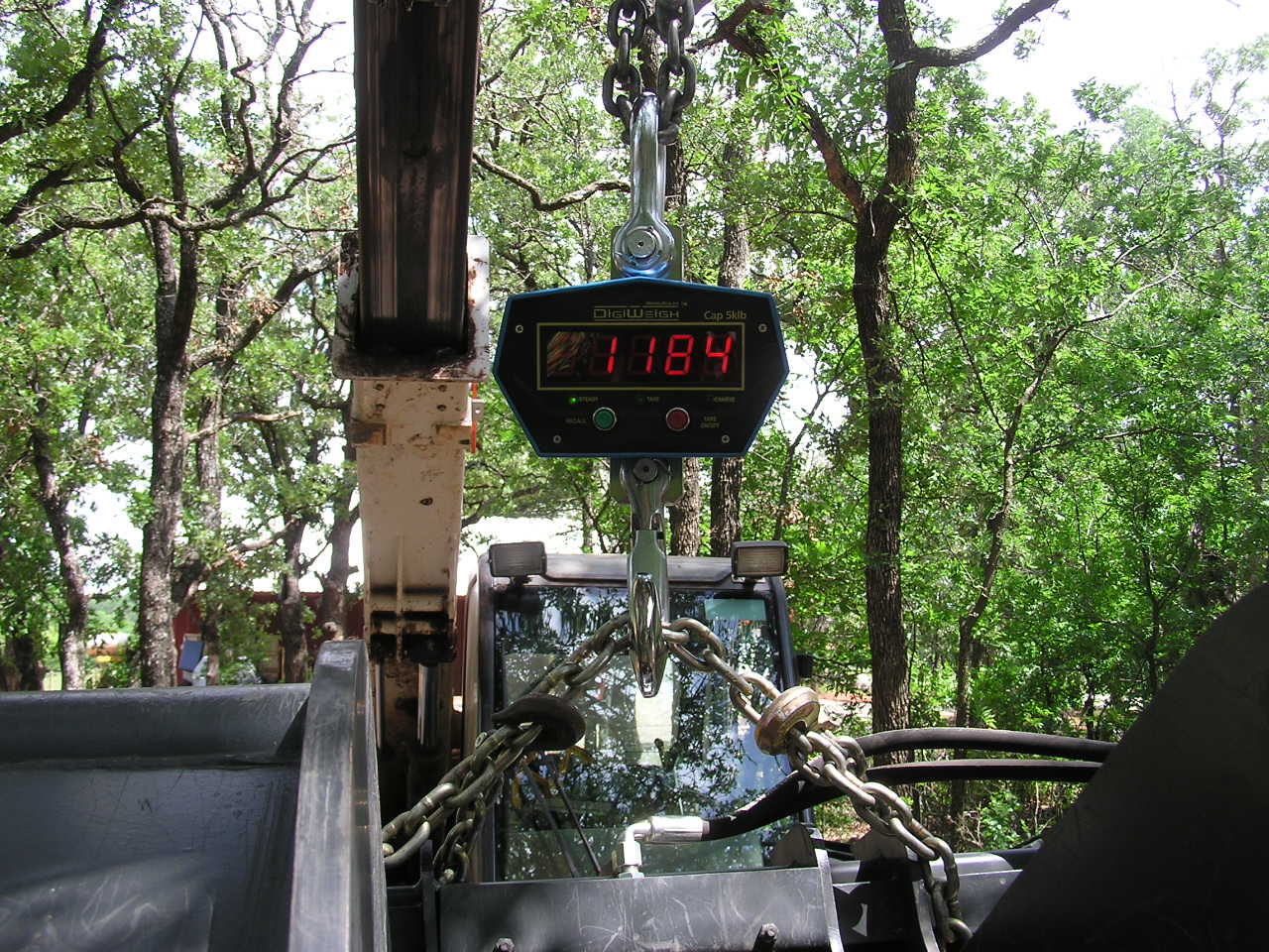

I am right here, but can only show you what mine weighs!
The Gorilla Grapple, 946 pounds.
The Monster Grapple, 1,184 pounds.
