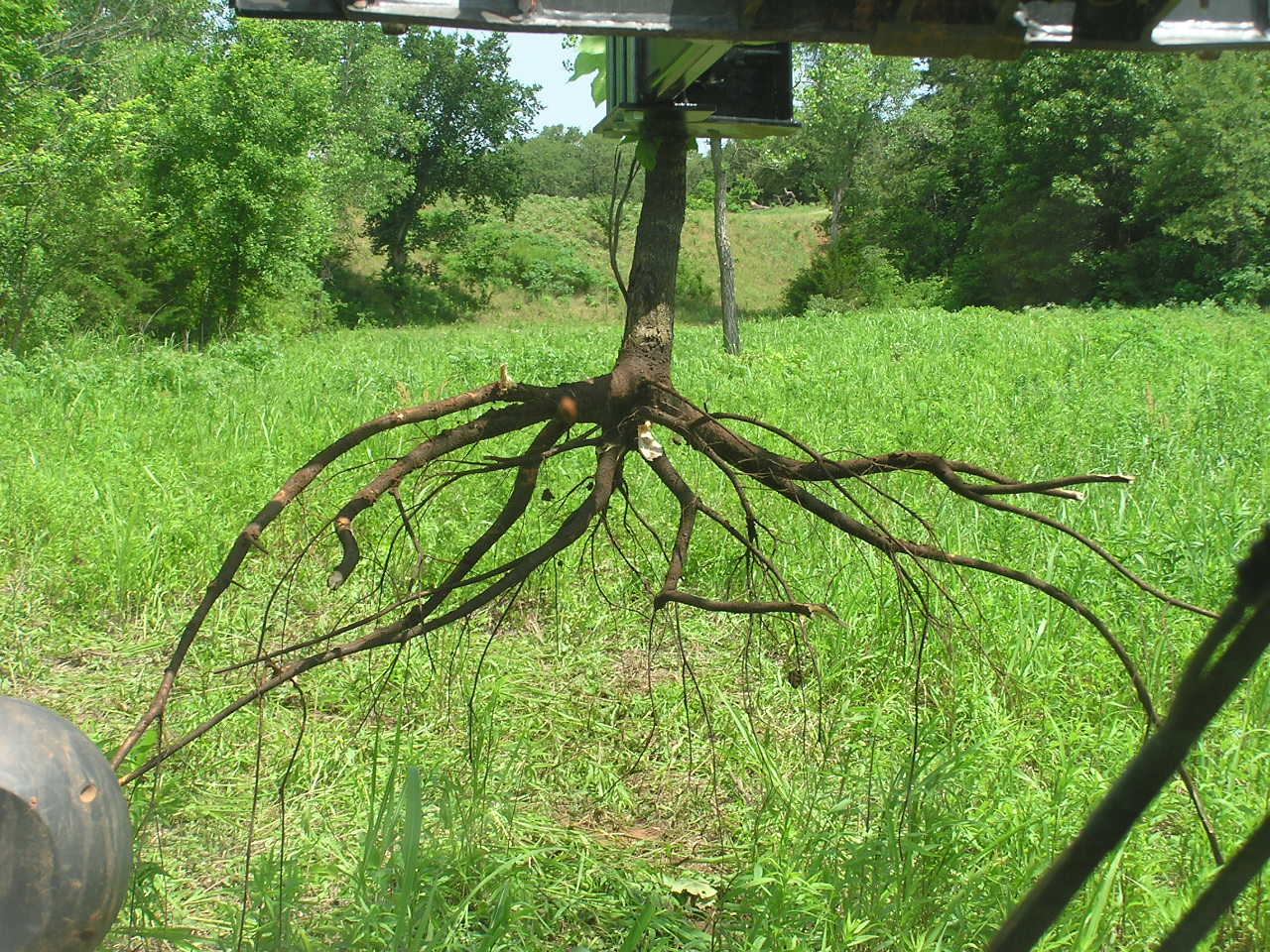

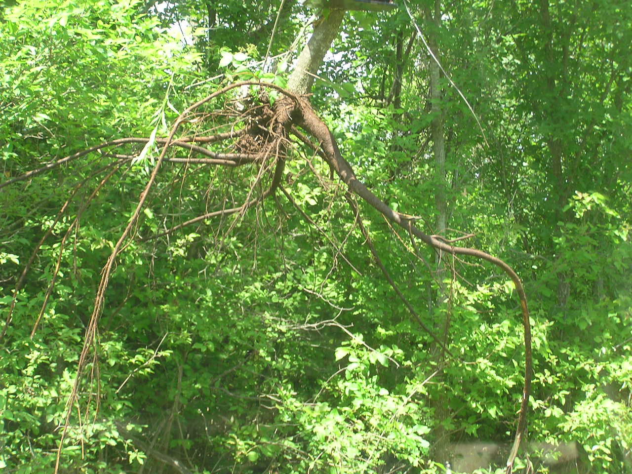

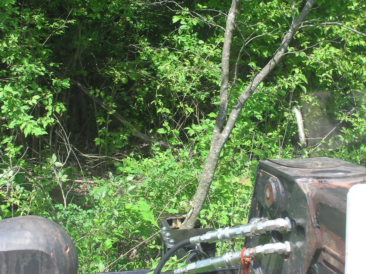

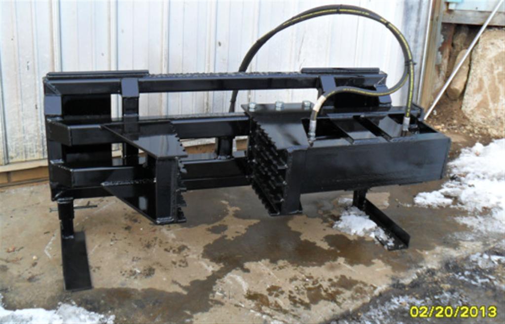

For trees 4" and under, a tree puller is the fastest way to clear them.
Clamp, pull and shake the dirt of of the roots. The view from the seat.
For a tractor this style would work better.
Click for more pictures, "the biggest cedar" http://www.tractorbynet.com/forums/attachments/277824-tree-puller.html#post3444397
