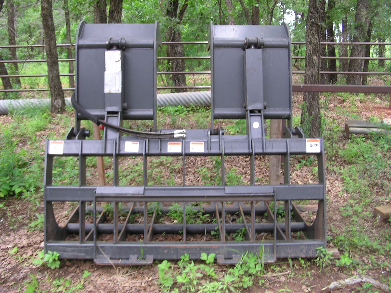

I have narrowed my search down to 4 different models the first three are from ebay and are Titan brand and would like some feedback.... on the quality
this model is really a good price and I was hoping someone can attest to the quality of the unit
48" Grapple Bucket Tractor Brush Root Kubota Mahindra Rake Skid Steer Bobcat | eBay
this option is reasonable but a bit more only reason for the option is due to the dual grapple arms
60
this option is on the list because it offers a bit more width at a reasonable price
60" Grapple Bucket Tractor Brush Kubota Mahindra Rake Skid Steer Bobcat Root | eBay
and this option is the one at RCO it is built pretty solid but he is firm on 1375.00 which is a little high compared to Titans.
Root Grapple Attachment - Light Duty - NAI
If the units are not on back order at the ebay store Im leaning toward the 48" mainly due to the cost savings... but I was hoping someone has the titan brand 48" and can give a review of their experience with it.... thanks
I have the 60" rake style Titan Grapple and a set of 42" Titan forks the quality is very good I have no complaints. I want to get another grapple an L style and the 4' Titan is on my list, I am also interested in the new EA 50" that they are making but the pricing isn't out yet so I will see. One thing about the Titan units is that they are very reasonable in price, I also like the flat faced couplings they come with, but they are heavy and every lb they weigh is less you can lift, but you have a lot more lifting capacity than I do so that may not matter to you.
Edit:
Almost forgot go here
48" LW Root Grapple Bucket $920.00 | Grapple Bucket Attachments | 48" LW Grapple Bucket | palletforks.com
and you can read more about the Titans it is the same place. And I doubt if they are on backorder they are pretty good with inventory and shipping at least for me and several others I have heard about is great.

Any of those grapples you listed should get the job done. But, for any of them I'd look at welding some heavy wire mesh on the front or back of the mounting plate to keep brush from poking through and getting to your tractor's grill.
Wire mesh would provide protection but still give you plenty of visibility through it.

I would make sure that a light duty grapple had 3/8" tines (or 1/4 high strength), 1/4" thick top tube, max 9" intertine distance, ideally jaw opening over 40". Nothing else really matters that much. My ideal right now for a 40+hp tractor would be a modified EA light duty style with 3/8" tines, 46" jaw opening. Of note, the grapple in my avatar is no longer made but other than changing the upper jaw to the EA style and adding the EA type extra removable tines it is pretty much perfect.
/ Need help deciding on a grapple #107
I had 1/2" tines on the one in Texas, and that's what I'll do again.
The mesh idea on the back of the grapple is a good idea. I'll probably do that, however, I had a lot more trouble of stuff getting into the grill when pushing stuff with the bucket. Once I got the grapple, I can't recall it happen during it's use.
/ Need help deciding on a grapple #108
/ Need help deciding on a grapple #109
I just don't see the need for one to open wider than this:
If it opened wider, the lid would have to be taller and the bottom tines would have to extend out further from the tractor, which would extend the tractor's center of gravity and lessen the lift capacity.
This would be a disadvantage, especially when pinching logs or heavy debris with a small compact tractor.......maybe not so much with a larger tractor.
Look at my pics, walkway grating. Hard to bend and tough. Screen or expanded metal it not strong enough. CJ
View attachment 343884View attachment 343885View attachment 343886View attachment 343887
With more opening it gets the tines away from your head when loading the grapple by hand. [see pics] Wich I do with firewood and to be able to grab larger objects like a stump. The stumps are the biggest problem, I know you don't mess with stuff like that with most compacts but as you know the Kioti has very good lift capacity and I use mine alot for this. I was told by the gent I talked to yesterday you had/have a DK40 so you know what it will pick. With a skidsteer grapple that is in the 800-1k range I loose more lift than I want. As far as the width of the grapple, when digging trees out the wider grapples put too much stress on the loader when popping roots with the edge, even the bucket IMHO is too wide to grub roots with. So after renting a wide one I guess I am the first one to admit it was too wide for my needs. CJ
<img src="http://www.tractorbynet.com/forums/attachment.php?attachmentid=343884"/><img src="http://www.tractorbynet.com/forums/attachment.php?attachmentid=343885"/><img src="http://www.tractorbynet.com/forums/attachment.php?attachmentid=343886"/><img src="http://www.tractorbynet.com/forums/attachment.php?attachmentid=343887"/>
Good points but lift capacity would only be an issue for smaller tractors. A bigger version of your Light Duty for 40+HP CUTs would not suffer. My 48 Millonzi has a 46" opening which is useful for collecting brush and also for big stumps. Maybe use 3/8 mild or high strength steel but keep the single wide lid and the removable slats.
I agree with you for a tractor like the small 22 HP 1400 lb lift unit that you show. You make a good point at the end, larger tractors may be able to take advantage of the larger opening while staying with the narrower grapple.
To me this "which is the best grapple?" question is kind of like asking "which is the best bucket for my excavator?". My answer to the excavator question would be "it depends what you are wanting to do with it".
Narrow L bottoms have an advantage of maximum lift per lb of grapple weight and per dollar spent. And of best digging ability for small to medium machines.
Wide L bottom grapples have an advantage of maximum total volume capacity and maximum cleanup swath. Think storm cleanup or post dozer cleanup.
Rake grapples have an advantage of forward and back raking, with better root grubbing ability.
So my answer to the question about which is the best grapple would be "it depends what you are wanting to do with it".

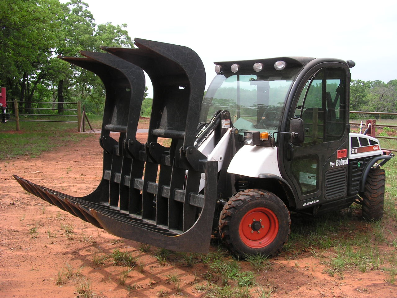

I just don't see the need for one to open wider than this: I do, brush isn't very heavy, if it will grab more, it takes less time to move it.
Not true, there is another way to make a wider opening, keeping the same bottom tine length.
Raise the pivot point and extend the top tines back down to the lower tines.
Notice how much higher above the SSQA, the top lid pivot rod is, compared to yours.
Show this to your design engineer for the next heavy duty wicked big mouth grapple! :D :thumbsup:
That setup is so bad asss looking. Very nice. Always impressed with your grapples.
