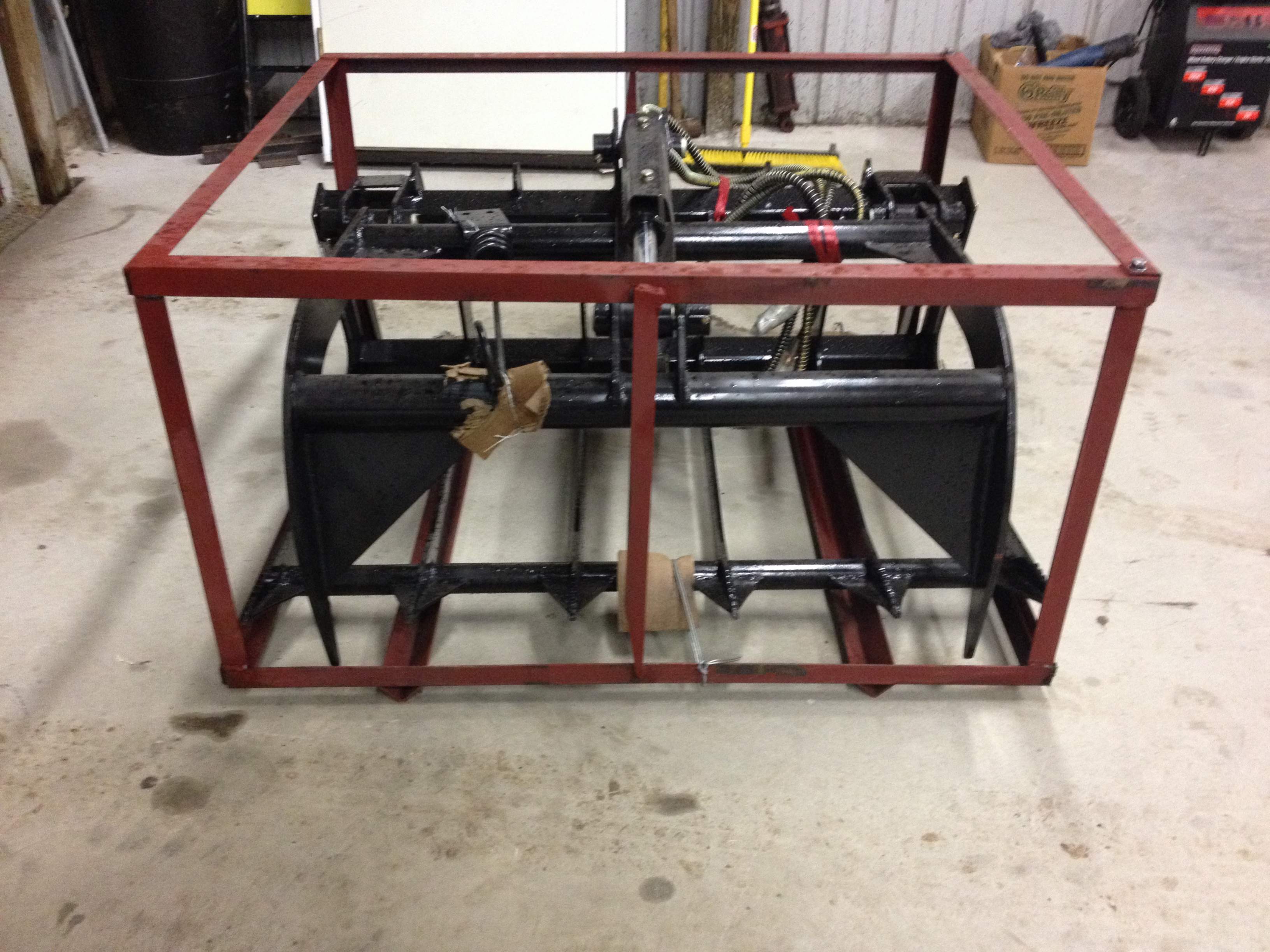

Well I ordered a 66 wicked that should be here soon. I have a bunch of pics of the tractor and will have abunch of the grapple in use as soon I can find the **** cord for the camera

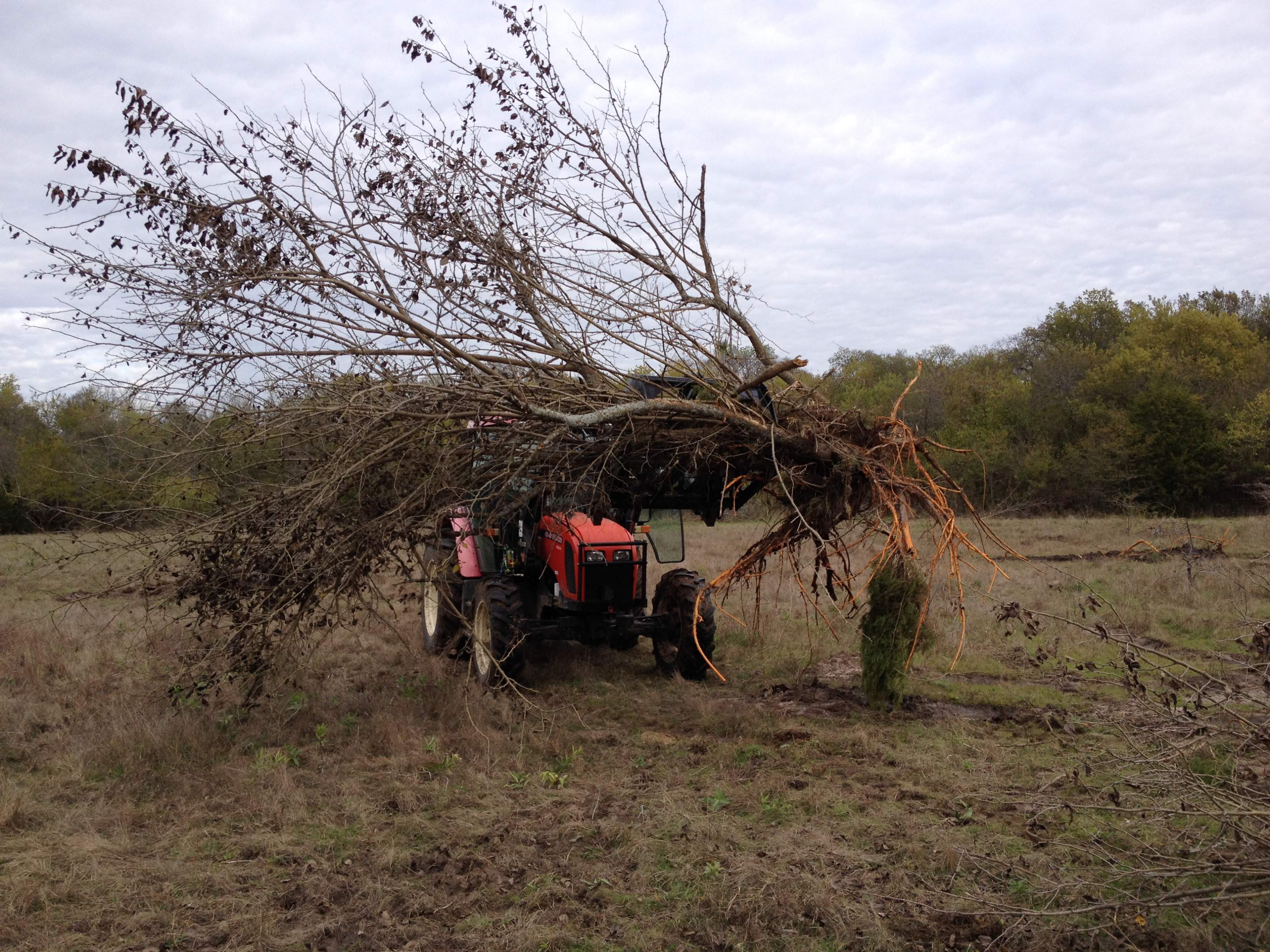

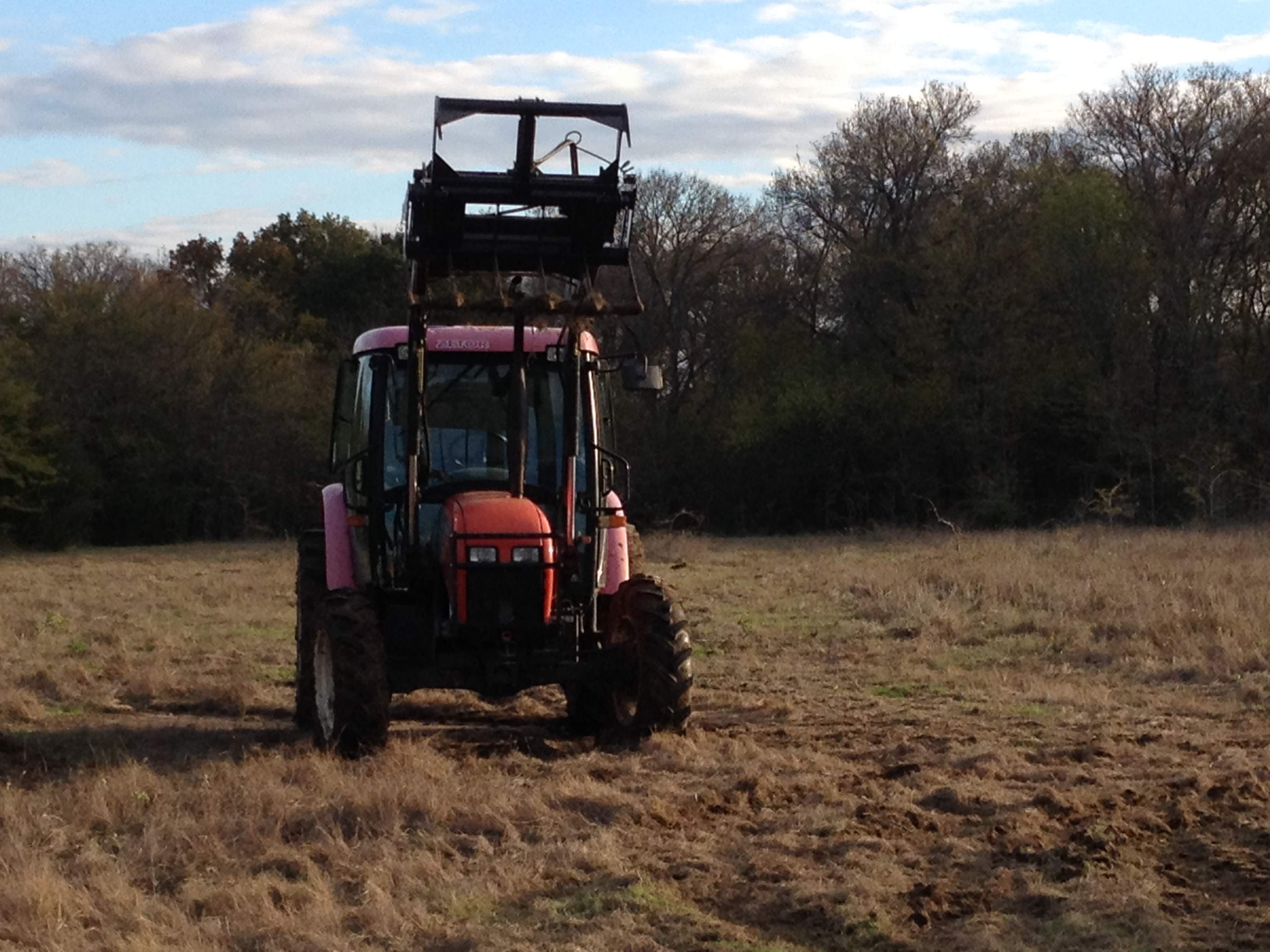

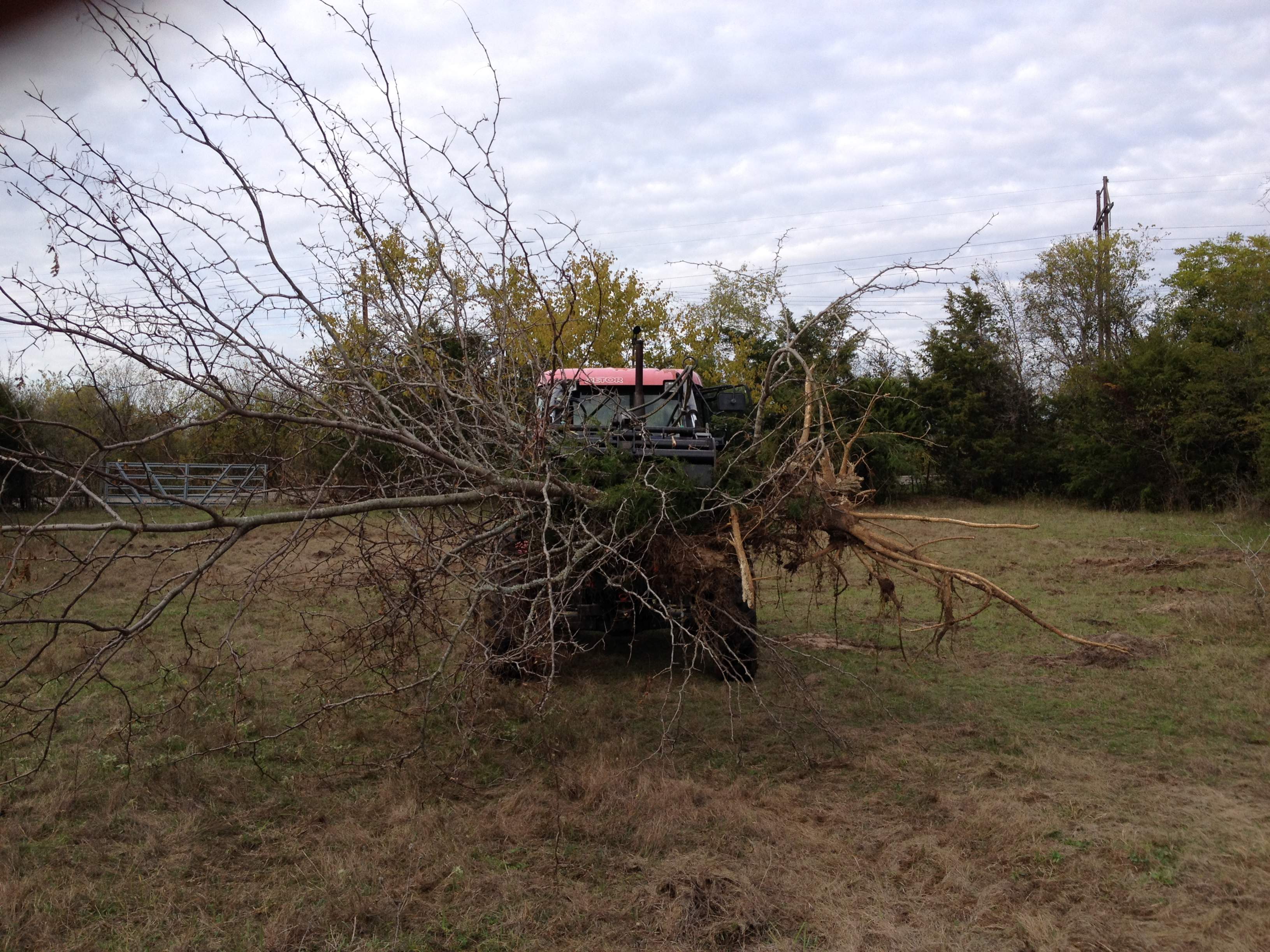

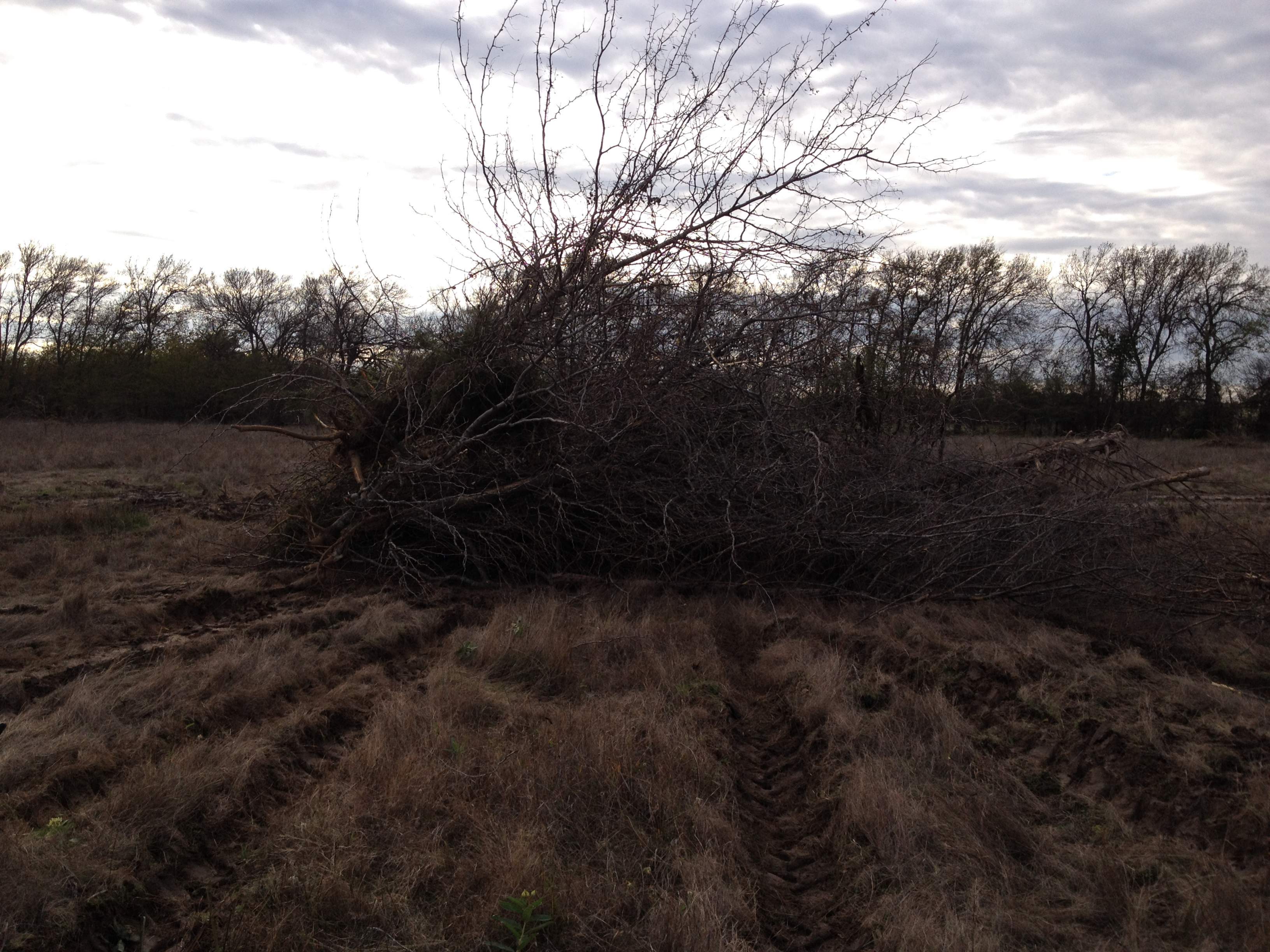

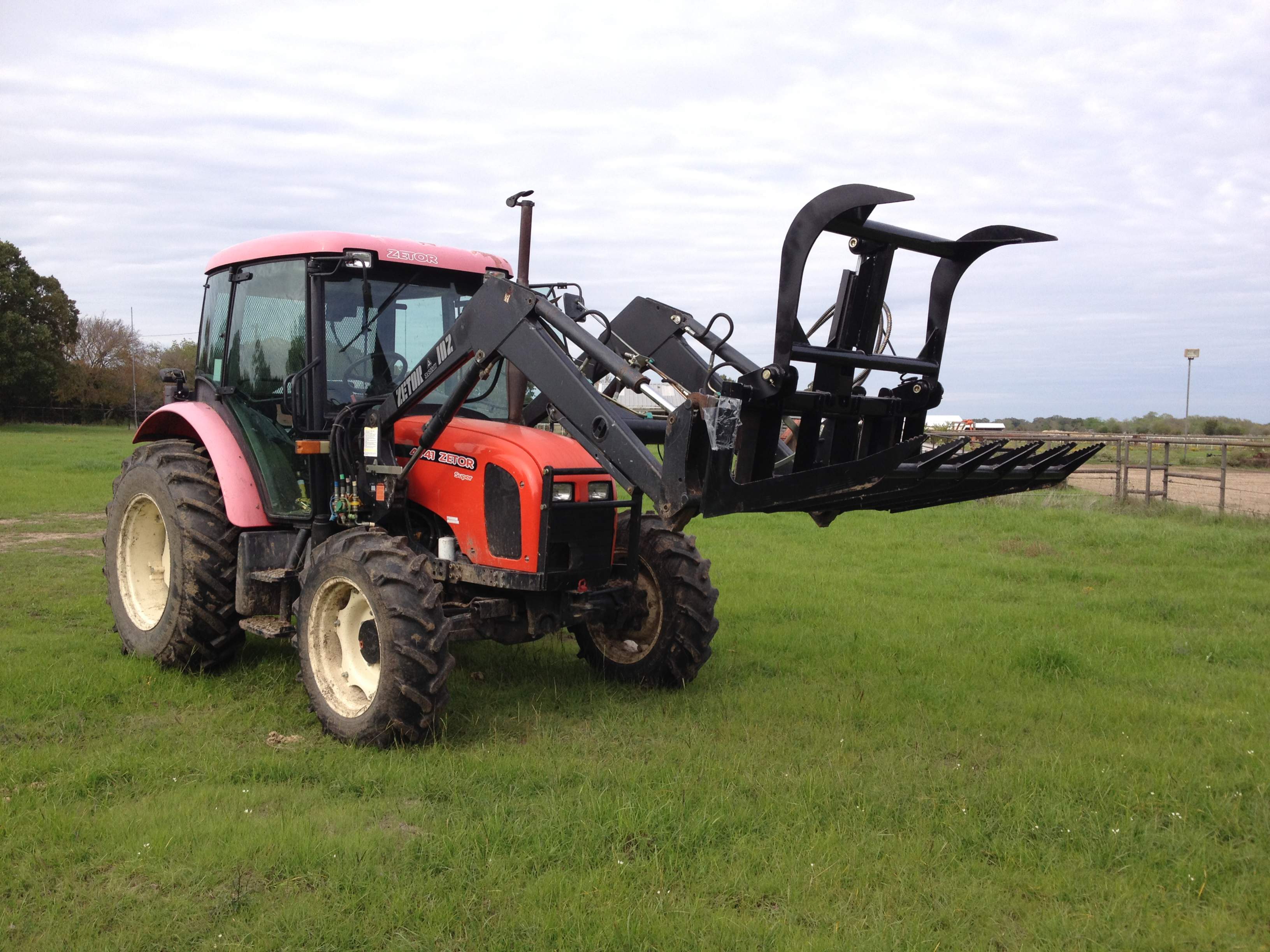

Here's a few action shots as promised... I cant believe I waited so long to get a grapple, they sure are useful once you get the hang of it!! I built a SSQA adapter to work with my Euro QA with universal SS conversion plates from Titan....it turned out to be a little too light duty for my needs so Im in the process of building a HD model to keep on it permanently. Im building my new SSQA based off the design of mwb(Mike) from TBN. I should be done with the new SSQA in a few days Ill try to post pics of it when its complete. I will also post a few before and after pics of my land clearing project once I get it all cleared and piled up. As you can see from my last pic it was a little to wet out to be moving brush around so I wasnt able to push my brush pile as tight as I would like without making pretty severe ruts. I look forward to finishing this field next week! Thanks again to everyone.
