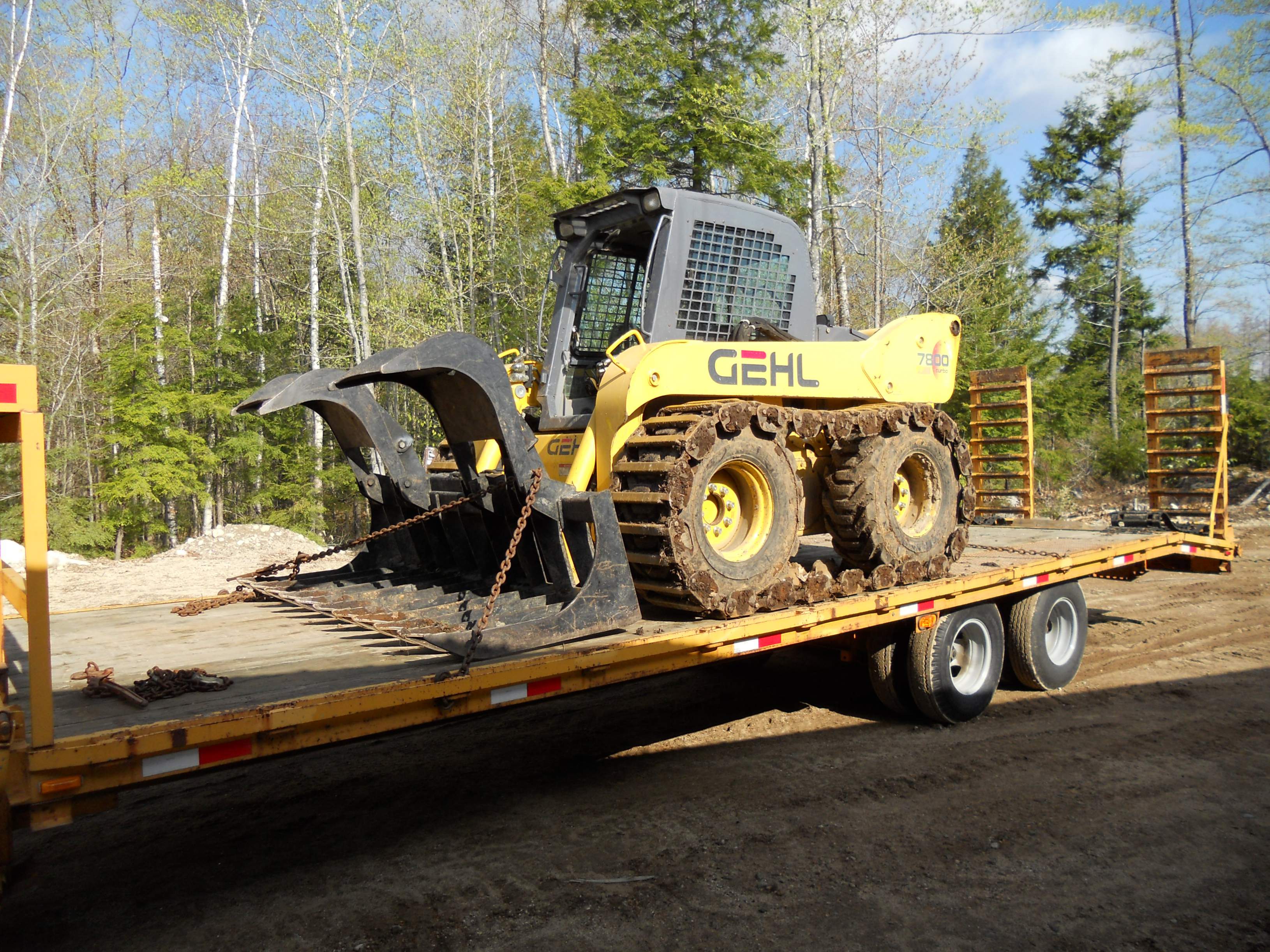

I was using my grapple yesterday and got this huge pick. I don't know if I would grab so much at once with a brand new tractor, but I had a lot to get done. I used an older 60 HP backhoe tractor non cab on this one. That's no little BX under there. I had to climb out of the load to snap this picture.
I have a bunch of pictures like that too. I'm always amazed when people question the ability of a 48" grapple to grab a big load of brush. My problem is usually that I cannot see where I am going with a full load and have to raise it up so I can peak underneath to see my way.
Actually that happened to be my 74" L bottom with a 46" opening and dual lids. It can grab a little more, but mainly I like it when I am clearing a swath. Interestingly, I use the lightweight 48" L bottom with single lid when I am picking up heavy loads or want accurate picks or digging. The load grabbing ability when grabbing brush is similar between the two L bottom grapples. Both are far superior to a Rake grapple for moving debris. The Rake is far superior when grubbing shallow roots. I think I have it all covered, but not as thoroughly as xfaxman. No one can compete with him.
