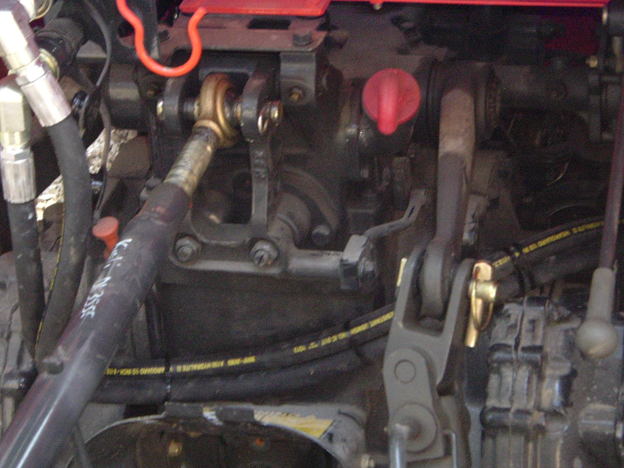

I still haven't ordered my hoses bc I cant decide on the size... you guys who ran 1/2" was it easy to route?? I know that 1/2" stuff is a less flexible than 3/8".... my pump puts out 11 gpm is it worth it to go ahead an run 1/2" for the possibility of running a PHD? It looks like the hoses leading to the rear remotes are 3/8" will I be doing any good if I upgrade my lines to the grapple to 1/2" when 3/8" is feeding the rear remotes? seems like the volume wouldn't change much but Im not sure.

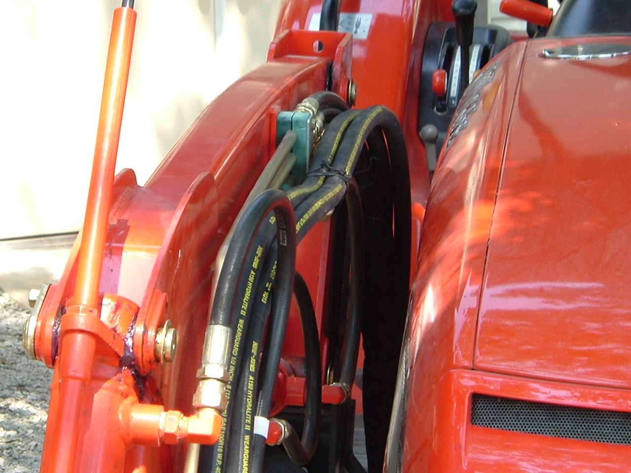

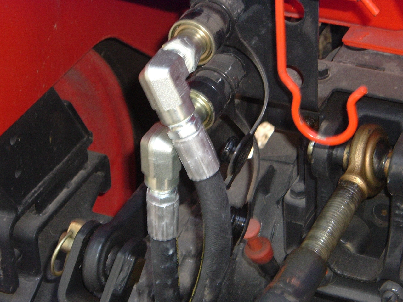

90 degree bends are the challenge with stiff hose like 1/2". The connection to the rear remote fitting can easily be done by including a simple 90 degree angle fitting right after the quick connect. The trickier bend is under the operator station when the hose needs to make an abrupt 90 degree change of direction to go up the FEL mount post. One solution would be to use two hoses with a 90 deg elbow right at that point. Some folks do it with quick connects at that point but that just adds expense if you are not removing the loader frequently. I don't think most of us remove the loader often enough to justify qc at that juncture. 3/8" hose is however flexible enough to make a reasonably sharp bend at the FEL post. Unless you plan to run a snowblower or hydraulic auger off the FEL I'd go with 3/8 as the best compromise between toughness and flexibility to run a grapple off the rear remote.
Well that's just it I will likely get a hydraulic PHD but I'm a little worried about routing 1/2" lines and making it look clean. Heck I could just buy 20' 1/2" lines when I buy the auger and just run them down the side loose just for the auger.

Yes I plan on purchasing the same model( I hope I can find a used one too) my FEL has 1/2" lines at the QD I could possibly do something similar to what you were planning on doing... How long if hoses does the PHD come with? I suppose the simplest option is just go with 1/2" and be done with it... My batwing has a 1/2" hose on it ( don't know why ) and it doesn't seem real easy to route.

You can't get more flow than what the remote will pass, so I guess maybe the long 1/2" hose would restrict it less than a long 3/8" hose.

According to the manual, it comes with 292" long hoses.
I just got off the phone with landpride, they said it will work with less than 1/2" but not ideal. He said even if you have 3/8" going to your valve, 1/2" hoses will still work better than 3/8".

I ran 1/2 inch on my tractor, some of the bends were challenging. For my size tractor and flow rate 10GPM. I would probably do 3/8 if I did it again. For your size tractor (larger) and slightly higher flow rate, I would probably do the 1/2. There is not a huge difference in cost.
